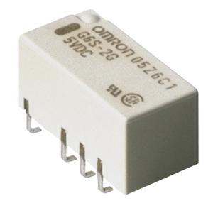

feedback on these relays?
I managed to find a few of these Omron GS6-2F DC5V relays. Can anybody say anything good or bad on their behalf as used in a preamp for volume control functions and as input source selection functions?
For those that want to see the specs
Thanks! 😉
mlloyd1
p.s. The leads on mine actually bow out away from the relay body, making DIY soldering a little easier 🙂
Thanks! 😉
mlloyd1
