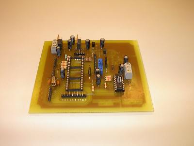

So I made some pdfs. They should be in original size.
I zipped all of them in one file.
It´s the pcb from the components side with the overlays and parts list.
Info on programmimg the PIC you can find on Till´s website here:
http://home.tu-clausthal.de/~tpa/relais/index.html
Please note I am using another resistor system as Till is. Don´t mix the 2 up. Everything works the same but the attenuator is totaly different.

Hello promitheus & till,
Looking at the schematics for the microprocessor part, I think we can use just 1 rotary encoder for 2 balanced channel (L + R balanced, that is for 2 relay boards, we use only 1 rotary encoder connected in parallel). Is that right?
Promitheus, could you kindly made the pdf file again? I think you missed to print the holes. There's no holes in your pdf files. Btw, very nice boards!

You can use as many relay boards as you want with the same data bus.
You can use 3 relay boards for a surround system with a 6 channel volume control.
You can calculate any Load resistor value you want. for instance a 6 X 47Kohm volume control.
I will be using 2 boards for balanced volume control.
a 4 x 5 Kohm volume control.

As Promitheus sayed, the digital part with the PIC is able to drive a serios amount of driver transistors. So you simply hook up as many relay boards in parallel to the PIC as you need. The rotary encoder also could make use of a pushbutton function, if you want for mute, or for a change between 2 sources.
The 16F877 controller with LCD i work on will be able to read 2 encoders for more funktions.
