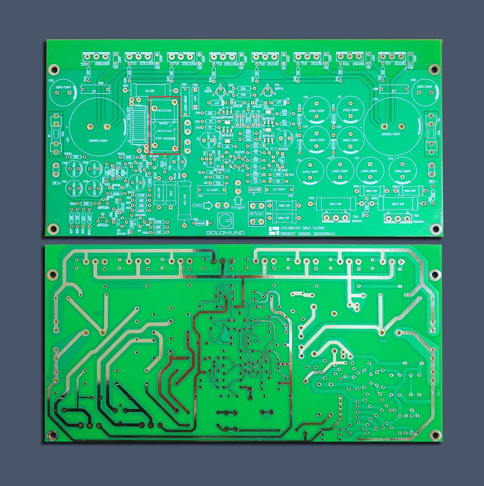

fuego Member Joined 2015 2023-01-14 4:13 pm #1 2023-01-14 4:13 pm #1 Relay: PCF-1224D2M Does anyone know where I can find this type of relay or a replacement? Attachments goldmund1.jpg 517.1 KB · Views: 117 VivaVee Member Joined 2004 2023-01-14 9:11 pm #2 2023-01-14 9:11 pm #2 The reason you can't find the part number is because it is wrong. This is an OEG PCF-124D2M now 'made' by TE Connectivity. It is going obsolete so get your parts asap. Currently available ex-stock from Digikey as PB1409-ND Reactions: fuego You must log in or register to reply here.
