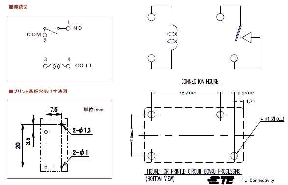

Hi. I have a DEC DLS1U relay here that is defect, and I need some help here to make sure I buy a new correct relay equal to DEC DLS1U. Yamaha part# WQ804100. It's for turning on/off voltage to transformer in a Yamaha RX-V receiver.
The spesifications I have found of DEC DLS1U is:
250VAC ~
Contact arrangement SPST-NO 1A
TV-8
5VDC Coil Voltage
0,25W
50mA Coil Current
100ohm Coil Resistance
5A/100A
3A/120A
I have not found any information if this is a latching or non-latching relay. A relay that seems to be really close to this one (except I don't know if I need latching or not) is this: LKQ1AF-5V-TV-5 Panasonic Electric Works | Relays | DigiKey
Anyone knows?

It's got just 4 legs; you can cobble the connections.
Single pole single throw normally open (1 form A)
5 Amp contact
5V 50mA coil.
The coil legs are in line; the contact legs are offset.
But go to Mouser.com and look up these numbers:
655-1461492-2 1461492-2
TE Connectivity / OEG General Purpose Relays OJT-SS-105LM 000
806 In Stock
$2.02
This is less long. Extend the legs with scraps of wire.
