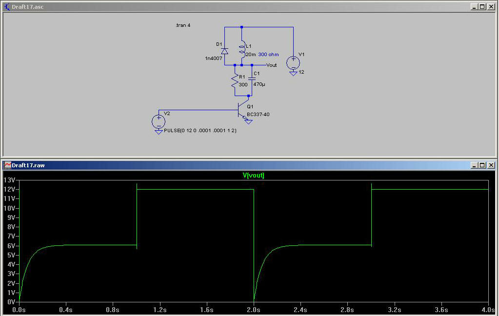

Relay driver with holding current
Hi
I have used a coil with R=300Ohm (approximately) and inserted a series resistor of 560R, and tried a few caps. Here are pics with 470uF and 100uF - oscilloscope probe on the coil (working off battery so not earthed). Resistor divider now feeds 1.6mA to base.
Edit: on initial power up, the relay remains in the off position because there is no time to charge up the cap and create the spike that is needed. That is a problem that needs to be solved.
In the first post you said you want a holding voltage of about 5 to 8 V. Using a 560Ω in series with a 300Ω coil will give you closer to ~ 4 V across the coil. Try around 300Ω (270Ω, 330Ω). Also keep in mind that the voltage across the cap will be only the difference between the supply and holding voltage (roughly 6 V), so although it may "high" in capacitance, it can be a low voltage rating, so it can still be a physically small part. I have frequently used this R//C trick for relays without issue. It is simple and it works, you just need to tune the values to your particular relay.
Just put the cap and the resistor on the other side of the relay so you won’t have to wait for the capacitor to charge.
