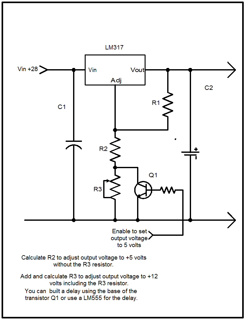

Attached it is a schematic of a circuit that allow you to do what are you looking for. You can doing it using a voltage regulator as the LM317 with 2 resistors. What you do it is using two resistor to adjust the voltage output one for 5 volt and the second one for the 12 volt. To energize the relay you set the voltage to 12 volt and to drop to 5 volt you short the R3 to drop the voltage to 5 volt. You can use an LM555 to set the delay or use a resistor and cap for the delay. Sorry but I am not technical writer. Hoped you understand the principle.

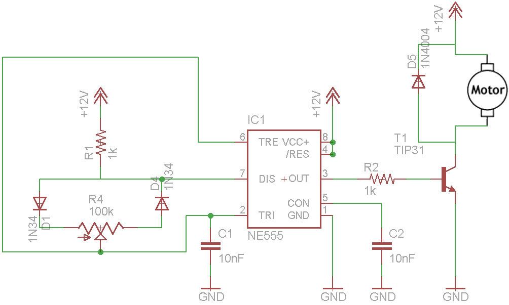

A LM555 can drive a relay coil with 100 mA, use FET or bipolar if more current is needed. Use a power up RC delay or a push button to start with the PW at 100%, then set the pulse width to hold the relay on.
Here are some PWM relay drivers.
http://www.ichaus.de/upload/pdf/Je_f1e.pdf
http://www.ti.com/lit/ds/symlink/drv120.pdf

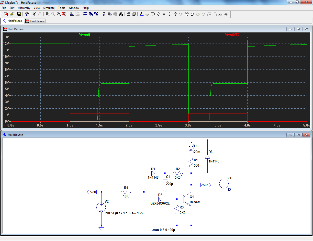

I have a (battery) circuit that switches on a relay after a delay, using a PIC micro. I have a spare pin on the PIC. It's a 5V relay with a low enough current to run off a PIC pin.
I can turn on the relay with one pin, then hold it on with a second pin, dropping some voltage using a diode or two, maybe a LED, then turn off the first pin. This will save a bit of current.

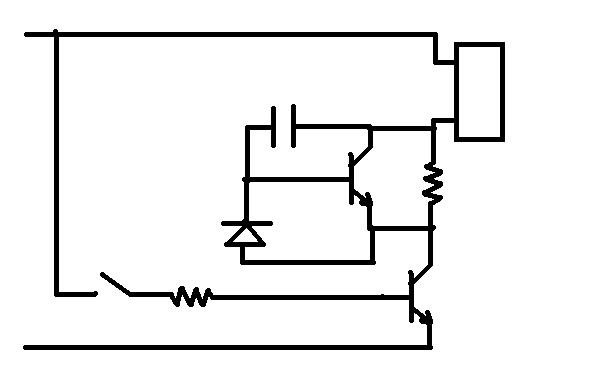

"...thought that I should "multiply" the capacitor by using the transistor,..."
"...but I have not yet found a way to discharge the capacitor quickly..."
That would be the best idea...and put a reverse diode on the cap amplifying transistor's base-emitter junction. In the off state the cap will discharge through the diode and R3.
just to clarify, see jpg

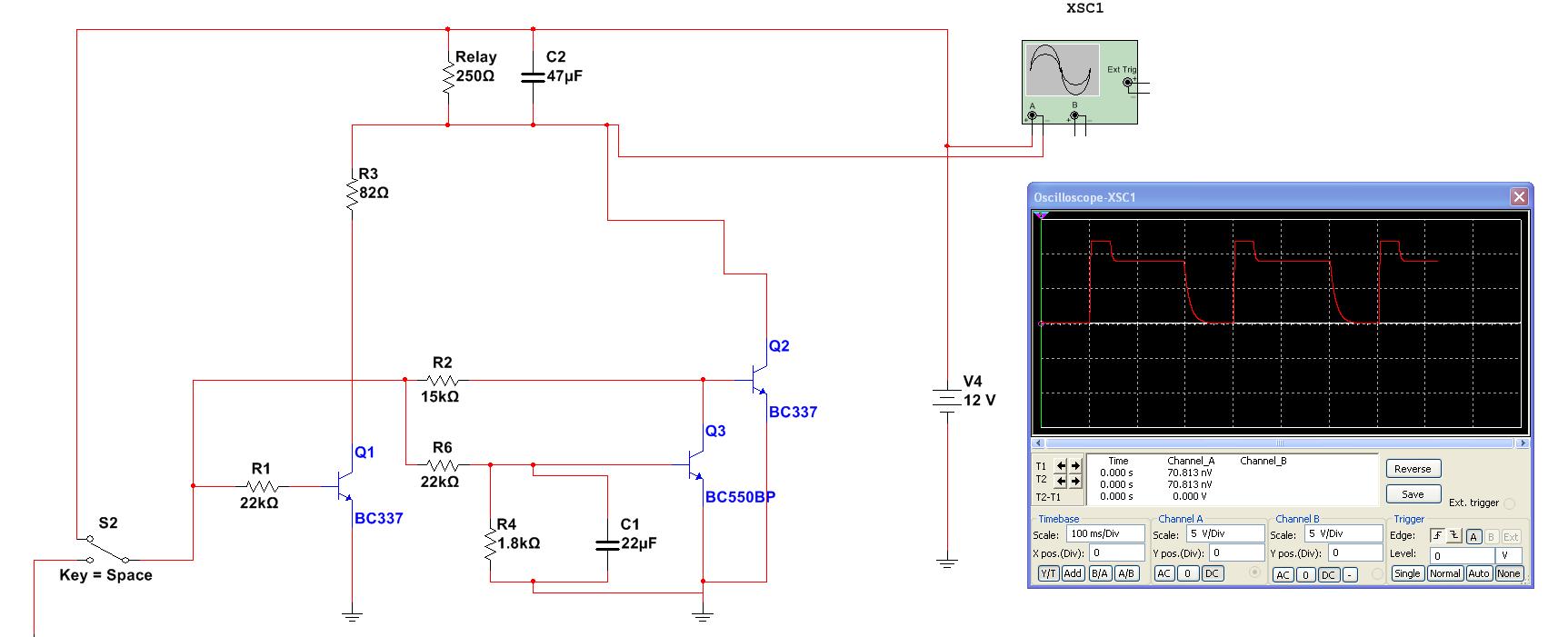

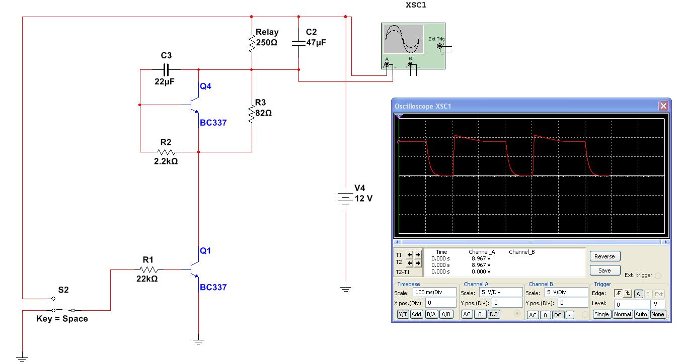

Here's what I have come up with so far. It does use a few extra components than the basic resistor transistor relay driver: an extra two transistors, four resistors and one capacitor.
When the signal is "on" then:
Q1/R3 sets the holding current.
Q2 provides the initial energising current.
Q3 and the RC combination C1/R4/R6 provide a small delay after which Q3 shorts the base of Q2 and thus stops it from conducting. R4 provides the necessary base current to Q3.
When the signal goes "low" then R4 serves to discharge C1, so the system gets "reset" when the cap is more or less empty.
On the scope with 100ms divisions, you can see the initial energising voltage, and after about 50ms the steady holding voltage. When the signal is off, it takes about 40ms to drop to 0.
This is all done on the simulator, I have not built it yet.
I think the next step might be to try using a 555 or find the PWM relay driver chips that someone mentioned before.

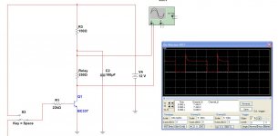

So these two applications don't require a high repetition rate. One resistor, one cap and one transistor (the switching element) does it all.
emf drives a series combination of dropping resistor + relay coil + C to E of transistor switch.
If you have a 12V coil of 300r and adopt a 300r dropping resistor then in the long term with CE closed the relay coil sees half the emf.
Now add a capacitor from E to top of coil.
when emf is first applied and CE is open the capacitor charges up via r and reaches ~2/3rds of final voltage in 1 RC time period.
Close the CE switch and the capacitor partially discharges to half emf through the relay coil. This fires (triggers) the relay. and the remaining half emf holds the relay active.
I usually use 15V from a 7815 to drive a 12V relay. R= coil the relay fires on ~14V and holds on ~7.5V. Cool running, fast ON and fast OFF.
All it "costs" is one 33uF 25V electrolytic.

Ahhh, that seems to work nicely. There is a problem reaching full energising voltage, and the drop out is very gradual rather than stepped, but it should work. Here it is.

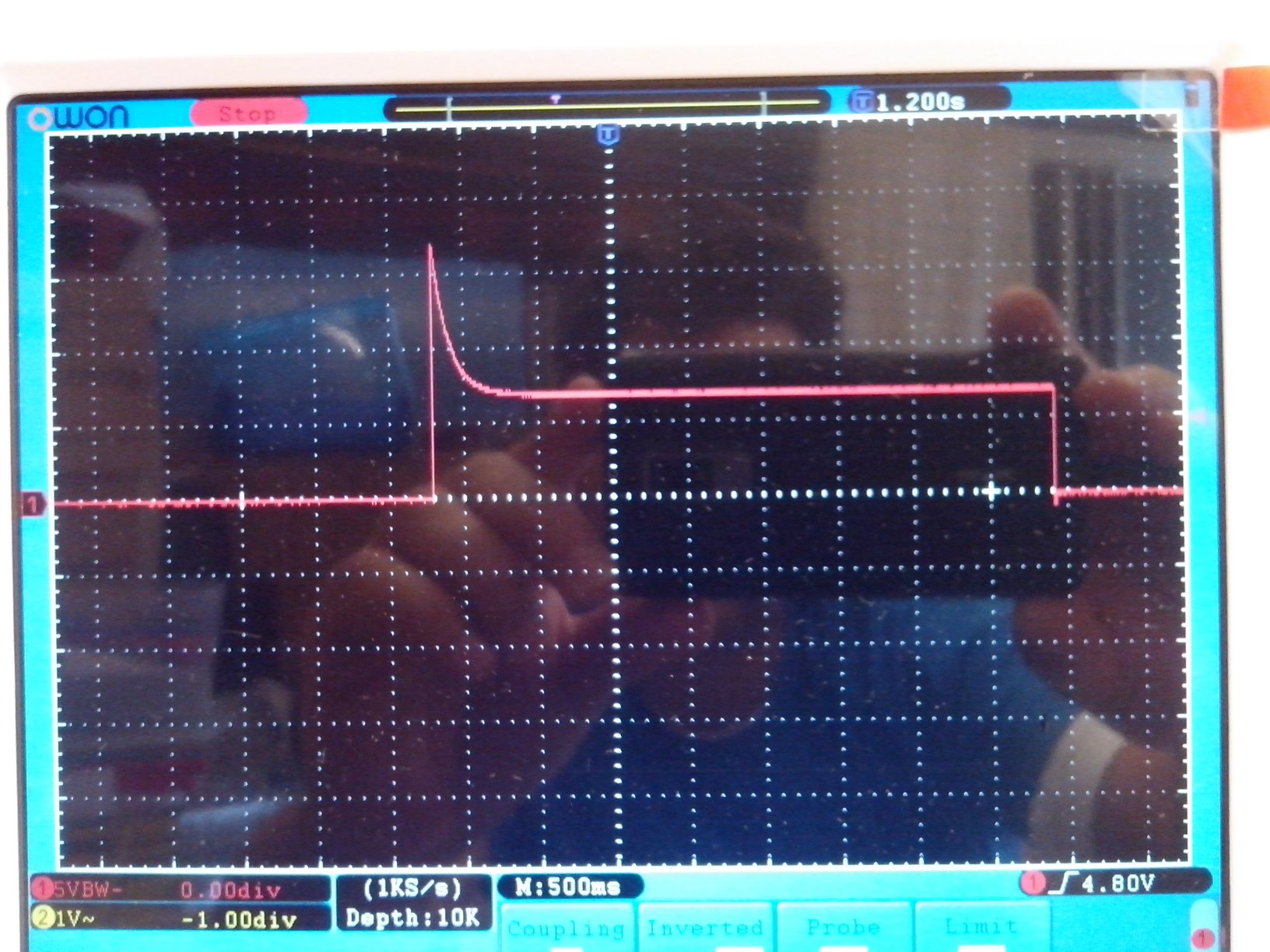

Here is how I understand your suggestion with realistic values - looks nice, and will definitely go and try it because it is the simplest. Only thng I am not sure about is the energising "spike" which I'd much rather it were a "energising plateau". But I will build it and test it in a minute.
The spike you are seeing is the charge held on the capacitor.
It cannot be higher than the emf you decide to adopt.
15V if your use a 3pin 7815 or 12V or rectified Ac.
It's that current spike that pulls in the relay a little faster if emf is >coil voltage. But don't worry about it. It works.
It also works with emf = coil voltage. The cap helps meet current draw when the transistor first switches ON.

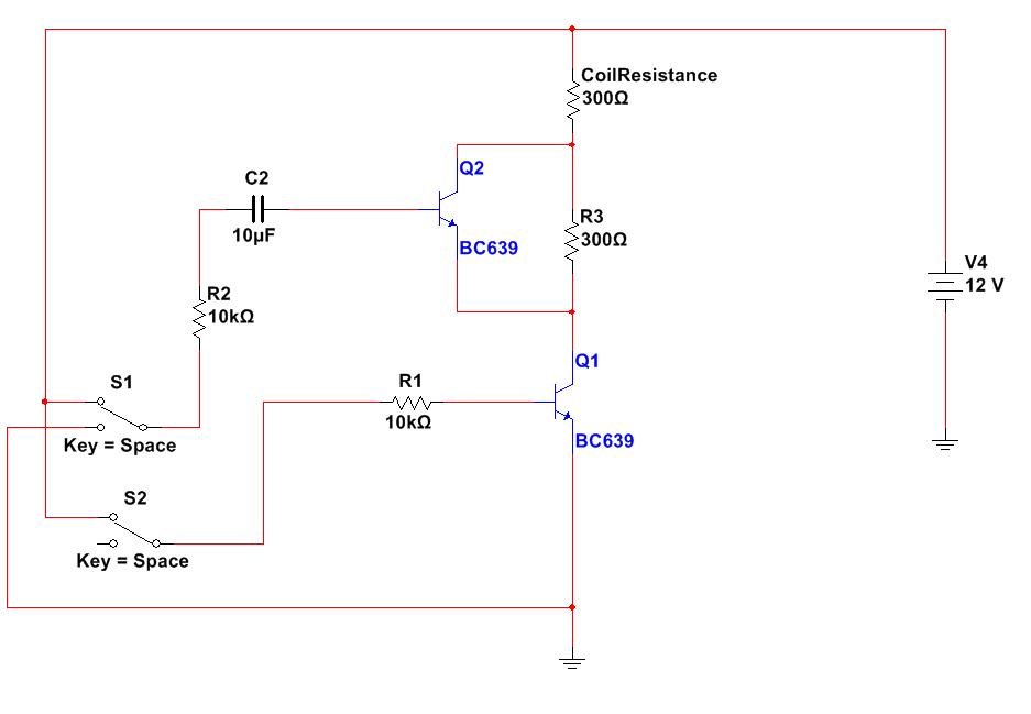

Hi
I have used a coil with R=300Ohm (approximately) and inserted a series resistor of 560R, and tried a few caps. Here are pics with 470uF and 100uF - oscilloscope probe on the coil (working off battery so not earthed). Resistor divider now feeds 1.6mA to base.
Edit: on initial power up, the relay remains in the off position because there is no time to charge up the cap and create the spike that is needed. That is a problem that needs to be solved.
