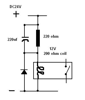

This is an easy solution to an easy circuit. I have run 5V relays from 12V sources plenty of times. I also like to slightly under-volt my relays to keep them living longer.
First thing to do is measure the DC resistance of the relay coil, to help you determine your resistor value needed! Since in your case you need half the supply voltage, use a resistor that closely matches your relay coil, to functionally divide the voltage. Slightly higher resistor is good if you want to run the relay cooler.
A method I like to use is a series resistor with a 220uf capacitor in parallel with it. This allows the relay to get a stronger magnetizing current at startup, then once the capacitor charges, the voltage drops across the resistor to run the relay at the desired lower value.

The solution with the series resistor works well but imagining that my power supply is 30v of example and not of 24v, will it be necessary to adjust other parts of the circuit or only the value of this resistance?

Make sure the voltage of the "startup" capacitor is higher than your power supply voltage.
Use a 35V or 50V part in this case.

The Startup capacitor provides the high pressure required to lock in the relay. Once it has closed, the holding current can be somewhat less and keep good contact.
