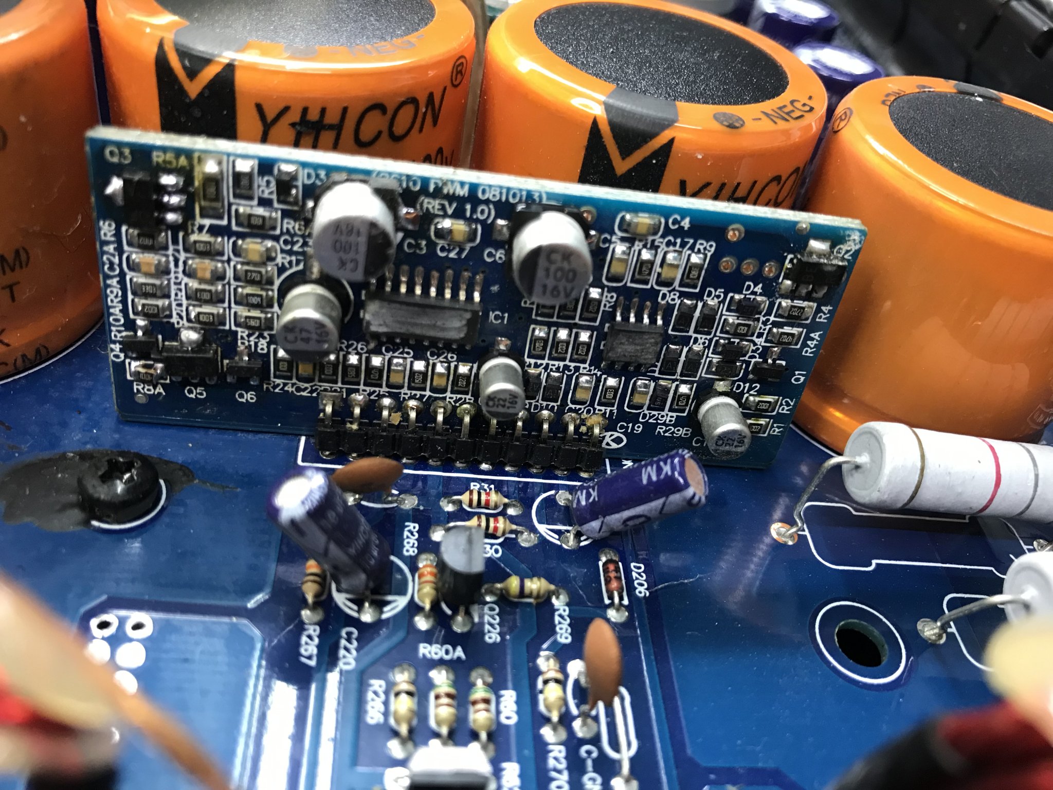

Relay circuit
The relay is not engaging.I swap Q5 and 6 from a next board but no change.If I ground pin 1 of Q5 it will engage.
Any suggestions?
Are you sure that you're grounding the base of Q5 to get the relay to engage?
The base of Q5 has to go high for the relay to engage. I think it's Q4 that pulls it high.
If there is a really high value resistor near Q3 at the top of the board, check it. It will likely have to be removed to confirm it's within tolerance.
