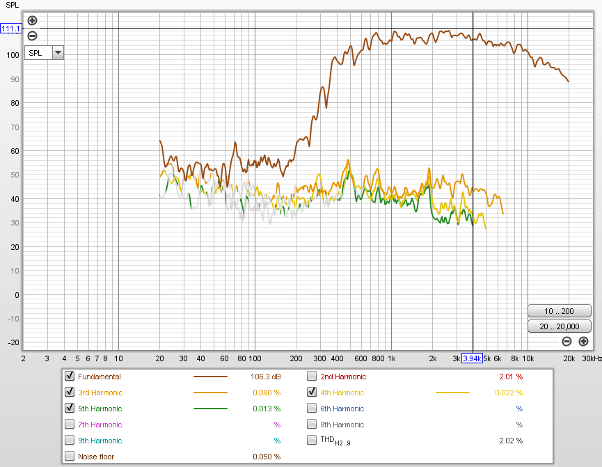

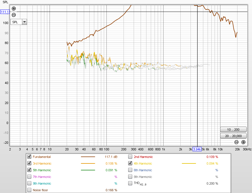

These distortion measurements are disappointing to you, but to me, it sounds very clear and nuetral, can you explain the difference in our experiences? You have used the Axi before and experienced and measured said Distortion? Can you show us how low the distortion should be in comparison to what the Axi is doing above? How low should distortion be.....these are taken at the horn mouth for intimacy of signal.
2nd HD is fairly benign, 3rd and 5th HD is much more audible and fatiguing.
Heres my 1 meter 1 watt....How low should we keep 3rd and 5th and how bad is mine!?! Can you feel my sarcasm yet?

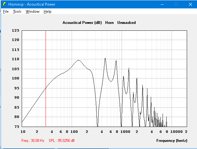

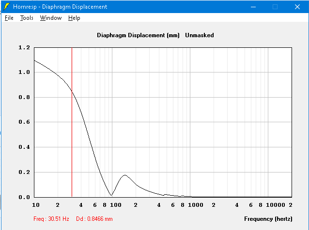

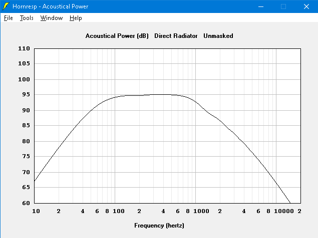

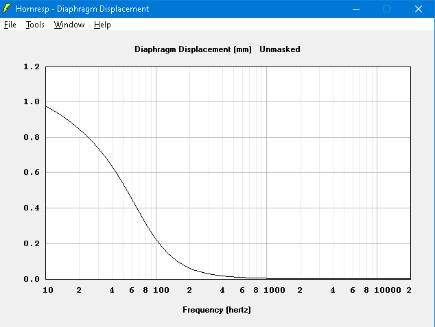

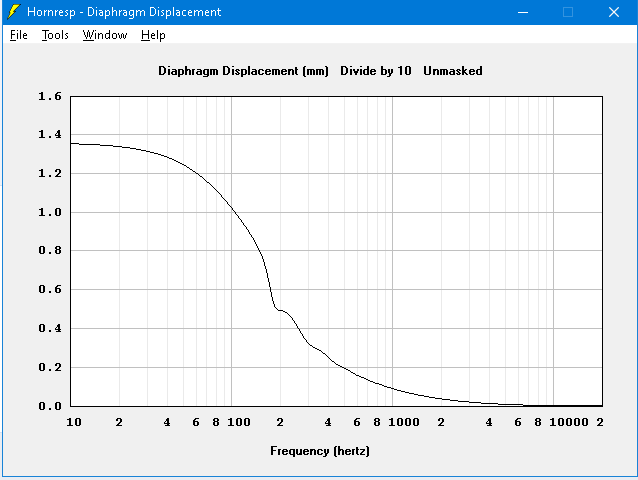

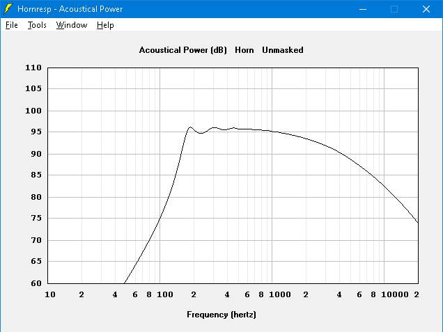

Crude 1 meter sims for the a 150hz horn...
Sims for the mod/basswoofer section matching spl.
And for the lower channel, Not teh finaly voicing showed so, look at 30hz, the highest cutoff desired...though it can be lowered....
They are sims, so trust what you will, but ballpark is the idea at sim level, and you can see that the general trend is extremely low excursion.
How can a 5-6way compete....in particular if the excursion cannot be made as low? I think 5-6 way can compete, and that it (can) achieve very low excursion as well...but I haven't modelled or attempted to design one to see what the route looks like...It would be interesting to see what type of accumulated Sd these 5 and 6 way systems are achieving per channel.....

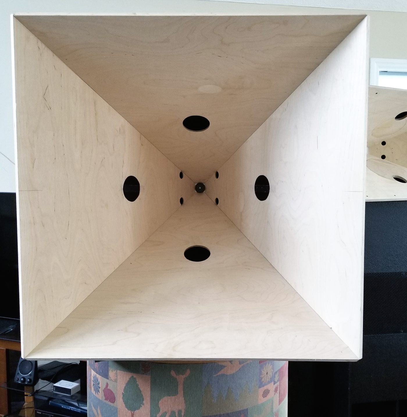

Like i said, i've made MEH's with symmetrical pattern control. Here's a rather recent 60x60.
I prefer the sound of asymmetrical patterns,...... 80 to 90 degrees H , with 50-60 degrees V.
