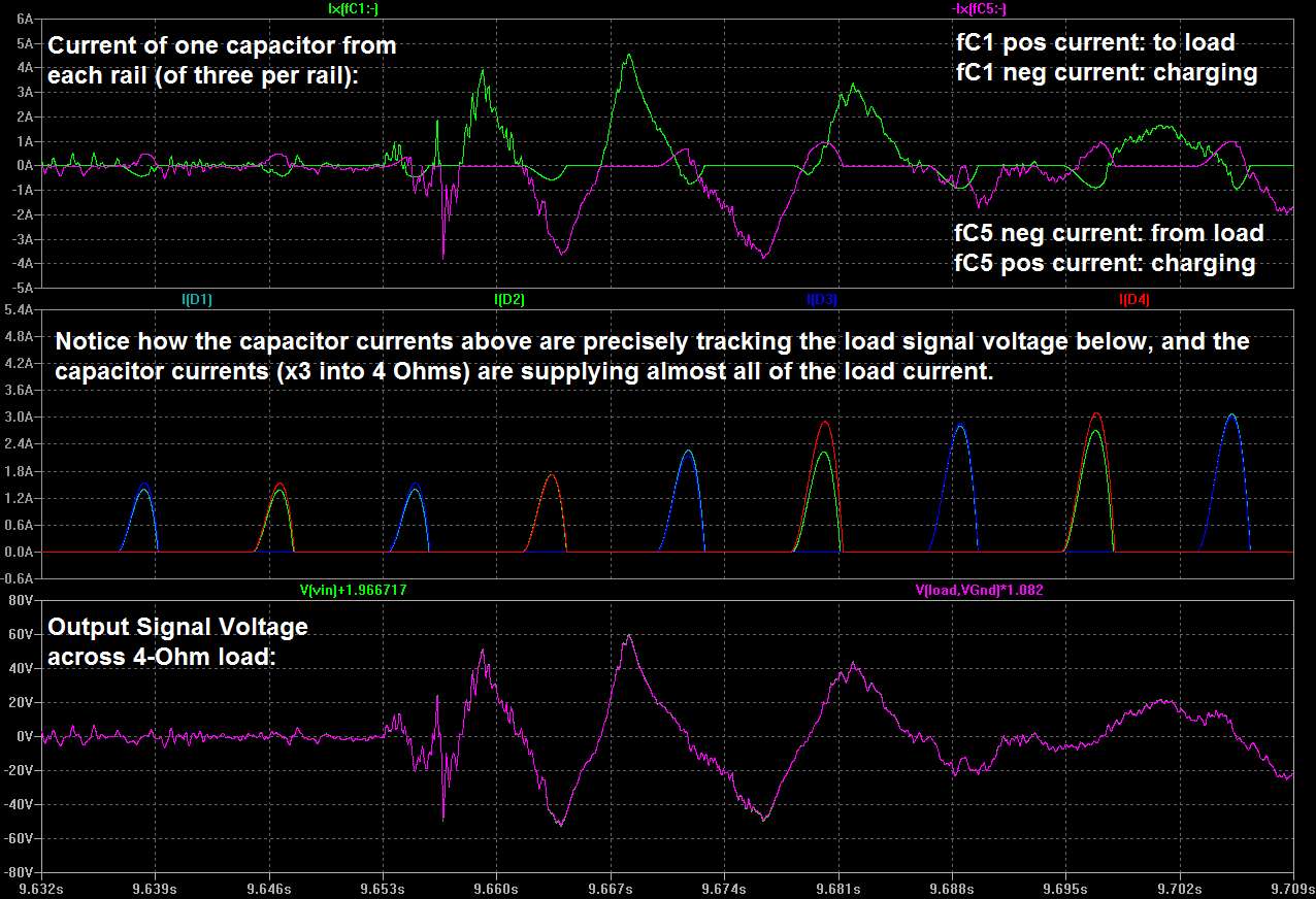

I completely agree with everything you've said. The following is really nothing but semantics. But what "makes the sound" could be thought of in more than one way.
When a layman sees an amplifier, the PSU is included in the term "amplifier". And after all, the two must work together, to make any sound.
But the fact remains that the sound we actually hear is rather-directly created by the PSU current (which is merely "modulated" by the amplifier). The PSU is providing the energy to make the sound. So in that sense, the PSU is making the sound, but under the control of the amplifier portion.
Also, the large majority of the current that makes the sound comes from the reservoir and decoupling caps. See the attached image from an LT-Spice simulation. This was discussed more-thoroughly around the post at http://www.diyaudio.com/forums/power-supplies/216409-power-supply-resevoir-size-38.html#post3117390 .
None of this makes much difference, except maybe in the way that people think about how an amplifier works. I have found it to be a useful construct to use in order to help clarify both my own and other people's understandings of how amplifiers work. (It's also sometimes amusing to use just to "tweak" certain electrolytic-hating people who pretend that "the signal path" does not include the PSU.)
I too do not see how, with a properly-engineered PSU, different makes or models of reservoir caps could affect the sound. I suspect that when differences have been heard, it was because the design or implementation was marginal in some way, which allowed the differences to affect the PSU performance.
