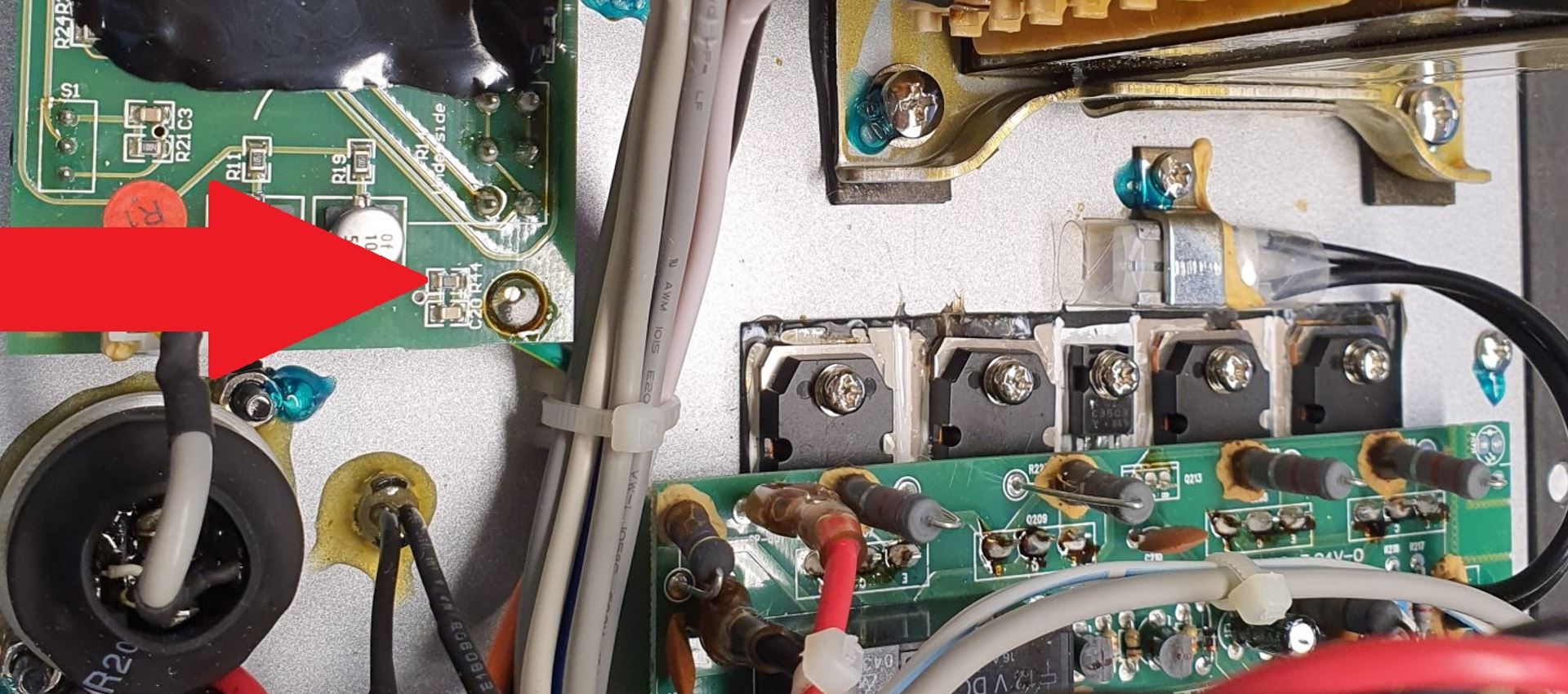

Does anyone still have one of these lying arround? Got a broken one and replaced the dodgy caps but no dice. Turns out the transformer gives me 0v on the output. I reverse engeneered it a little and worked it out to be 40v -0- -40v ac on the seccondary? If you could break it out and measure it or help me find a replacement that would be awesome...

On second look because I didn't look properly last time.
I am now looking at the attached photo and have zoomed into the top left.
Next to ISSUE:1.4 WAH JP1.
It looks like:
Black: Screen, 0V
Red: Signal
White: +15V
Yellow: -15V
Which resistor was burned?
If it blows a fuse then the fault is more likely to be on the bigger amp PCB.
I will take mine apart again in a few days and make some measurements for you.
Michael
Do you know value of R44 SMD resistor?
