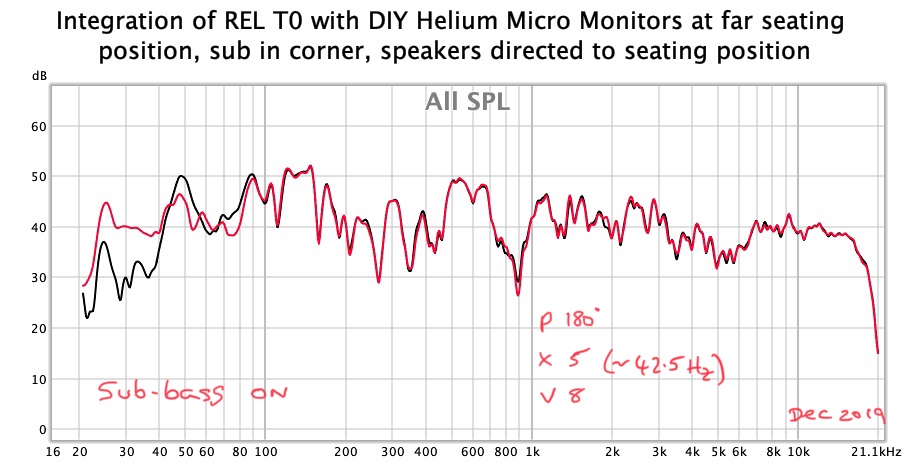

REL T Zero integrated with DIY Helium Micro Monitors (HMM) in my work area using REW to set XO and volume, phase and position.
Sub bass speaker on carpet over concrete
Graphs show best integration I could achieve when listening at desk (HMM toed in on desktop, sub under desk in corner) and when listening on a couch on opposite side of the room (HMM minimal toe in)
