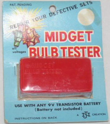

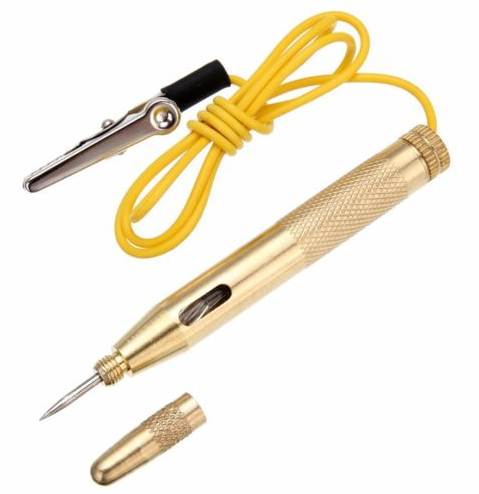

If you use a mains bulb tester (or rather a mains bulb limiter) you can spare yourself the agony of more failures and wasted money. A bulb tester by the way, is usually interpreted by search engines as something that either tests the bulb itself, or where the bulb is used as a power/no-power indicator like these examples below. I don't need to say that they are not suitable.
