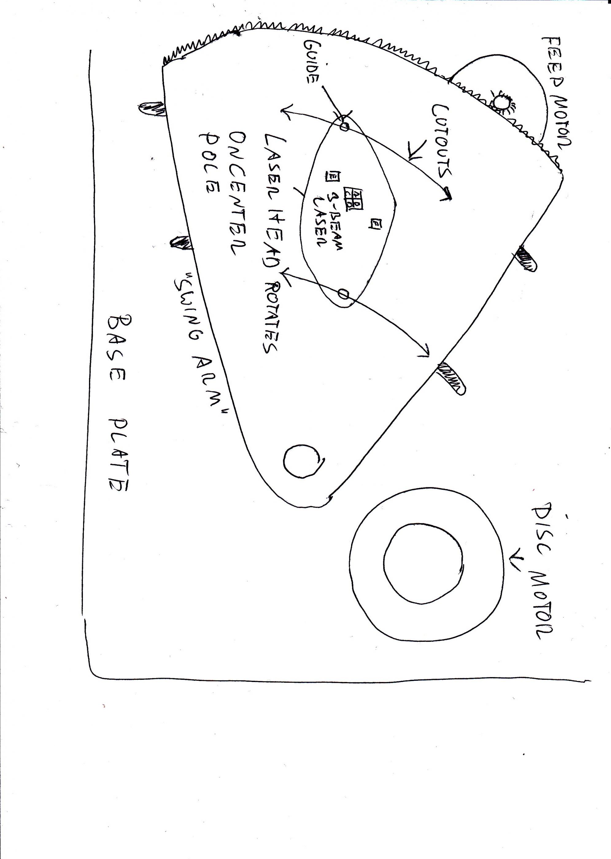

A quick shot, after reading your post only once:
Maybe we are too close to Philips while reinventing!
Why swing arm? One bearing to care about. More about this later.

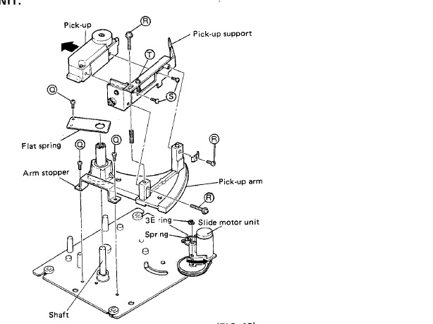

Now transmission with linear mechanisms was sometimes strange, sometimes screw drives were used for moving the laser. Maybe a swing arm should be regarded as another
way of transmission in this project. Like in the Denon DCD-1800.
In the Denon, it was poorly made. A rubber disc driving a rubber plated chassis.

The Denon mech could be a start besides the rubber rim.
Could be also done with simple brushed motors.

Uhm-looks like the Denon solution should be more considered than the Philips-solution. As stated before,in Philips players lateral movement is completely done with the arm, -which is prone to stiction -whereas in the DCD-1800 lateral movement is done with arm and lens - like in linear tracking devices.

Notice the mechanical mounting, which allows for perfect alignment. You can use gears to drive the head back and forth, and it does have both focus and tracking movements in the actual lens mini-mechanism. What this means is that a normal chip set can function, or a Philips chip set. You just need to change the servo gains and filters to match the dynamics of the larger head.
If you have used a direct mounting for years without these problems - fantastic! Too many people do have a problem with this to allow a service issue to go forward now knowing that it is a problem. All a try needs are teeth ground in the lower surface on the inside and a limit switch. You can then use a motor and gear or belt pulley.

With the tiny ball bearing point mounting of the arm, as in the cdm-4, it takes *extreme* grease hardening to cause sticking of tracking as you describe, and it's pretty darn rare in any of the radial cdm mechs, in my experience. I don't see any problem with staying with the radial motor system, but I can see a LOT of potential for problems with any sort of improved Denon style mech. First of all, the motor to drive it, short of finding an exotic one, will be a brush motor, which will inevitably wear out, and, since, unless quite geared down, will move very slowly, promoting commutator arc'ing & thus earlier demise from carbon buildup(Nakamichi gear-drive reel motors spring to mind). Secondly, a gear rim drive will have play/friction issues, which a countersprung gear rack will be unsuitable for, due to the curved gear rack. Which leads then to some sort of friction drive, like the actual Denon system. And we'd also still have the concern about pivot point friction, which the Denon solved only by being a very, very 'high pressure' drive system, i.e., a real brute-force rim drive for that massively heavy assembly. I just don't see this as anything but a)hugely more complicated, b)far less reliability potential, and c)no better trackability than going with radial motor(which, remember, is fundamentally a super-low-friction version of a linear motor).

The Philips way is still an option? But to overcome "stiction", could it also be possible to have the fine lateral movements done by the laser lens?
Looks like Philips never did it this way and left the lateral movement completely
to the swing arm, thus an oscillating movement was needed.

Aligning the laser head in three axis is a great option, but maybe useless for the diyers without a proper jig?
So, what do we have:
As a start, we have to find out who still builds single beam lasers / laser heads. Then there are finished servo electronics at hand to tweak.
BTW my contribution to this project can be to do the CAD drawings and to hire someone to do the milling.

Thus, if it was a linear drive or radial drive: How should this head be mechanically aligned?
The "chassis" has only the bearings for fixing this head to a base
and only care about even planes, a bent gear and one absolutely perpendicular bearing.
But: it looks like there is no head option. The only originally manufactured heads available are the Sanyo SF-HD 65 / 850.
Haven´t found any other manufacturer yet. No hints on the TEAC or Pioneer company pages that the do OEM. Sony or Philips are copies.
The Sanyos also seem to be the only ones with available datasheets and dimensional drawings besides the VAMs from Philips.
This drawing looks ridicilous also the angles/relations are not correct.
The disc motor is of course at the end of the arc drawn by the laser, not next to
the swing arm´s gear. But I have no time to correct this an rescan.
To minimize the angle error of the E/F diodes in an arc, the laser
could be on a turntable/bearing on the swing arm. Cut out guides beneath the turntable. correct the angle relatively to the grooves of a CD. The angle.of the guides would not be parallel to the swing arms direction like in this drawing. Taking a second look i am sure only one guide/groove is needed.
Friction - no idea.
Rubbish?
Friction - no idea.
Rubbish?
