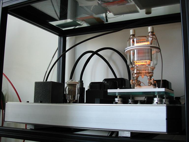

Good morning Howard,
i saw your ping....what can i do for you ?
My 833-amps are well described and suppported with quite some pictures in the thread "where are the 833 amps".
In the meantime i tweaked a bit with new power trannies; but the basics remain the same.
What questions do you have ? Also a 833-builder ?
regards,
Reinout

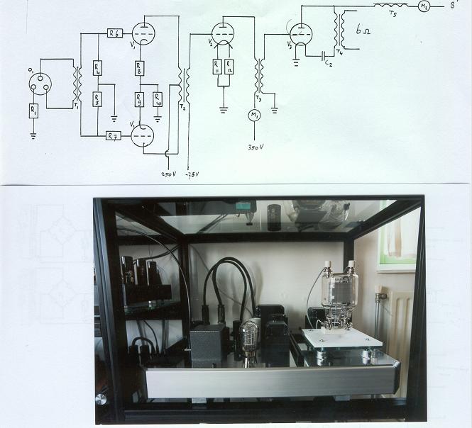

Thanks for responding. I am looking to build an 833 amp and have a mentor locally who will help me. I am gathering schematics of some different amps to bring him. I will bring all of your responses to the original thread but was wondering if you have any schematics of what you have done.
My mentor is an electrical engineer but has not built an amp before. He has always been interested but no time.
Perhaps a full list of components? Hope this makes sense. I appreciate your help. Thanks Howard
schematic amp
Hi Howard,
i believe i had already posted the schematic. It's a 6SN7 input - 300B-driver and 833a output amp.
But the input is of course completely to your own wishes (had some comments that this should be a DHT, but i've of oodles of 6SN7's so this was the easy way and it made easy tube-swapping possible for that last simple tweak).
Same goes for the driver. I use a 300B; but Wavac uses a triode-wired pentode/beam-tetrode. All for the same purpose: get low impendance to seriously fire the 833-grid.
Again: your choice.
Normally i use components that are at hand. Although i have quite a large supply to dig from....i also changed some things in the schematic in order not to being pressed to buy again components.
Word of warning: i use this amp at 1000 ~1400 V. That is lethal ! Although your friend is an electrical engineer, please be carefull.
All the components are AT LEAST 3 times the standard required voltage/amperage.
And that's exactly why i don't distribute the complete list of components. If something goes wrong.....
Reinout
