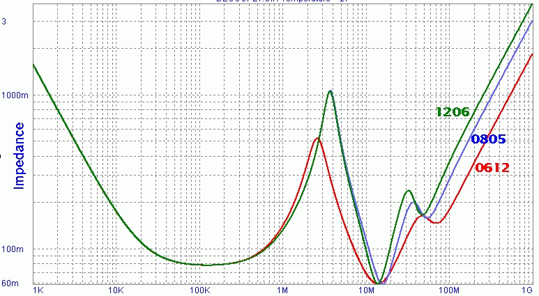

Triplet once more
Just a few things I tried.
I went on AVX web site to try to get ESR and ESL for their various ceramic chip. Found there a nice tool for getting impedance curves. Then I ran my simulator 🙂D) to see what happens.
The circuit is three paralleled caps : a 220nF/X7R/SMT, a 10nF/X7R/SMT and an electrolytic 100uF/10V/LowZ(Rubycon ZA). I added an extra inductance in series with the 'lytic to account for some PCB trace from it to the device it bypasses.The caps were modelled using a simple series RLC circuit (Cap= --ESR-Cap-ESL--), with no frequency dependance of ESR.
For a given Cap/Diel couple, AVX data show only a variation of ESL with the SMT package as follows :
-1206 1.3nH
-0805 1.0nH
-0612 0.6nH
Attached picture shows the impedance of the circuit for the three different packages. Capacitive behaviour at low frequencies, a mix of capacitive/inductive/resistive behaviours between 500k and 10Megs, and above all is inductive.
The 'lytic value acts on the LF part, its ESR fixes the plateau before the peak, and the intermediate region (nice peak, uh ?) is mainly (but not only) governed by the inductance of the 'lytic. I'm not sure of this value (used 10nH - but haven't been able to dig out some "real" values).
It seems here that one of the main points is to have a low inductance (not only low impedance) 'lytic. Impedance curves for them mostly stop at 20-30 MHz, where the inductive part is just beginning to act (OS-CON caps show about the same inductance at 20 MHz that other low Z brands...). Impedance values commonly found are at 100kHz, where all is capacitive and resistive. Knowing the internal structure (wound) of an electrolytic, the low inductance is not easy to achieve. A better way IMHO would be to // 'lytics, since inductance (and ESR) will be reduced and the Cap can be increased.
I'll try to get more realistic models/values for 'lytics' parameters (any hints/links here ?), and to find the best combination of SMT chips which will overlap nicely in the "disturbed" region 😉
Flames welcome 😛

AVX states for an inductance of 0.8 nH for the 0402 chips, with a greater ESR. If 100nF and 10nF values can exist in such a package, you would obtain a curve between the red and he blue one. Adding a 1nF or smaller cap to the triplet will surely reduce the total inductance, but will add a ripple in the disturbed zone. But the (simulated) improvement is not amazing, and staking 10 SMT chips to reduce L is far beyond my skills... Anyone ? 😛

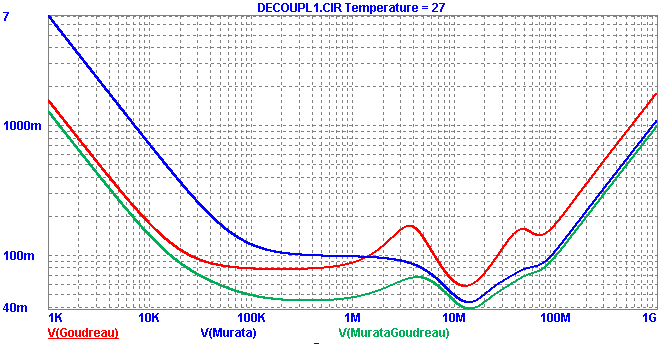

Triplets again
Thanks for the hints/links. Were helpful to better understand some things.
tvi:
I found the ZA series to have a lower impedance (according to Rubycon). And your idea with ceramic chips made me think a lot.
Thus I wandered a lot on the net, and finally came upon something quite interesting : Murata makes high value (up to 100uF !) SMT ceramic caps, in 1206 or 1210 package. But much more interesting, these caps have a VERY low inductance, below 1nH ! Murata provides a free tool to get the characteristics of their chips (both capcitors and inductances).
By the way, I settled on a 22uF/10V 1210 chip, which looked fine for me, and back to Spice, I ran some sims, trying to get a nice overlapping in the 1MHz-100MHz region. I have to say now that I couldn't achieve this without adding another cap, so it's now a "quadruplet" 🙂
I compared three circuits, referenced according to attached curves:
-Goudreau : 100uF/10V/ZL // 270nF/0612 // 10nF/0612 (the original triplet)
-Murata : 22uF/10V/1210/ceramic // 220nF/0612 // 39nF/0612 // 10nF/0612
-MurataGoudreau : 100uF/10V/ZL // (Murata as above)
The characteristics of these caps are :
100uF : ESR=0.07, ESL=5.0nH
22uF : ESR=0.10, ESL=0.84nH
270nF : ESR=0.06, ESL=0.6nH
220nF : ESR=0.07, ESL=0.6nH
39nF : ESR=0.17, ESL=0.6nH
10nF : ESR=0.23, ESL=0.6nH
The electrolytic cap has an additional series inductance for its PCB trace to the other chips.
These values have been chosen after a limited optimization phase, which I not assume to be the best, but I ain't got enough time for that 🙂
The first plot is the impedance of the circuits. The use of the Murata chip (blue curves) shows a nice improvement mostly near 100kHz-5MHz. Compared to the original triplet (red curve), the chip has a lower capacitance, so a higher LF impedance, and its higher ESR levels up the plateau. This can be overcome by adding the 100uF cap, with a great benefit for the overall impedance (green curve). The use of a 220nF instead of a 270nF one helps to have a much nicer transition around 1MHz. The 39nF and 10nF caps work together to maintain the impedance at low level from 10 to 100 MHz, Above, the inductive part takes control 🙂
But we can look a bit differently at the curves. Plotting the only the inductive part of the impedance (Imaginary part divided by 2PI*F) in the HF region (second plot - on next post), shows a total inductance of 150pH (the 100uF has almost no effect here) for the quadruplet, and 300pH for the original triplet. Quite logical : we //ed more caps, thus we reduced the total inductance. But it has an interesting side effect : using V=Ldi/dt, this means twice less noise voltage for the same noise current variation...
You may think that paralleling 4 SMT caps (+ an electrolytic) might be overkill... Well, perhaps 🙂, but stacking 3 0612 near a 1210 can be doable. Give me a month, and I'll try (I'm lazy 🙂)
I can not speak for US, but in Europe 0612 caps are avalaible from Farnell, and the 22uF Murata can be obtained from Radiospares
Last thing : I'll try to get the same results with more commonly available 0805 or 0603 caps (no 0402, or I'll have to stop alcohol 🙂 ), but I'm afraid we can not avoid the Murata...
Comments ? Help ?
