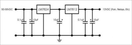

I need to derive 12Vdc from my transformer which has a rectified/filtered output of 55V. Will the attached regulator work? It will only be used to power the fan and relays for the protection circuit. Maximum output current must be around 750mA which I think the regulators can easily handle.
Any comments?

Check the max voltage of the 7824! Some types can take 60 volts other take less....
Use a LM317HV for example. You could also use a series resistor to burn power, together with a 7812.
Oooopppssss!
The 7824 would probably "eject" itself out of the pcb!

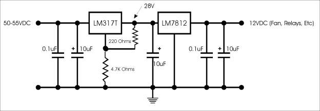

Okay here's a new one.
LM317T Input Output Voltage Diff. (Vin-Vout) = 40V
In this case, my LM317 output is 28V which is set by 220Ohms and 4.7K ohms resistors,
then 55V-28V=27V so I'm below the max input for the LM317T which is 40V.
LM7812T Max Input Voltage = 35V;
in this circuit my input to the 7812 is the output of the 317 which is 28V.
Will this work?

for your circuit with lm317 you need zener diode protection for the lm317 because at switch-on the 40V rating is exceeded until the cap charges up to 15V !
even with resistors you get the same power dissipation, just more in the resistor and less in the device, just to clarify.

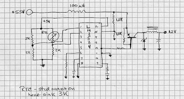

well, fwiw
i drew out this circuit -- using 1/2 of the LM3524's output to drive the switching transistor. the resistors in the bridge with the NTC resistor should be adjusted so that you get a maximum 25% duty cycle on Collector "A" this will put about 13.8 volts on the fan motor. With the switching setup you need a 100uH inductor on the lead coming into the fan controller to keep the switching transients from propagating back into the amplifier. the advantages are low parts count and high efficiency -- the most expensive thing is the thermosensor -- less than $2 from Digikey.
