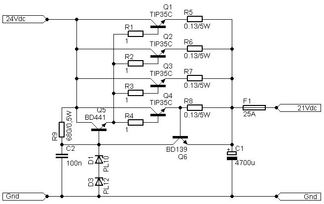

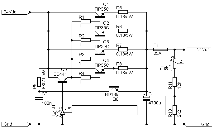

If looking for simple and easy fix than linear regs should be the solution, so here are 2 sugestions of mine, first one uses zenner diodes, it is simple but has a rather poor load regulation cus it depends on the transistors Vbe, but you get the advantage of simplicity and stability, the second ine uses the TL431 shunt regulator, it has a much better load regulation but some compensation might be needed, seeing how 431 is an EA... both of them are overcurrent and shortcircuit protected, the fuse assures that the latter situation will last only a few seconds, if it does not blow up when needed than you could either move it in front of the regulator or lower it's current rating. Be aware that the power devices needs a rather big heatsink.
