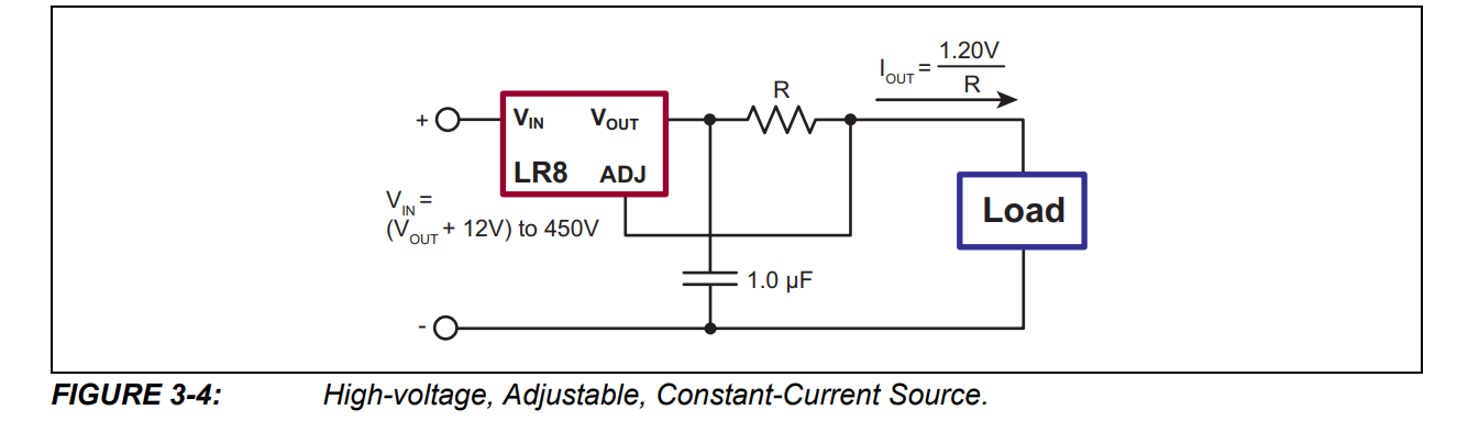

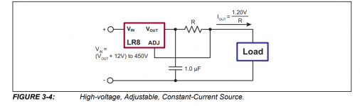

Cool, and HV CCS usage too. I remember seeing a few of the Bruce Heron projects also using LR8, I bought a tube of them for that project but never got to doing anything with them yet.

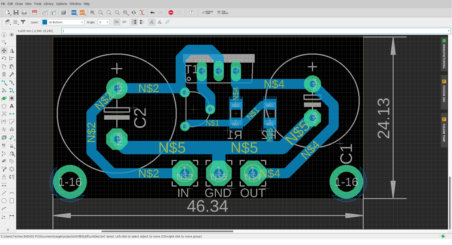

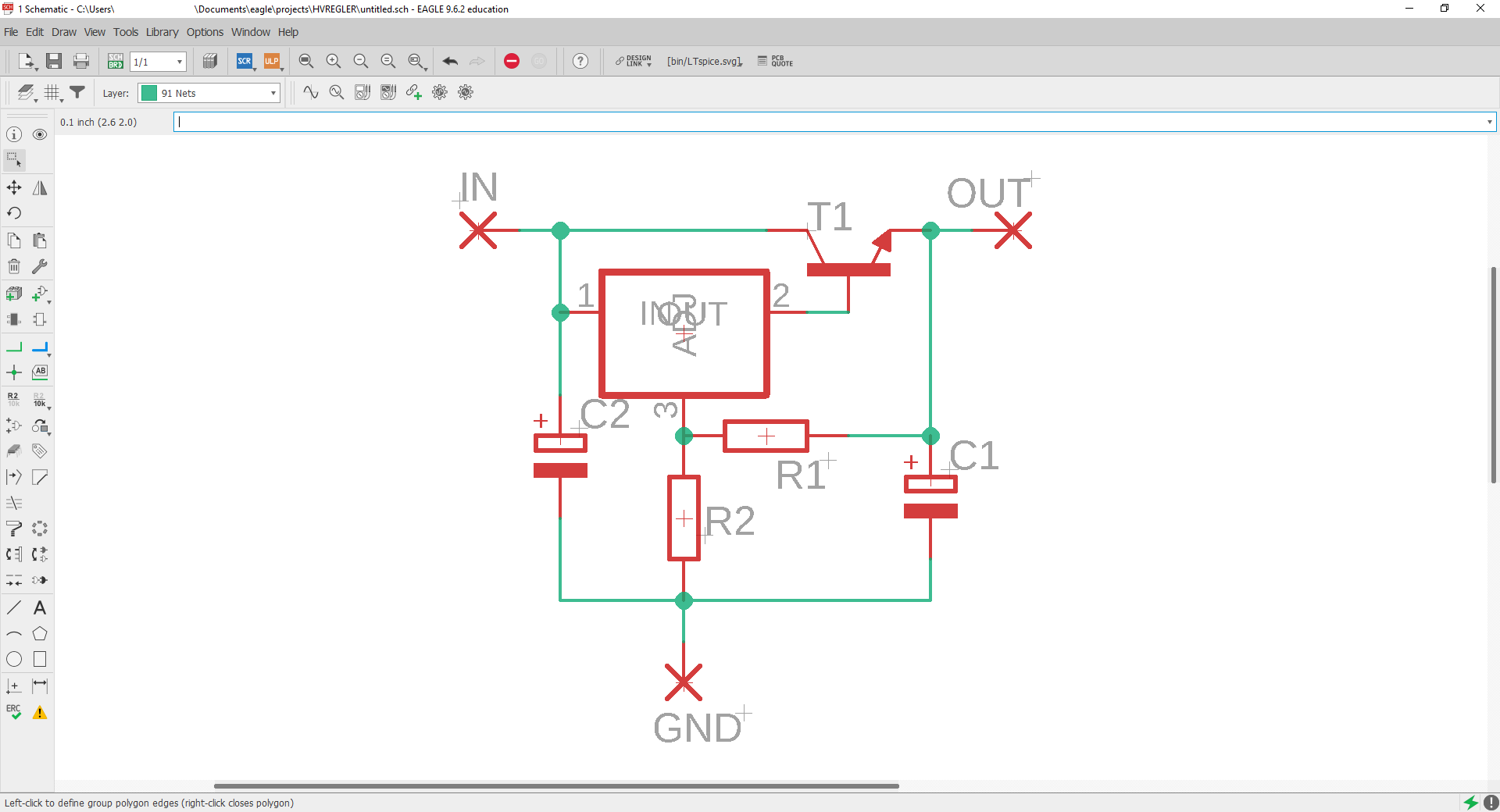

I have drawn up a quickie that I will be running everywhere from now on.
(Yes I am aware im taking the feedback from the emitter of the transistor and its perfectly fine and above all I also have now a hopefully more stable output which is not linearity dependant of the transistor (TIP50))
You could add pads for rectifier diodes and a filter cap (or 2 plus pads for a coil), 2 extra mounting holes and a PCB mount heatsink. All this can come very handy in some situations. You definitely want a protection diode over the IC! I don't think the feedback should be taken from the emitter but that is your choice. The SMD resistors will have to be selected for maximum allowable voltage. Probably TH resistors are a more versatile and safer choice.
