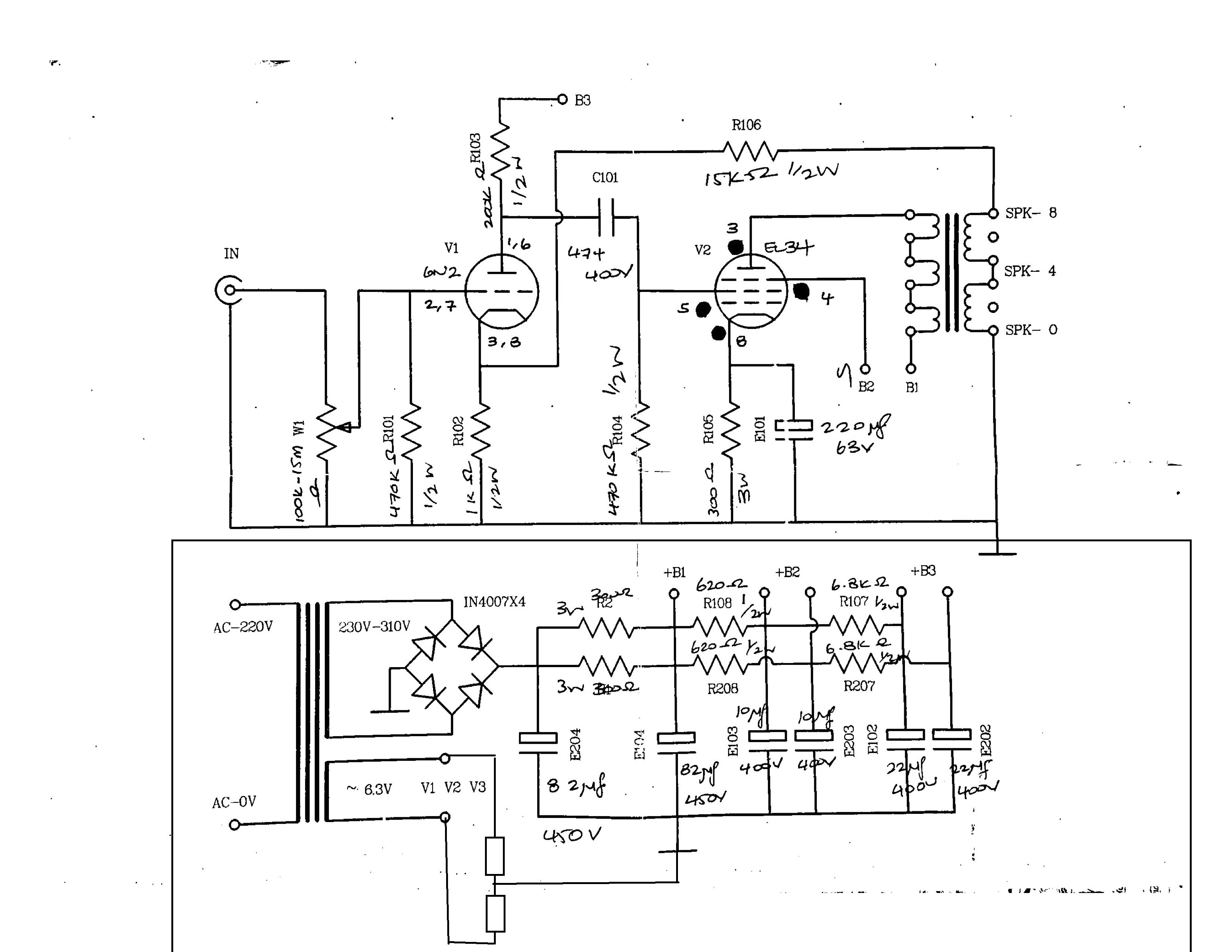

Thanks to all of the useful information from you guys, I was able to narrow down the problem on my 6N2/EL34 kit amp build to the output transformers. I had installed both of them backwards due to the lack of markings and the fact that the winding connections to the poles were covered. I should have probably tested them with my multimeter retrospectively, but an oscilloscope and sample tone helped me figure out and rectify the issue.
My amp now makes sound, however there is a constant hum present on one of the channels, even when there is no audio input connected. I swapped both of my output tubes and the hum was present on the other channel, so my tube might just be bad. I’ve ordered a matched set, but I am quite concerned about my heater voltages. The 6.3V tap from my power transformer reads 7.3 volts and I’m sure that’s the cause of all of the tube/hum issues.
Would it be a better idea to put a 1 ohm 10w resistor between the transformer and the filaments, or build a 5A DC regulated power supply (probably based on the LM317)? Also, my amplifier has the filaments directly connected to the 6.3V input. Would it be wise to add in a small value capacitor and a couple of 2W 300-600 ohm resistors between the filaments and ground?

Calculate the freq using your scope,measuring the OP with no sig IP , that is if your scope doesn't have a readout. Count how many square's from peaks, x by time/div setting, then divide into one, EG 4 divs between peaks, timebase set to 5mS/div, 4x5=20mS, so 1/0.020 = 50 (hz), apologies if you know this.This is a good circuit if you can't solve your hum issues by a humdinger or sorting the ground connections, see attached.

For EL34 output stages, ac-heating should be OK. Ground the centre-tap of the heater-winding, if it has one, otherwise, make a centre-tap as suggested above.
running at 7.3V will not usually increase the hum, but adding resistance to fix the heater overvoltage is worth the trouble, because the cathode coating will degrade fairly quickly with +16% of Uh.

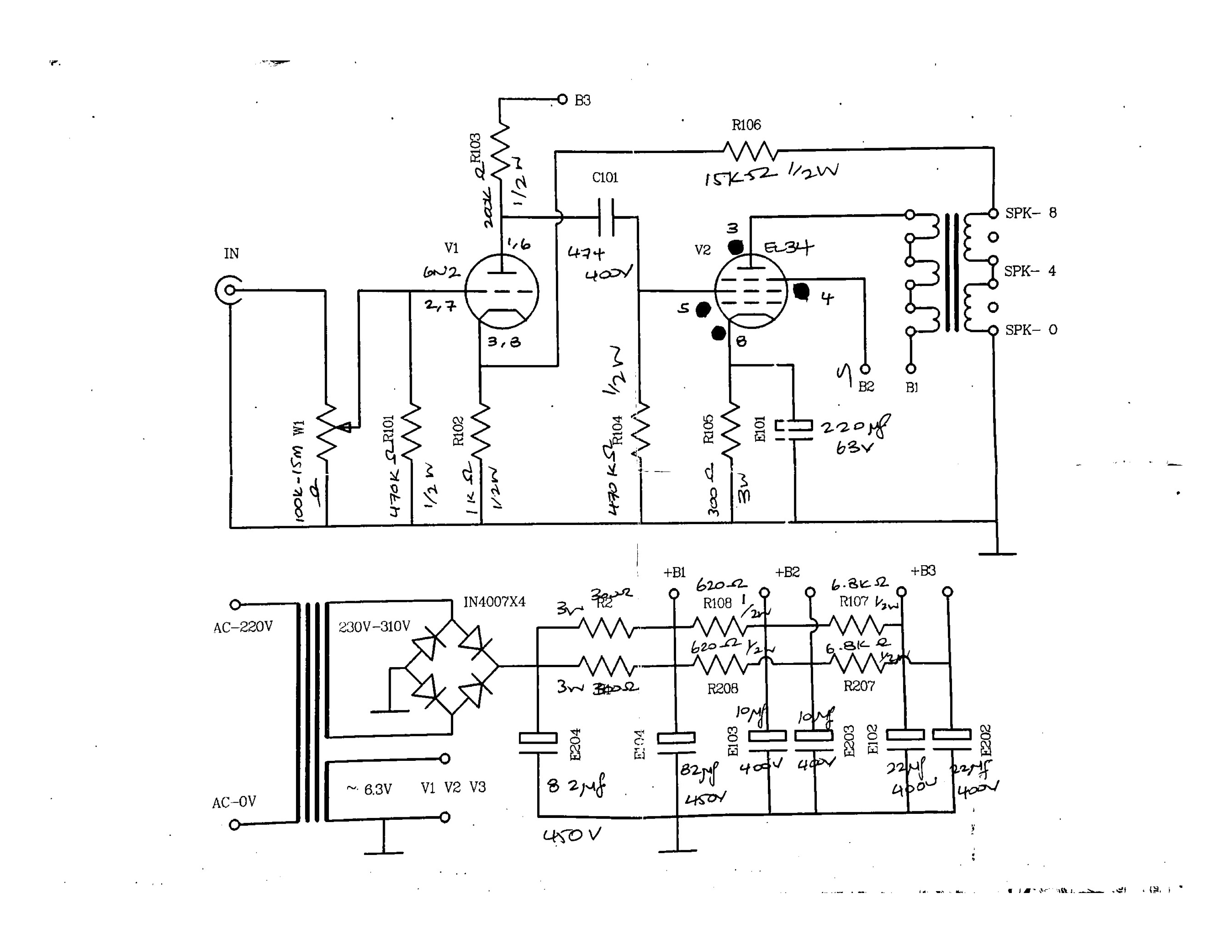

So I decided to run the amp again just to verify that the high temps I could feel were from the power tubes and nothing else. Turns out that two of my resistors in the power circuit, R1 and R2 were beginning to overheat and discolor. If you look at the schematic (I attached it again) these are the first two resistors after the diode rectifier, so with 262VAC in (works out to ~370VDC after rectification if I remember correctly). Should I just replace these for higher wattage resistors, or is there something else causing a significant power draw?
Put a couple of 6W 300-ohm resistors in place of the 3W ones but they were still getting abnormally hot (180°+). Is this normal for the power supply? I would hate to put a new pair of tubes in and have them get damaged.

You just need to measure the voltage drop across the resistors to calculate the current (I=V/R), and once you have that you can calculate power being dissipated (P=VI). Rating of the resistor should be at least twice the power dissipation.

Measure the voltage drop across the 2 resistors...lets say 25 volts. The 2 resistors together have a resistance of 150 Ohm.
Therefore 25/150=0.166666 Ampere. Multiply by a thousand to get mA.
0,16666 * 1000 =166mA
That first of all would be too much current for a SE with 6N2 and EL34.
So that gives us a lot of info.
Secondly calculate the power the resistor has to handle. (P=VI)
VI = Voltage * Current. Voltage measured in volts. and Current in A.
So 25*0.166666=4.16 W.
You generally want to over engineer. So get something 3 times the wattage IF that really was the case.
So I got the other DMM and connected it to the HV in line on the PCB. The two EL34's and the 6N2 were pulling a combined 220mA. When I removed the bad tube, the current dropped to 80mA for one EL34 and the 6N2. Probably explains why my resistors were burning up. I also measured exactly 400VDC right past the rectifier diodes. With two resistors wired in parallel for each section and if my math is correct,
B1 would have a voltage drop of (0.08)(150) = 12V drop across the first set of resistors with power dissipation of (12)(0.08) = 0.96W dissipation.
Drawing 220mA, the Vd would have been (0.22)(150) = 33V dissipating 7.26W. Makes sense.
