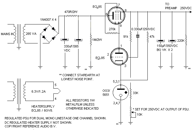

I am going to build Broskie's Aikido preamp, but would like to regulate the power supply. I only need around 15ma, but would like it to be hum free - and with no pops when the air conditioner cuts on/off. What do you think about this idea (see schematic)? Regards, Bill.
Rather complicated circuit when a simple VR150 & VR75 tube in series will net the same +225 with only 1% or so less regulation. The VR tubes should have a .1uf capacitor placed across the output to remove some noise plus a small choke on the output for best noise reduction.

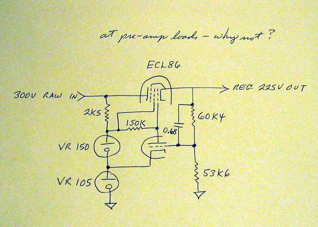

Thanks for the input, all! I'm planning on using 12ah7 tubes for the signal section. With 1K cathode resistors they should pull about 10ma per side at 225V, or around 15ma with 300V (which would pretty much max them out). I'd considered a CLCLC passive PSU, but hoped the active regulator would produce less ripple. Bill.
Only, you'll have a shunt regulator. One that doesn't like to see a capacitive load too.
Pretty meaningless if you ask me.
Bill,
Why waste a perfectly good sounding ECL86 when you can lose a rather useless ECL85 instead?
I can't understand the reasoning behind using a series pass device with high internal resitance such as the penthode used here.
Moreover you regulate the grid as well where another VR tube is used...
Why not triode connect the penthode, use the triode as an error amp and stick a VR on the cathode end?

Bill*B said:Thanks for the input, all! I'm planning on using 12ah7 tubes for the signal section. With 1K cathode resistors they should pull about 10ma per side at 225V, or around 15ma with 300V (which would pretty much max them out).
Won't that make the total current draw closer to 40-60 ma for stereo ?
won't that make the current draw closer to 40 - 60 ma for stereo?
You're right - close to 30ma for signal alone - plus that required for the regulator drop. The little circuit could probably support only one side.
you'll get better performance from a Maida regulator

Bill, why throw away the excellent source Z performance of the Maida by adding a big old high impedance component after it? Simplicity! Two excellent tube implementations of the Maida regulator were published by Joe Curcio in Glass Audio (his ST-70 rebuild article) and Morgan Jones in "Valve Amplifiers." I use the Curcio implementation in my preamp and in two of my power amps. Over 10 years of use with no failures.

The first posted schematic won't work very well. If at all. To get 225V output, the screen on the pass tube is at a mere 30V. You can remove the top VR tube altogether. A small cap across the VR tube, which can be a lower current unit such as 0G3, will cover regulation and noise good. Or a zener string with generous electrolytic bypass.
If you want even more regulation, you can add a VR from output to error amp grid. That way the error amp's grid and cathode are locked between two voltage sources, improving regulation a few dB. Beyond that, a pentode error amp or several cascaded stages (preferably balanced for stability) will be required for better performance. But none of this is necessary, of course.

SY - I was just kidding about the damper tube, but until I get more comfortable with solid state, will probably stick with a tube circuit. I do agree that solid state can do just as well (or better) in competent hands.
Sch3mat1c - thanks for taking the time to help. I agree, in my mind I've abandoned the original circuit.
