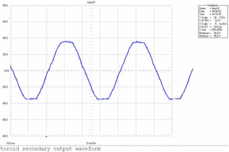

Real-world picture:
planet 10.
I get very nostalgic when I see such a textbook picture.
This is what I've measured during the test of my LDO-regulator today:
Perhaps the phenomena in question has something to do with the relationship of the inductance of the secondary - the resistance from the secondary to the capacitors - the capacitance - and the waveform ??
