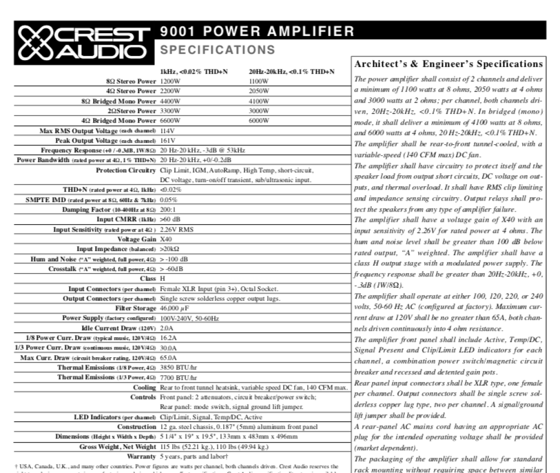

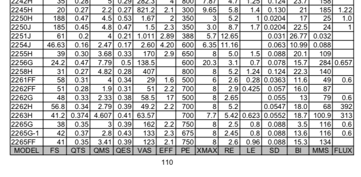

What do you more knowledgeable guys think of my power amp calculations:
For my subwoofers (JBL 2245H) the continuous power rating is 600W at 8 Ohms.
The crown website has this advice:
How Much Amplifier Power | Crown Audio - Professional Power Amplifiers
The recommendations seem to be 2.5 times the continuous power rating of the speaker in amp power (watts). For loud heavy metal.
I am more a reggae sound system but I assume reggae is as demanding as hard rock for these calculation purposes.
So 2.5 times 600W is 1500W per driver.
I will have (16) 18 inch subwoofers in (4) quad boxes. If I buy crest 9001 amps. They deliver 2050W at 4 Ohms stereo. So If I have (2) drivers per channel I will get 1025W per driver. Which is 1.7 times the continuous power rating of 600W per speaker.
This would mean I would need (4) crest 9001 amps. One per quad.
If I am to follow the advice of the crown page I would need 1500W per driver. I am hoping having (16) subs should compensate for the lower amp power.
I am confused how an amp (like the crest 9001) can deliver 1100W 8 Ohms stereo which would be one JBL 2245H 8 Ohm speaker per amp channel. (2) speakers per amp.
But if I connect (2) speakers per channel, I get 2050W stereo at 4 Ohms so each speaker get's half of that power, 1025W.
In my mind this seems like in the first scenario I have two speakers getting a total of 2200W power at 8 Ohms from one crest 9001 amp. In the second example I have four speakers getting a total of 4100W at 4 Ohms.
To a laymen newbie it seems like connecting speaker in parallel reducing the impedance gives you extra free power. I assume it puts more pressure on the Amp though?
My friend put on a nice small/medium sized dance with (4) 18 inch subs getting 150W each. It didn't deliver chest thumping bass but he still got fined 500 bucks by noise control. It was bassy just not quite big reggae bassy.
1025W in comparison seems huge.
3)If I am to follow the advice of the crown page I would need 1500W per driver. I am hoping having (16) subs should compensate for the lower amp power.
4)I am confused how an amp (like the crest 9001) can deliver 1100W 8 Ohms stereo which would be one JBL 2245H 8 Ohm speaker per amp channel. (2) speakers per amp.

Not to disparage Crest amps (I used them for over three decades), but the 9001 is not the most efficient use of power, though that's another discussion..
1) The JBL 2245H has a PE (Thermally-limited maximum electrical input power) of only 300 watts (as previously mentioned..)
If you use an arbitrary value of 2.5 x PE, you should be estimating 750 watts peak.
2)According to the specifications, the 9001 is capable of 161 volts peak output per channel, 6480 watts into 4 ohms. The old "boat anchor" Crest amps are fully capable of 2 ohm operation. Decades ago I ran Crest 5001 and 8001 (similar designs to the 9001) at two ohms, though their current limiting does reduce the maximum power per driver compared to 4 or 8 ohm operation.
3) The amount of subs does not "compensate" for amplifier power, but each doubling of drivers and cabinets does add 3 dB sensitivity.
4) Power amplifiers are actually voltage amplifiers- they deliver "X voltage" into "X load". If it were not for amplifier's (protective) voltage limiting, the power delivered would be exactly double for half the impedance.
The more power delivered, the more "work" the amplifier does - with no load there is no work, fine for solid state amps, not for tube (valve amps).
5) Each doubling of power is a 3 dB gain (less "power compression" from heating voice coils) so yes, 150 to 1025 is a "huge" difference, sounding around twice as loud.
6)Amp clipping does not cause speaker damage, too much average power causing voice coil burning or too much peak power causing mechanical damage are the two reasons for speaker damage.
That said, a clipped amplifier can put out more average power than it would otherwise.
7) The explanation is quite simple- keep the amps running cool (heat kills electrical components) and run the speakers within their thermal and mechanical limits.
Of course, to know the thermal and mechanical limits of a speaker requires an actual design to work with- the JBL 2245H PE of 300 watts is dependent on the impedance curve of the cabinet it is in, and it's mechanical limits will be reached at frequencies determined by the excursion curves..
Art
