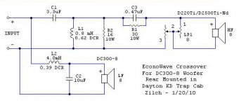

Even $100 Econowave designs have good reviews.

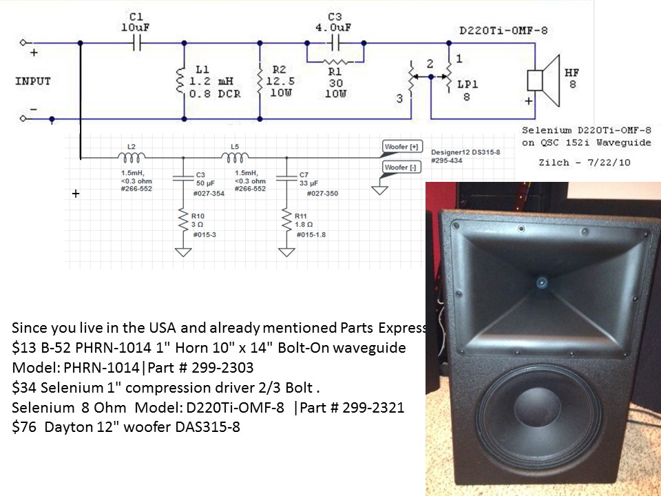

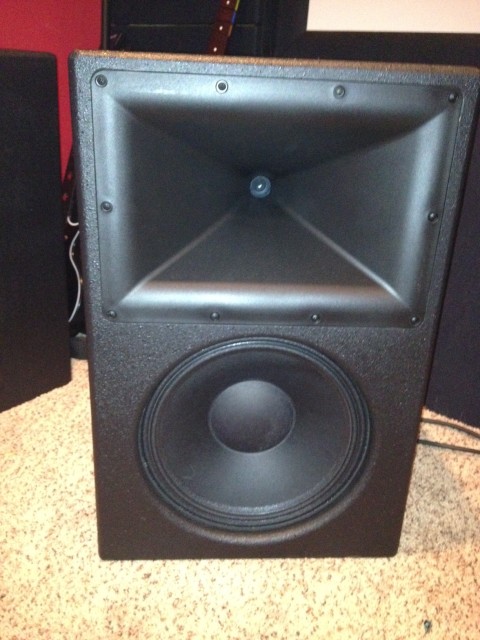

Here is a popular 12" woofer + 1" compression driver.
A ported box volume from 2.2-2.5cuft produces good bass, but with modest efficiency. An 18" woofer box can always be stacked below.
Since you live in the USA and already mentioned Parts Express
$13 B-52 PHRN-1014 1" Horn 10" x 14" Bolt-On waveguide
Model: PHRN-1014|Part # 299-2303
$34 Selenium 1" compression driver 2/3 Bolt
Selenium 8 Ohm Model: D220Ti-OMF-8 |Part # 299-2321
select 12" woofer:
or better
$76 Dayton 12" woofer DS315-8

Same as Econowave, where the transition of directionality from the tweeter to the woofer is guaranteed by the horn in the 2 kHz region, with a fullrange the transition is in the 500 Hz region.
