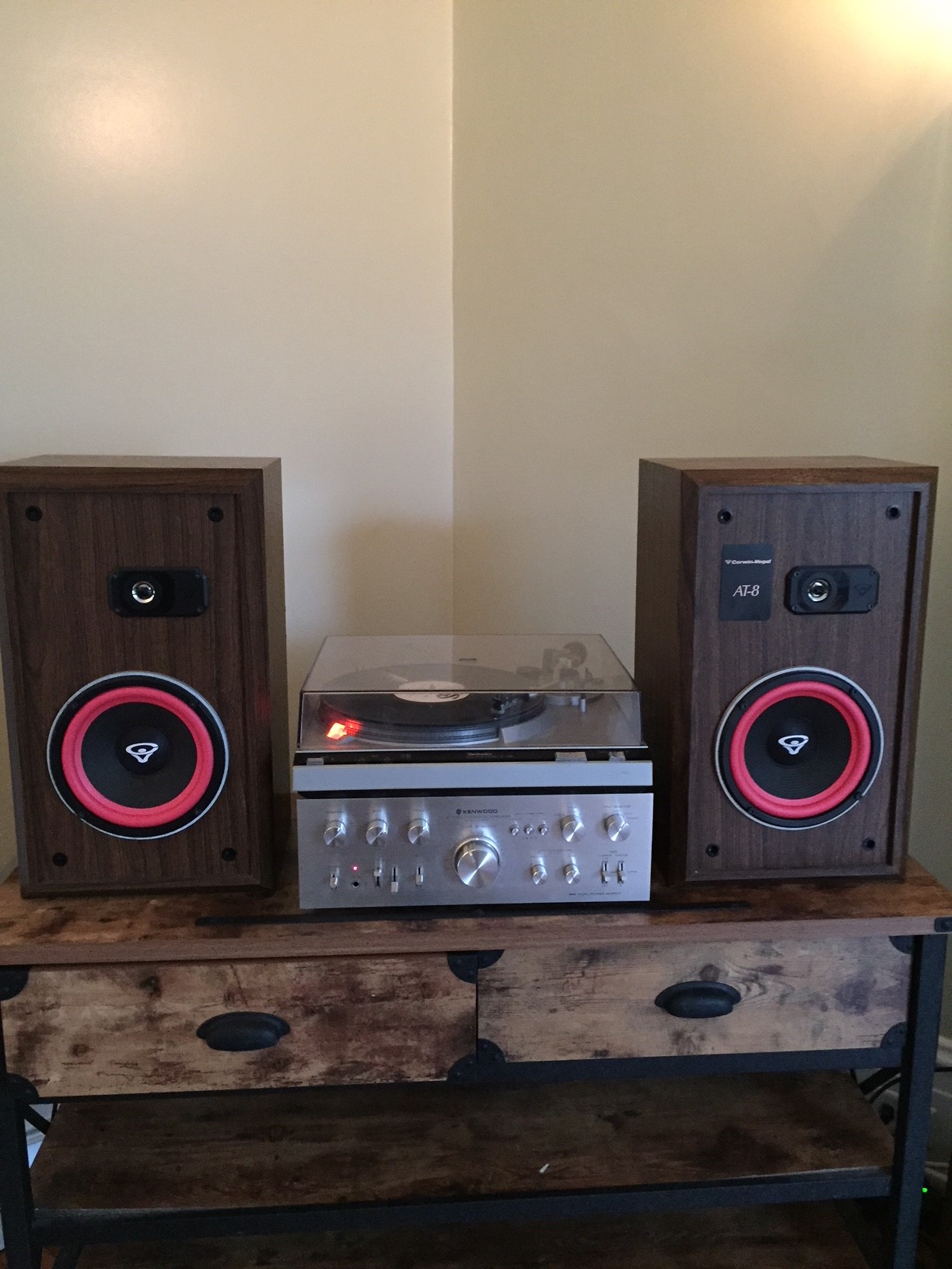

I have a few amplifiers that I play around with, some old some new. An old school Kenwood 8100 is what is in my living room, and that is where I envision putting the speakers I'm building. It's 75w per channel. I also have a Rotel 1065 that only plays in stereo mode and it puts out 120w a channel. It has blown one of the tweeters on my Monitor 7s...ugh.
My living room is large, 12x20 with 10 foot ceilings, the record player and amplifier currently sit in a corner, which is probably some of my issue not being able to get the bass i want.

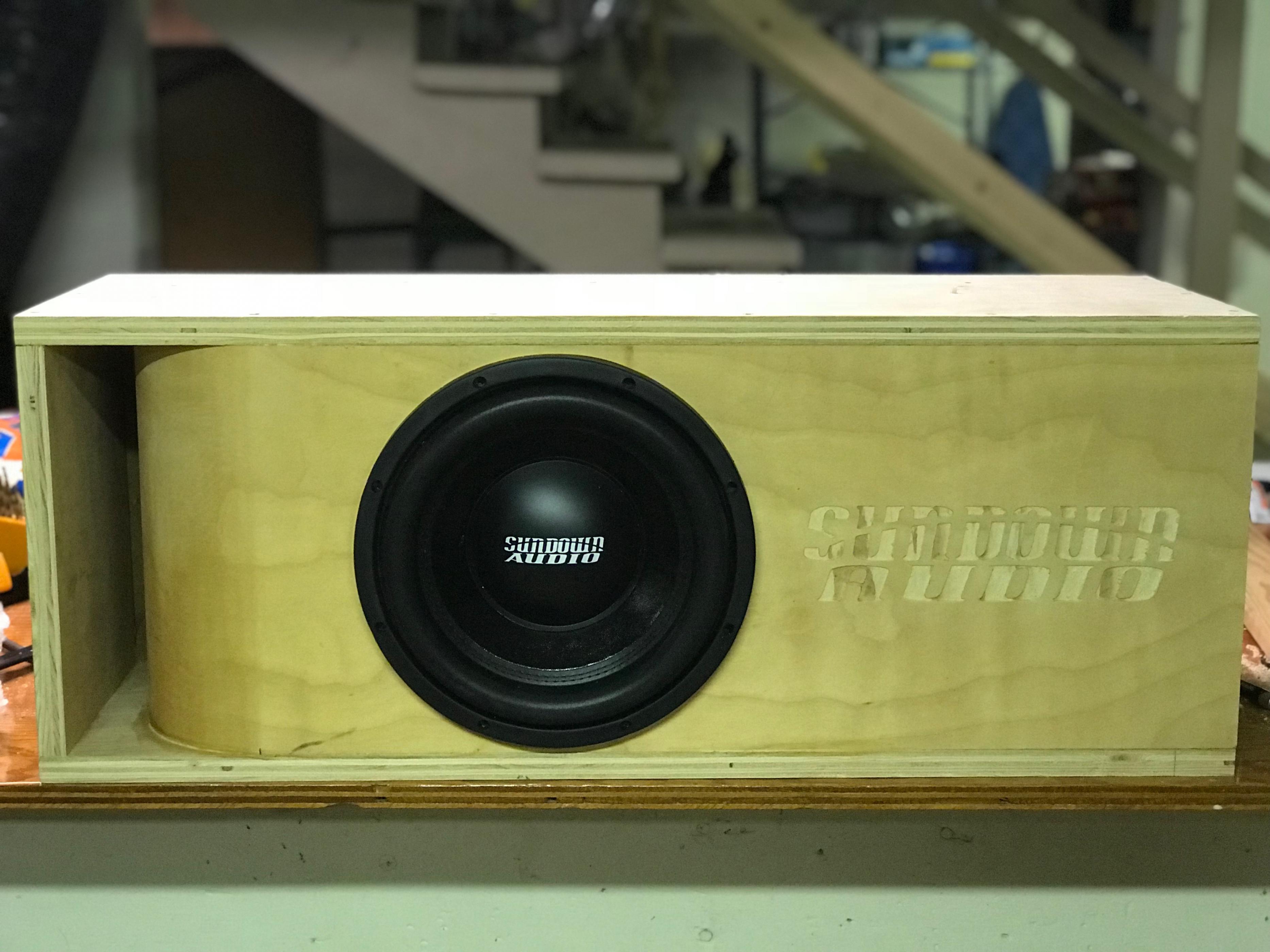

I have a full wood shop and have expreience building speakers, i've attached a subwoofer I recently built for my car. I even have a CNC machine.
What I'm imagining is either a single 15" driver 3 way, or dual 10 inch drivers. I'd like to keep the drivers under $100 per speaker(everything is negotiable). I've looked at Pauls design of these Classix 2.5 - undefinition and they look great, however I feel that their output will be a little more than my Monitor 7s. So i'm still searching.

Badge, nice suggestion. I had a pair of CV AT8s, I reformed and capped them, and they just didn't dig deep enough to what is left of my ears haha. Nice speakers. I sold them to someone that probably got similar advice to the one you just offered. He did text me after buying them and he was thrilled. I attached a picture of that setup.

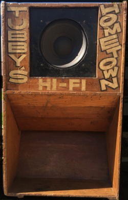

Well, if you are really into it, this is the cabinet loved by Reggae Bass players.
If you want to reproduce their thunderous lows, no questions asked, you might build your own:
They have this Cerwin Vega inside:
of course, this covers just the woofer side, feel free to add your favourite mids and highs.

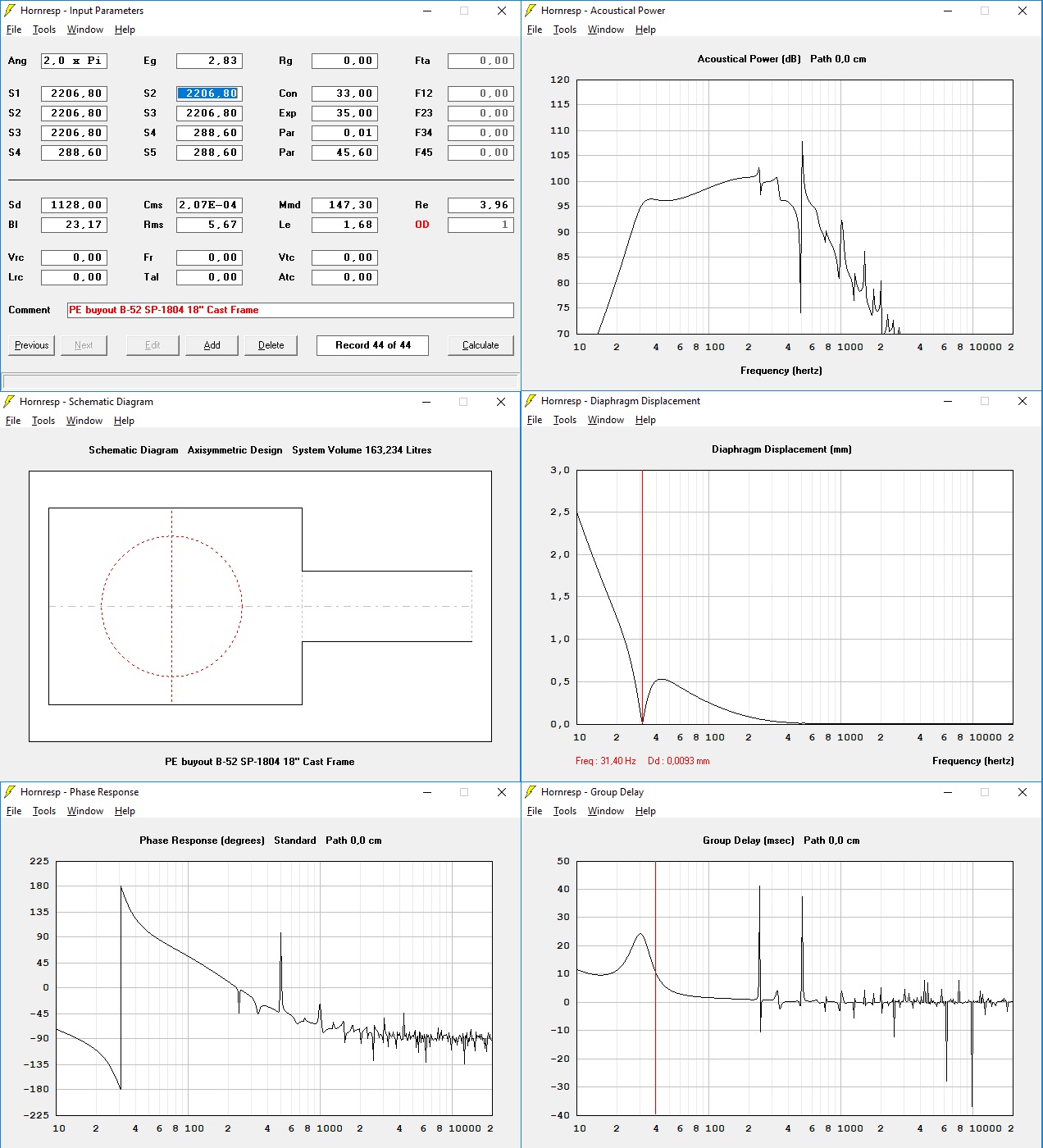

Here's a sim for the PE buyout B-52 SP-1804 18" Cast Frame woofers, they are 75$ each. If the boss gives a slight nod or "maybe" on ~163 liters for bass: Get them ASAP! They should be much better than the Dayton PA380's
How much cash do you imagine spending for the rest of the drivers?
Your beloved RS100-8 is a bit low on sensitivity compared to the subs, but if it helps, just spend the money on some reasonably priced DSP unit for xo and SPL matching until you get the cash to upgrade to something else.
The box I simmed is (internal dimensions only!) 50cm wide x 45-46cm deep (pending on how you intend to brace it), 66cm tall and there is a 6cm tall slot port (with a 18mm "divider" in the middle for bracing) on top or bottom pending on personal preference. 15mm material is OK, but you need to plan bracing well (not excessive, but exact!), 18mm material is better, still need to plan some bracing.

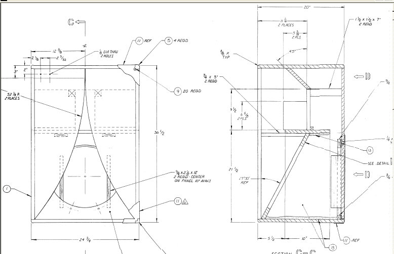

here's the dimensions for the Cetec-Gauss Karlson cabinet (an 18 will run in an 8 cubic foot bulk Karlson type pretty well)
the link to the Cetec-Gauss 5181 K18's dimensions isn't showing
