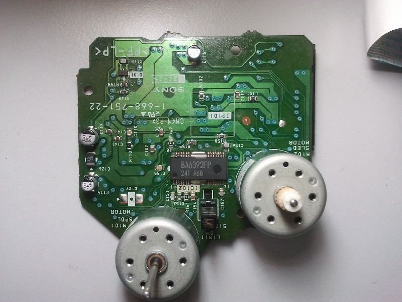

When the focus servo and the focus buffer isn't faulty, one of the supply voltages must be not present.Hi, thanks again.
That's what I thought, maybe the voltage supply isn't reaching the focus servo or the buffer.

pardon me for asking, but you didn't forget to reattach the lid switch back to its place under the cd enclosure, right? There is a little magnet under the cd lid which triggers the switch when closed. If the lid switch is not near this magnet, the laser will not try to read, and the motor won't spin.

Yes, I did removed the blob of protection solder from the pick-up laser. What would be wrong from the lid switch? Yes, it is a '3 wire switch' with a 'A-41E' inscription on the 'magnectic' piece. But does it does seems to work.
I'm trying to replace the laser assembly. I'm not sure where the blob of protection solder is. Could you explain how I can find/solve it?
