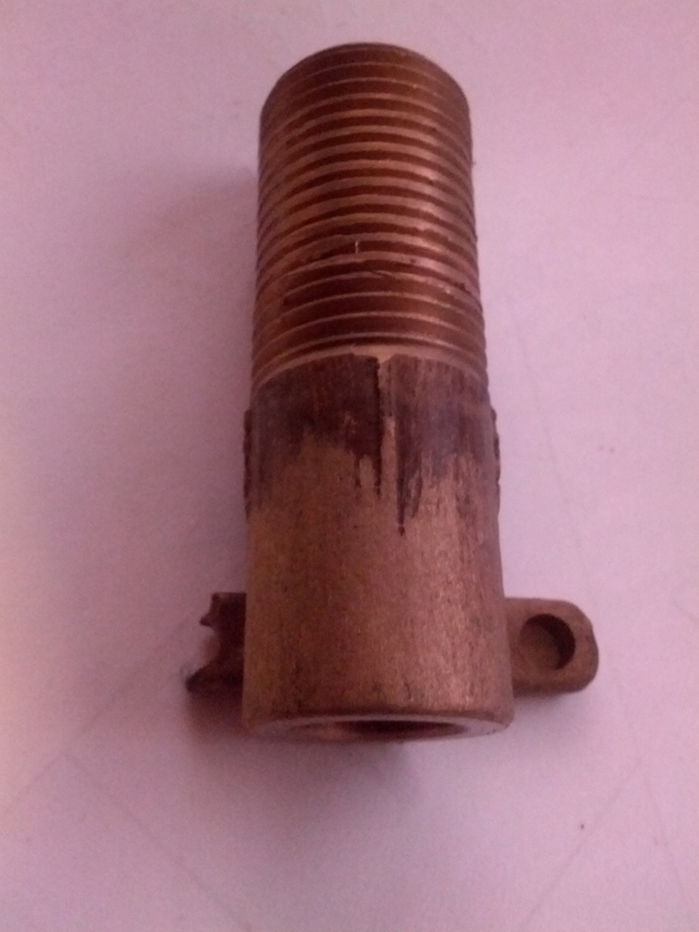

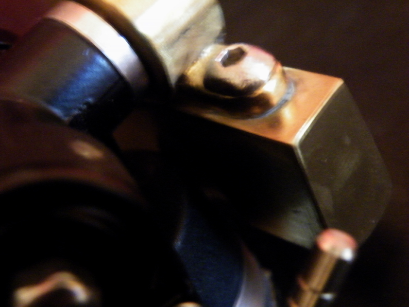

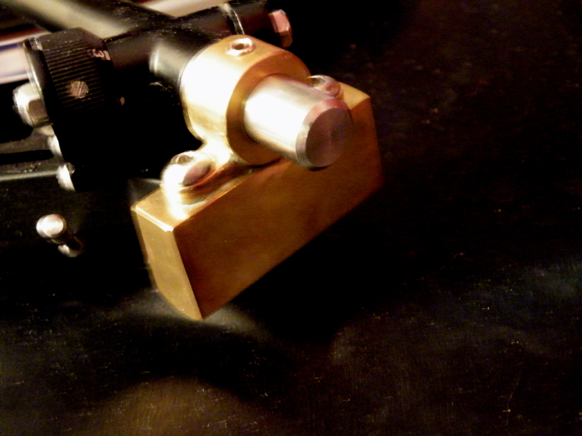

I decided to make my own low-slung counterweight so that it was almost right on top of the pivot-point of the RB300 tonearm. I went to the local plumbing store (of course) and selected a brass fitting of some description which almost had a 1/2" diameter and lugs with holes. I then went to my local engineering shop and purchased a 50mm length of solid brass rod.

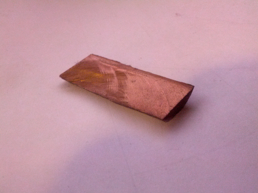

I then proceeded to engineer this counterweight by placing in a vice and drilling the hole in the plumbing part to 1/2 inch. First attempt failed as the part started to spin and broke of a lug (see photo). The second attempt was a success, due to very VERY firmly placing in vice. I then cut it to size so that it was even on both sides, and proceeded to cut slices off the brass rod with a very fine cutting wheel for 4" grinder. I cut both sides off, and weighed, then shaped via a bench grinder constantly weighing and calculating final weight. I left a bit over just for adjustments.
I super glued the arm-end housing part I created to the newly formed weight, and then drilled a bit into each hole. I had to reglue as it came apart due to the drill action moving it, so I cleaned with acetone and drilled the rest of the hole measuring the length of the stainless bolts I got for this, then taped the hole to suit the bolts, super-glued the housing to the weight, and then put some araldite into the hole (not too much) and onto the bolt thread; then tightened and allowed to set. The super-glue is quite hard when dry and would couple the 2 parts more tightly; and the araldite is for extra measure and to keep the counterweight set hard so it works as one piece.

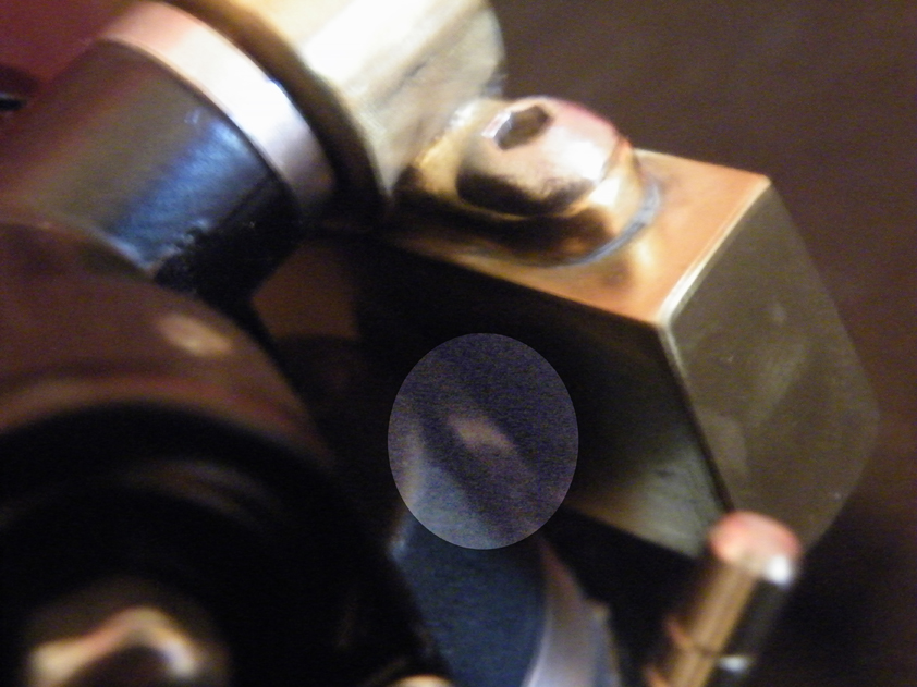

I slid the counter-weight on arm to test. Arm was very limited in movement upwards due to how low and close weight was to tonearm base, so I measured and cut in a v-type groove with a round file and half-round file until it matched and could lift high enough. A good thing I left some extra weight on the counterweight. I drilled a hole on top for a very small stainless grub screw, and then taped the hole with thread to suit, and polished the counterweight with a dremel and small buffing wheel with brasso on it.
In all the time I was engineering this; I was always using accurate digital scales to check the weight and estimating/calculating constantly. Its imperative this is done religously and with great thought and care. The placement of this counterweight is completely set up on my Rega Planar 3 as is seen in the photos, very close to the pivot point by a fraction which is how I intended it to be. Just important to remember the groove on the inside for arm lift (see last photo with that part encircled)

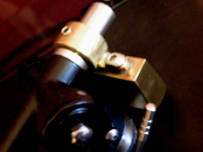

I placed the counterweight on the tonearm and adjusted it straight by gravity and sight correction, then very very lightly moved the allen key to the grub screw and lightly turned until tight enough to turn more securely. I have never looked back, and it made more improvement to the sound with no tracking issues.*
If you have the time, its a great mod to make and feel good about achieving...*
