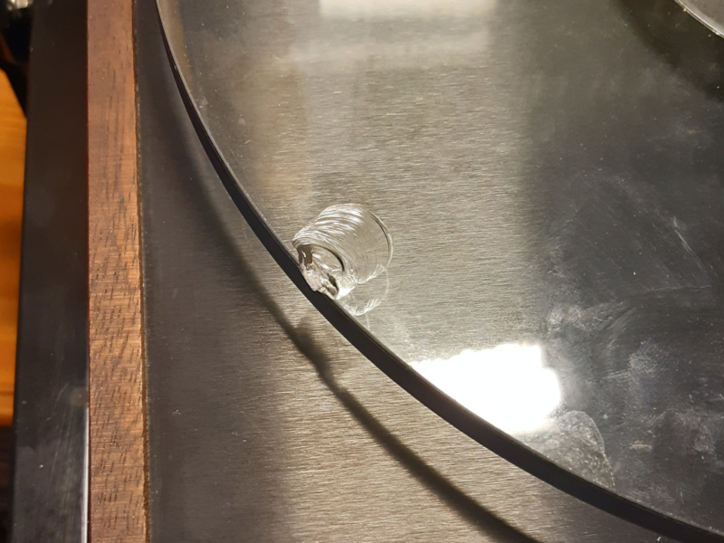

Good idea on the computer screws, I'd not tried them before as I thought they're imperial and the Planar was metric. #6-32 case screws are too big, both in thread and width, but the M3 screws used on CD drives are really close - just a little loose. So I feel that's in favour of M3.5 as well.
Unfortunately after I tested that I dropped the platter while I was putting everything back together. It landed on a screw driver and now has a nasty chip... :crying::crying::crying:
So I'm now in the market for a replacement platter. 😡
