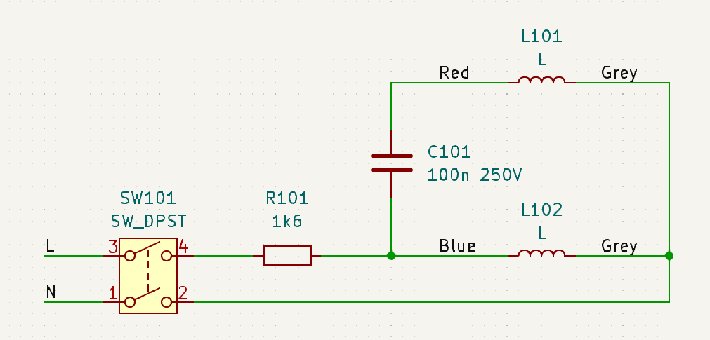

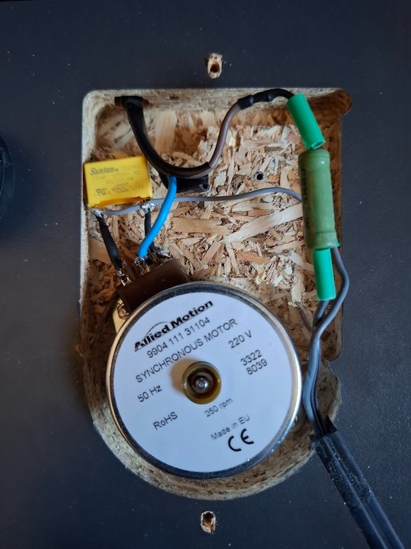

Not sure if it was destroyed during soldering or it was faulty one.One winding is open. Did you destroy the connections by soldering ?
I guess that there is no further action can be done to fix this since motor is bad. I will see if I can get another one and make this work. Thank you everyone.
