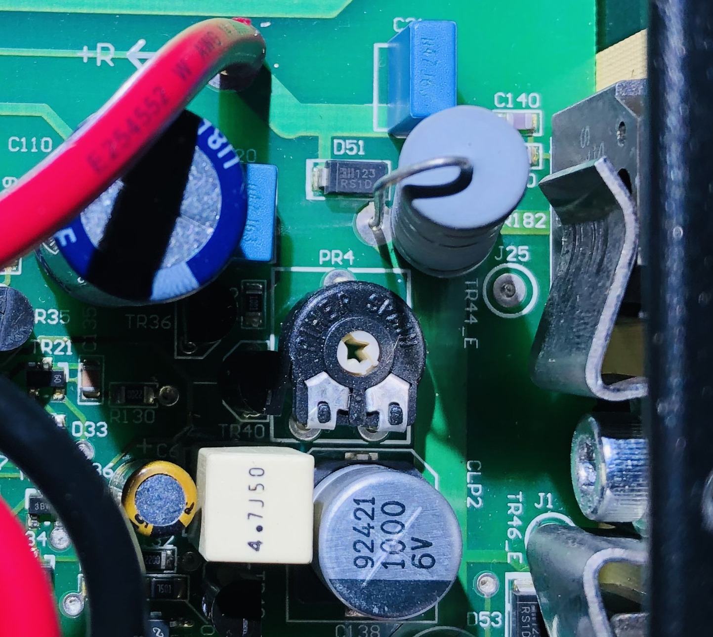

Thanks so much to as_audio. I have now finally had time to make these adjustments to both L and R - and the amp is SO much cooler now. Here are my notes in case it's useful for others:
Rega Elicit amp - bias adjustment
Warning: do this at your own risk - noting for example that mains voltage is exposed once you remove the lid. You’ll need an avo. If you don’t know what “avo” and “pot” mean, this isn’t a project for you! Many thanks to as_audio on diyAudio for the information needed to work this out.
Remove the 6 allen screws on top lid. Slowly lift lid, carefully removing earth connector (attached to its underside) before fully taking lid away.
Looking into amp from standing in front of it, the Left side of the circuit is on the right - see photo. You can see adjustable pot PR4 and two measuring points J25 and J1 (partly hidden). It is hard to get measuring probes to touch J25 and J1 without also touching other things, so put tape around any exposed metal on your probes except at the very tip.
Measure the DC voltage between the two measuring points. Adjust the pot until the voltage difference (between the two points) is close to 35mv.
Now do the same on the left side of the board (J23, J24, PR3). Note that J23/J24 are not in exactly mirror positions of J1/J25.
