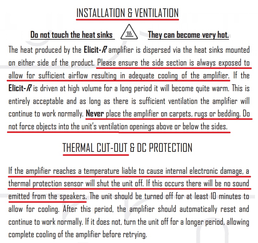

Class A amps always run hot. Perhaps you don't have clear air-flow around the heatsinks? Its almost certainly an over-temperature condition.

If your amp can play music fifteen to twenty minutes and then thermal cut-out, it seems your amp is normal and it just overheat to cut-out for protection.
Maybe you place your amp in a poor air ventilation location. You can put the amp working in an open area to check if it still thermal cut-out or not.
