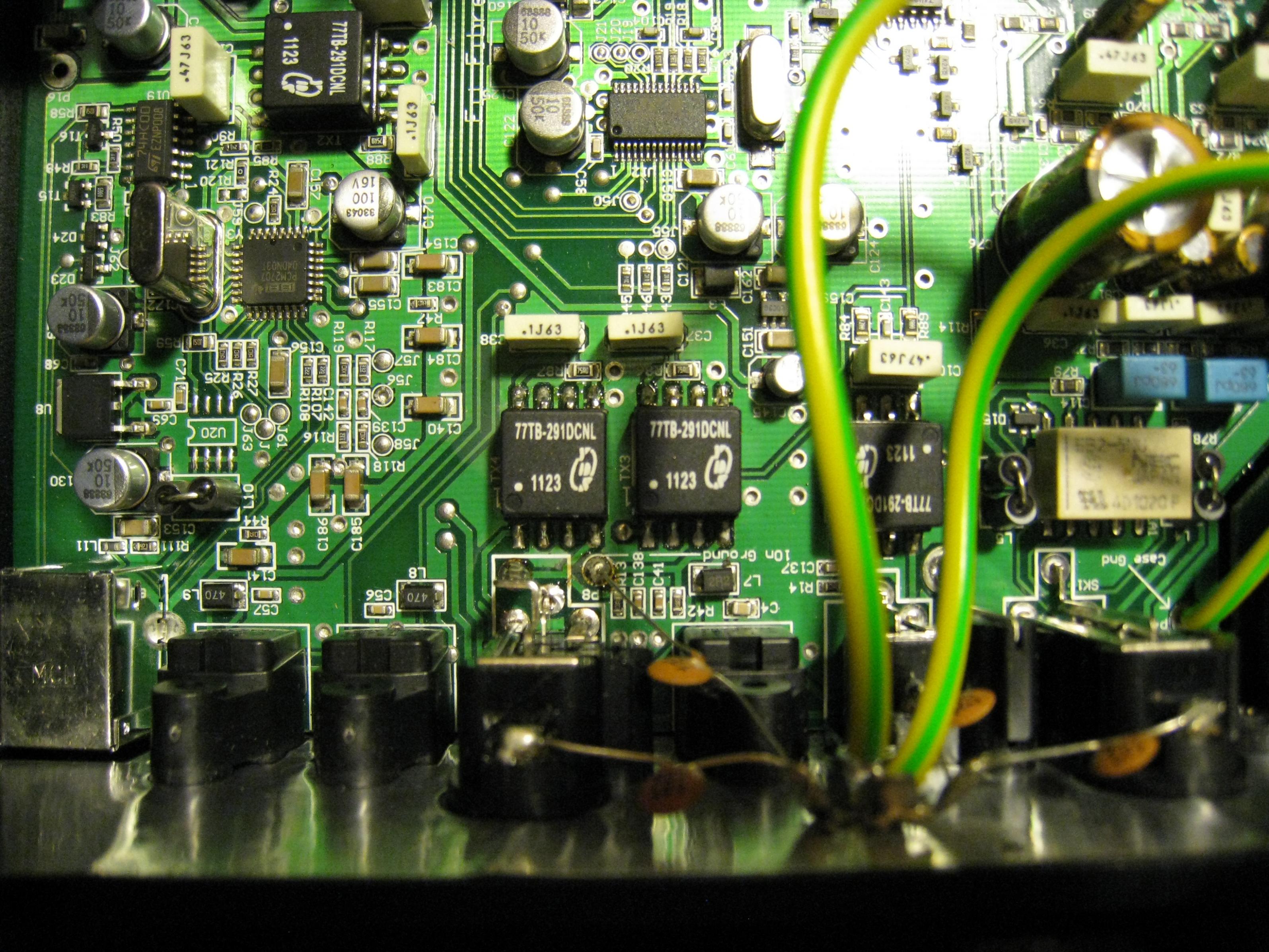

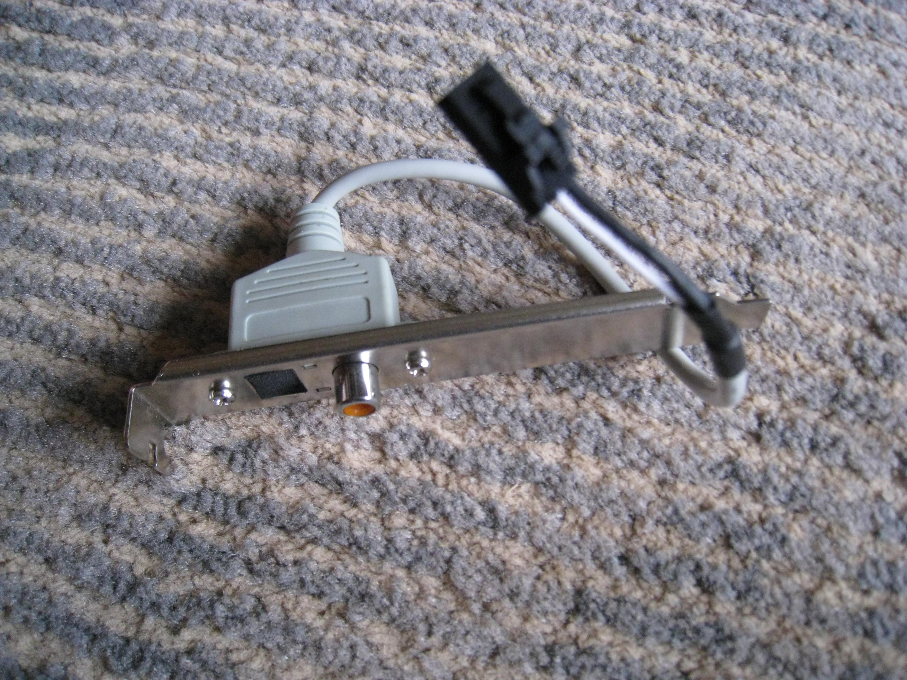

Need help. Digital coaxial input of my Rega DAC is not working anymore. Other inputs such as optical input and USB input work OK. I think it happened because I connected SPDIF bracket to SPDIF connector in wrong direction by mistake. I am currently using the optical input but want to fix it if I can. I can do lead welding (basic level) but don’t know what part is causing this problem. Could anyone tell me what is wrong?

Hi all, Thanks for the comments. I've checked the input resistance and found it is "0". Could it is possible the pulse transformer has been damaged due wrong voltage supplied when I connected SPDIF bracket to SPDIF connector on computer mother board in wrong direction?
I've just checked continuity of the pulse transformers. Front legs of those two in front of coaxial input showed no connection while legs (1 and 4) at the back are connected. It seems they are damaged somehow. Anyone knows where can I buy these pulse transformers - 77TB-291DCNL? I could not find them anywhere.

I can't see any bracket in the pictures, but if you applied 5 or 12V directly to the pulse transformers without some sort of current limiting, they can be toast. There can also be a short on the lines that go from the RCA to the Pulse transformers or inside the RCA jack and that gives You a 0V reading. By the way the soldering of the ??? under the first (left) transformer on the picture looks suspicious. Clean that flux and inspect.

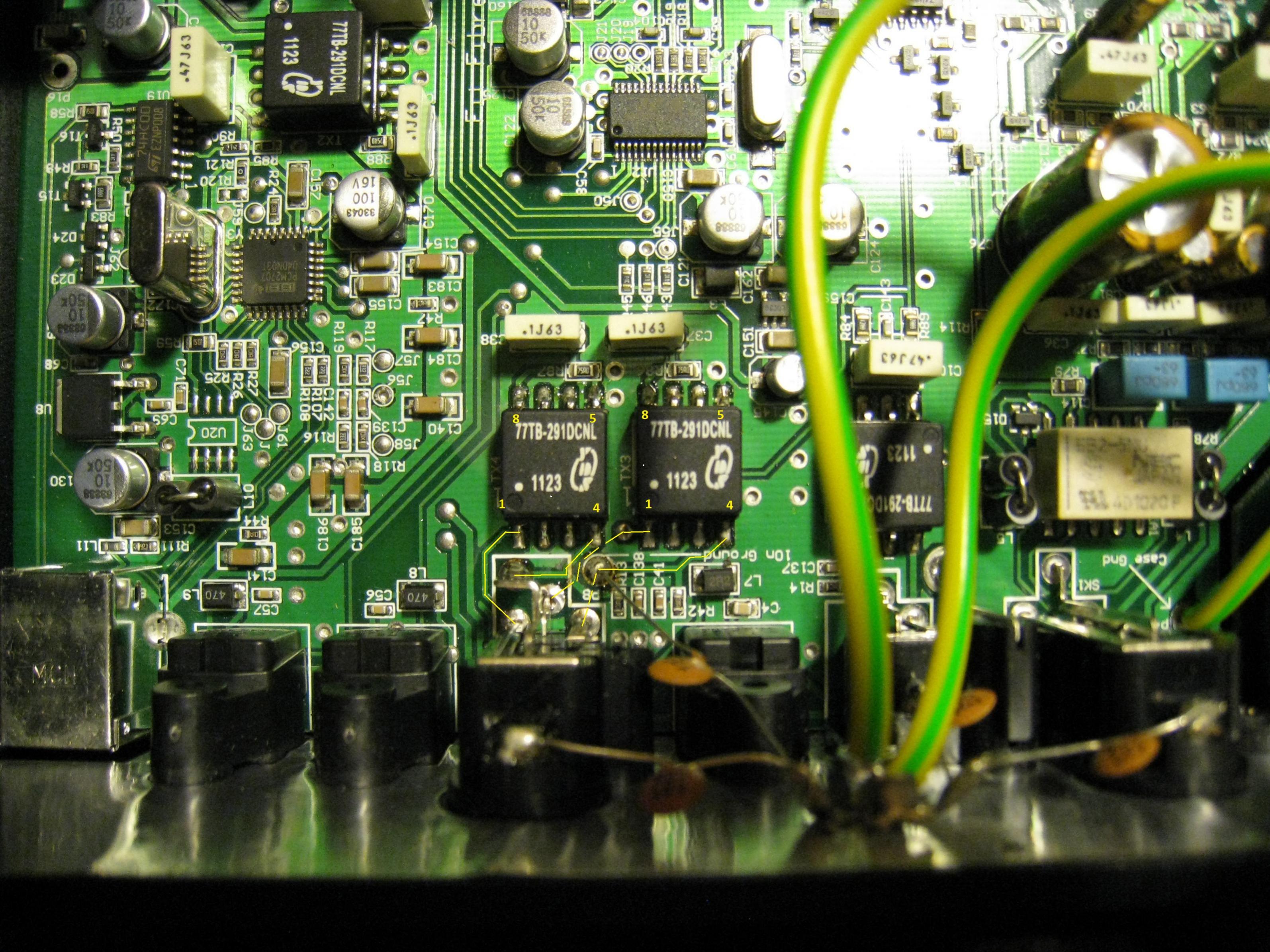

It looks to me as though there is no Resistor in series with the signal to the Left TX.
There is a 75 OHM Resistor in series with the O/P from Pin 8.
I have used a Yellow Line to indicate my thoughts on the route the signal takes to Pins 1 & 4 (I/P'S) to the Left TX.
The Dotted Yellow Lines are my guess as to how the signal is routed (underneath) to the Right TX. I presume this is Coax In 2 ? Do both not work?
It looks to me like Pins 5 & 8 are the O/P's, Pin 5 looks like it's 0 Volts.
The other components which can be seen attached to both Pins 5 of the TX's will be some Caps between Digital 0V and Main Circuit 0V.
P.
P.S. The Soldering on the RCA Socket looks very poor to me.

Hi all, Thanks a lot for the comments. I really appreciate.
Yes. Both coaxial inputs don't work.
I maybe wrong but the reason why I think the transformers are damaged is that they showed no connection between the 1 and 4 pins on the input side - both of them. I think pin 1 and 4 should show connection if it is not damaged.
When I connected the bracket in wrong direction, I think wrong voltage has been applied because on the connector pins on my computer PCB are 1. Ground, 2. SPDIF, 3. VCC. It should have been connected to 1 and 2 but I knew it was connected to 2 and 3 by an error.

Hi all, Sorry. I should have said “SPDIF output motherboard bracket. I was using only 2 pins for coaxial.
I’ve just checked continuity between the RCA and the transformers and it showed, despite poor soldering, the RCA and 1 and 4 pins of the transformers are connected. However, those 1 and 4 pins are not connected each other.
I also checked the pulse transformers linked to USB and found its 1 and 4 pins are connected. Thanks.

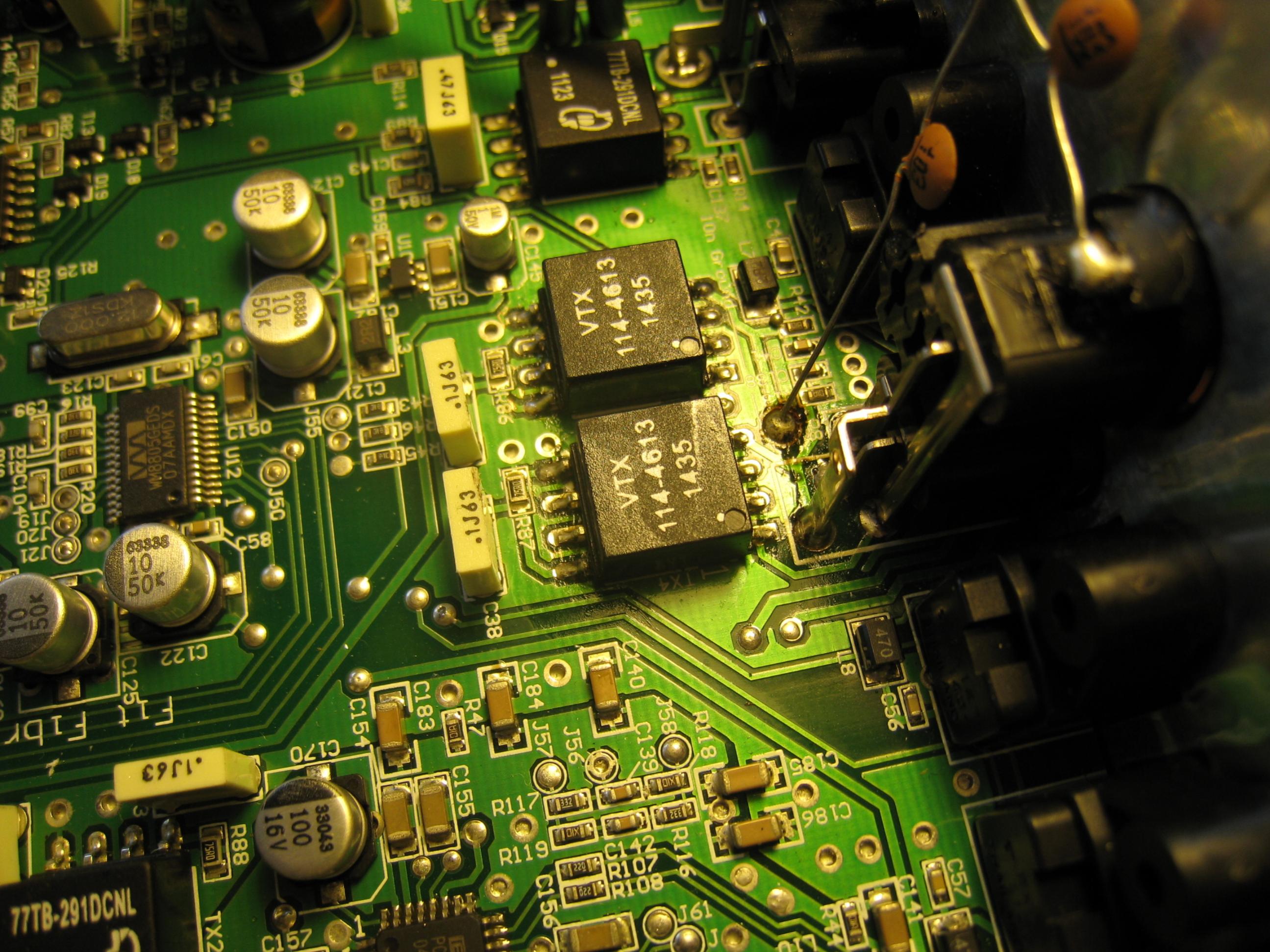

Hi all, Finally I have received the parts from Synergy Audio Visual (Australia Melbourne) and replaced the faulty pulse transformers. Although my soldering was not pretty, I now can use the coaxial input again. Thank you all for the advice – because I didn’t have any idea where to start at the beginning. By the way, the Chinese pulse transformer manufacturer has not replied to me since I told them I only need two (2) of them. I think they didn’t like the small quantity order. Fortunately Synergy Audio Visual (Rega distributor) ordered the parts for me at the cost of $40 ($15 x 2 plus $10 postage). They are different brand but cannot see any difference other than the brand.
