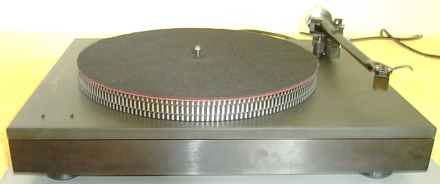

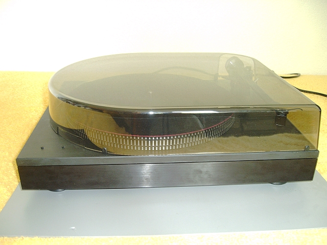

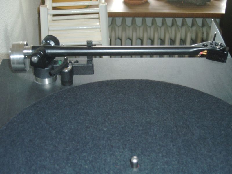

had my old Technics SL-3310, that I got from ebay for 15€, modified and set up with my Rega RB300, which I had laying around unused for years.

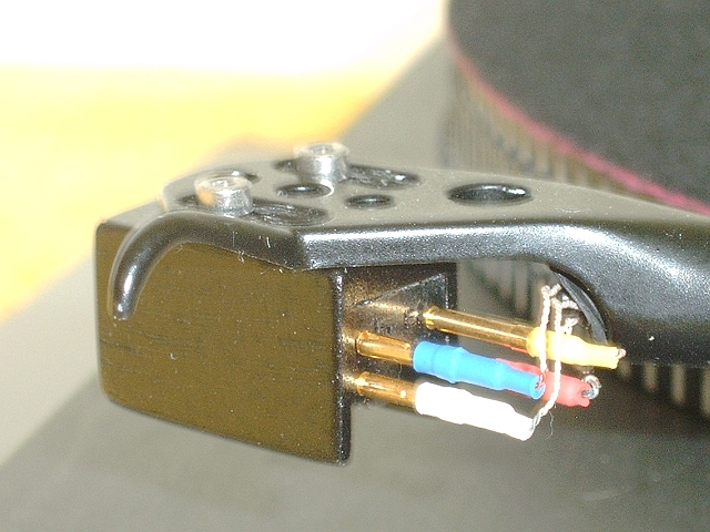

Modded the Rega with new internal wiring, which is made from silk-spun fine copper wire, 10*0.050mm. The wire were sent to me as free sample. Probabely could even have got silver wire, but since I´m a technical person I rather rely on practical reasoning than voodoo. 😎
Two strands were twisted together to achieve a low enough resistance, since the cabling should not reduce the output of low output MC pickups. So its a compromise between thinness and flexibility against signal transmission quality.
Each twisted wire pair got a pickup-pin connector type FK20SL-08V. This is a single female crimp contact, 0.8µm gold-plated, for AWG24-20, made by FCT.
I´m quite sure that it matches, probabely surpasses boutique-priced Cardas parts or similar in quality and handling.
The wires were soldered to the contacts and each of the four got a piece of differently coloured heatshrink tubing. The wires enter the Arm tube through the rubber grommit, which I resused. Within the arm tube the two wires of each channel are twisted together. The twisting results in less noise, especially with an differential input phono stage. Too, I run each channel through two straws, that separate and fix the wires. Maybe that this is a bit over, but I find it omehow weird, even amusing to see cabling tweaks with terribly expensive wires, that don´t take care of how the wires run through the arm zube itself. No consistency in noise- and impedance performance and channel separation, but the sound is of course always much better than ever 🙄
Since the tonearm is be mounted fixed, I run the wires to the putput connectors, which are unbalanced RCA and balanced Fisher connectors in parallel, so You can choose the cabling to the phono stage depending on the input of the phono stage. just leave the unused connectors open.

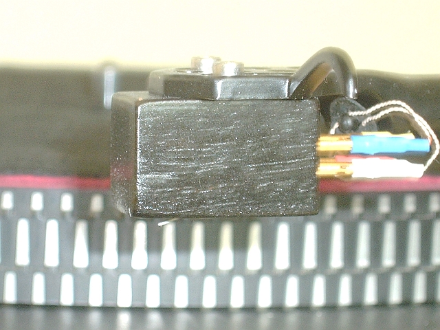

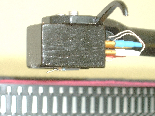

As pickup I run a modified Denon103 which I got as ´payment´ for a development. Unfortunately this pickup required a heavier counterweight.
Lucky me I made a deal with another DIYer, whom I helped in the design of his phono stage and who was able to turn a counterweight.

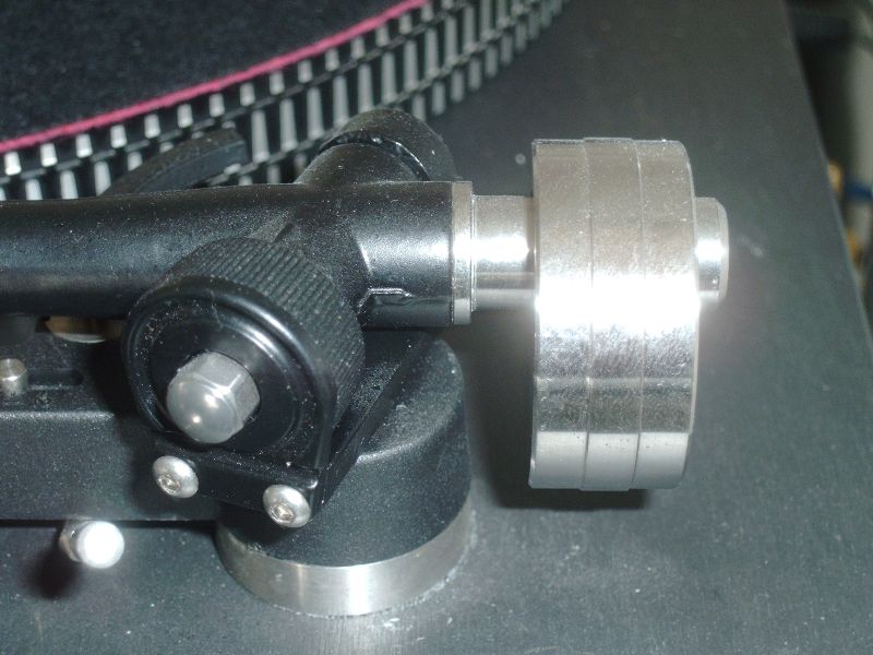

The counterweight weighs 133gr is turned from INOX steel, 40mm in OD and has a excentrical bore for the tonearm stub. I reused the O-rings of the original weight.
Last modifcation was the dampening of the tracking force spring with fine pieces of cotton batting.
And this is how it looks:
jauu
Calvin

The BLACK lead should be extended to the headshell (the missing' 5th wire).
However, the horror doesn't end with the tone-arm wiring.
Many cartridge manufacturers are also guilty of using a SIGNAL pin (usually a - pin) to connect the cartridge body casing to an imaginary ground instead of using the 'missing' 5th wire in the tone-arm. 😱![]()
The 'smarter' manufacturers make it easy to identify and correct their wiring error.
Example - see the source of imbalance on the GREEN signal pin, which should be disconnected from the GREEN pin and connected to the 'missing' 5th wire in the tone-arm.
Good Luck!
EDIT: Every tone-arm should present a minimum of 5 x wires at the headshell (4 x SIGNAL leads + GROUND lead).
Looks like I got some work to do on my tonearm. Question, if I disconnect the ground from the left channel and don't reconnect the black wire 9just because I'm lazy) what happens?
