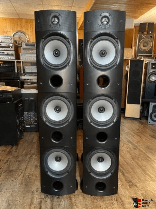

Refurbishing PSB Image 6Ts - sanity check!

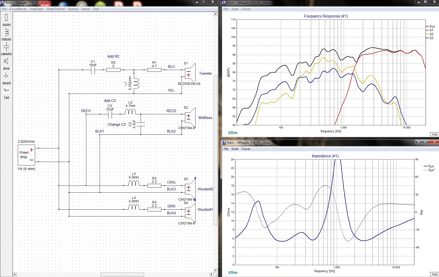

So I used Jaycar CW2194 6.5" (8Ω) drivers instead for each of the originals. I did find exact replacements for the original tweeters, using Tymphany Peerless BC25SC08-04 1" units (at 4Ω) which I ordered from the US. For completeness, this is the plan of the circuit I used:

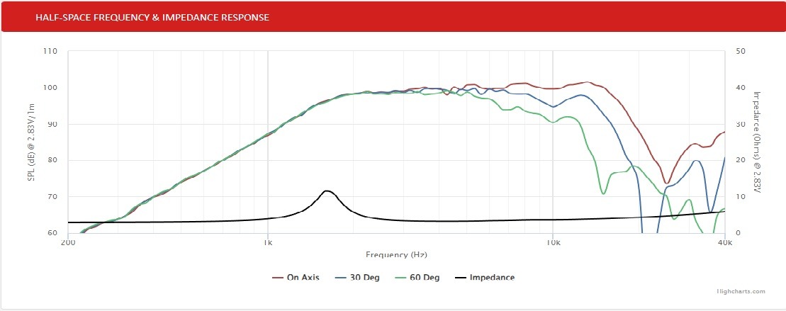

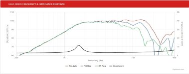

I updated the Xsim model (v6) using the drivers you installed, and the XO as modified. Both drivers only had graphs, that were digitized (via PlotDigitizer) to produced the FRD and ZMA files. A bafflestep curve was also added to the sim as well. The tweeter is horn loaded and is much more sensitive than the driver used in the previous sim. The woofer has an unusual curve, its bumpy, and the LF roll off starts at a fairly high freq.. I did not include port tuning effects on this sim. The good news is that your ears are correct, this speaker is too bright and lacks bass as evident in the upward sloping system FR. It can also be made better. I've attached the design files and a few graphs.
It would be preferred if you were able to measure the speaker "as is" to see if this curve matches the sim. A measurement would confirm the XO mods and provide a better baseline for the next XO tweak.

Don this is exceptional work. I really appreciate the time you've taken to model the speakers. I'll need to study the graphs further to understand them, but it looks like things start falling off below about 200Hz, would that be right? If so, I think this would accord with what I heard the last time I experienced them, where, in one sound clip, the bass seemed to "sheer off" into nothing, like the driver hit a lower limit and wouldn't respond below that floor. It's reassuring to know that my ears are hearing things acceptably! 🙂

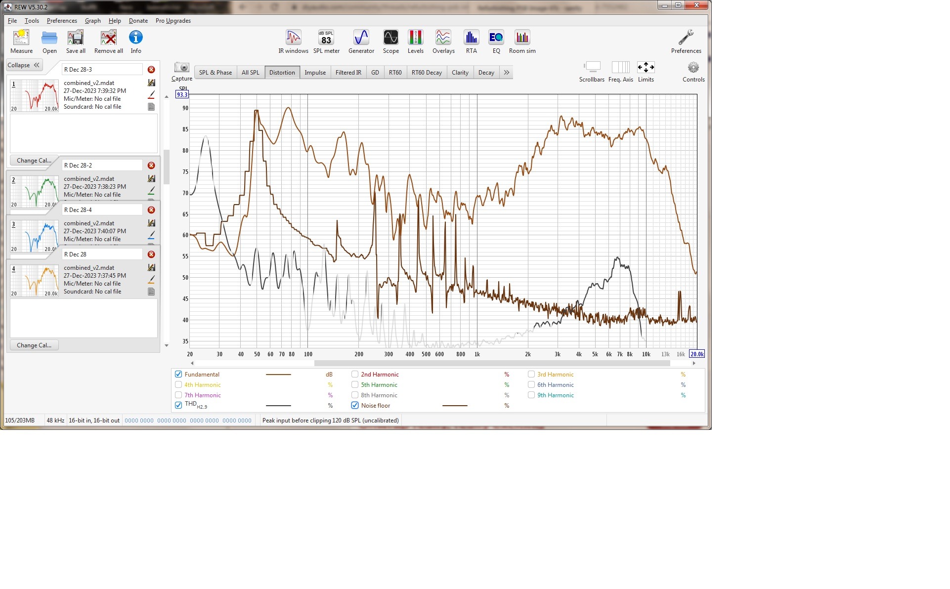

OK, at last I have completed the REW measurements. I calibrated everything first, then took four measurements with a USB microphone. The first three measurements were 0 degrees from centre axis (i.e., between both speakers), about 2m back, and the fourth about 2.5m back (roughly). It was my first ever measurement, and I hope I did it correctly!

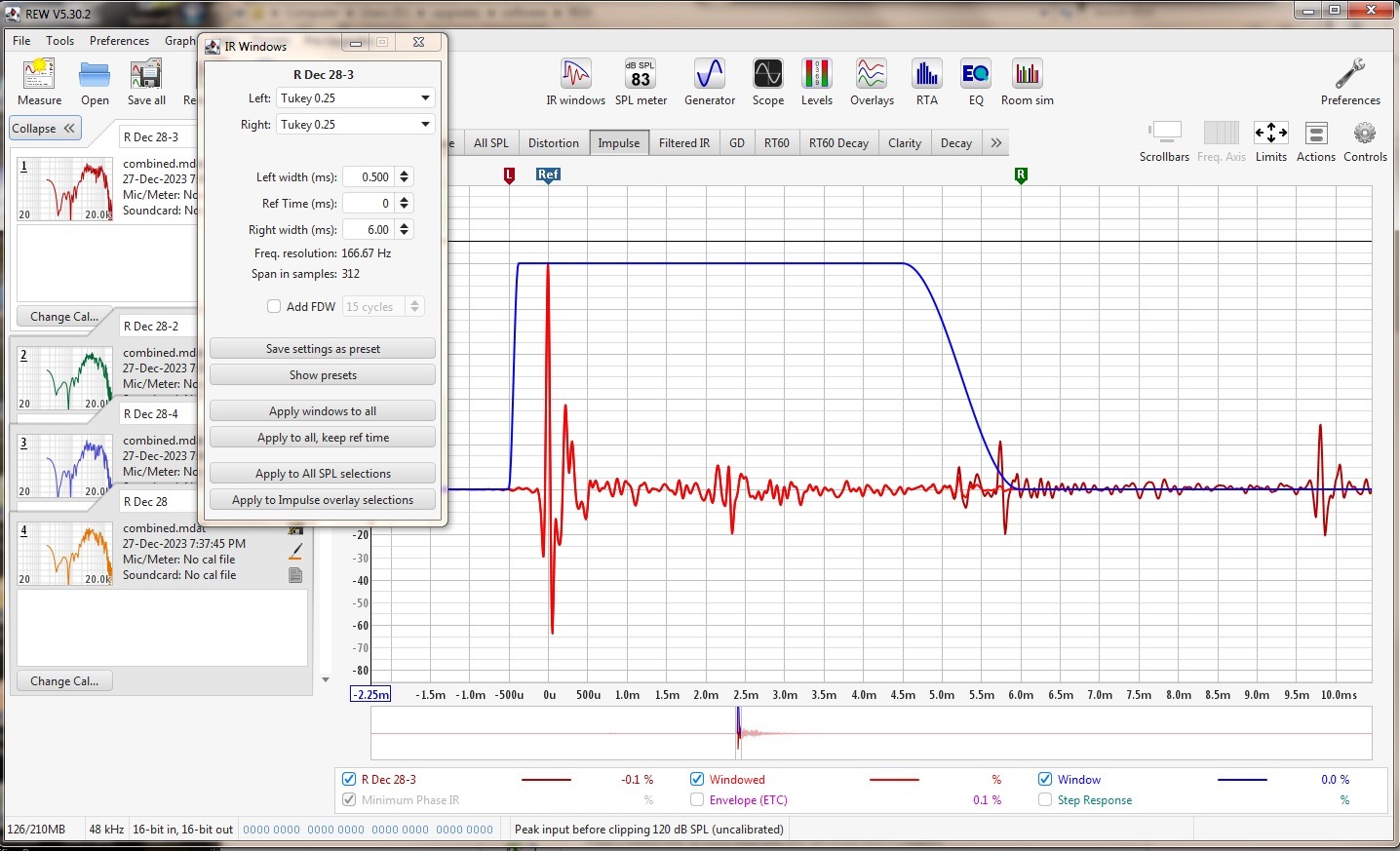

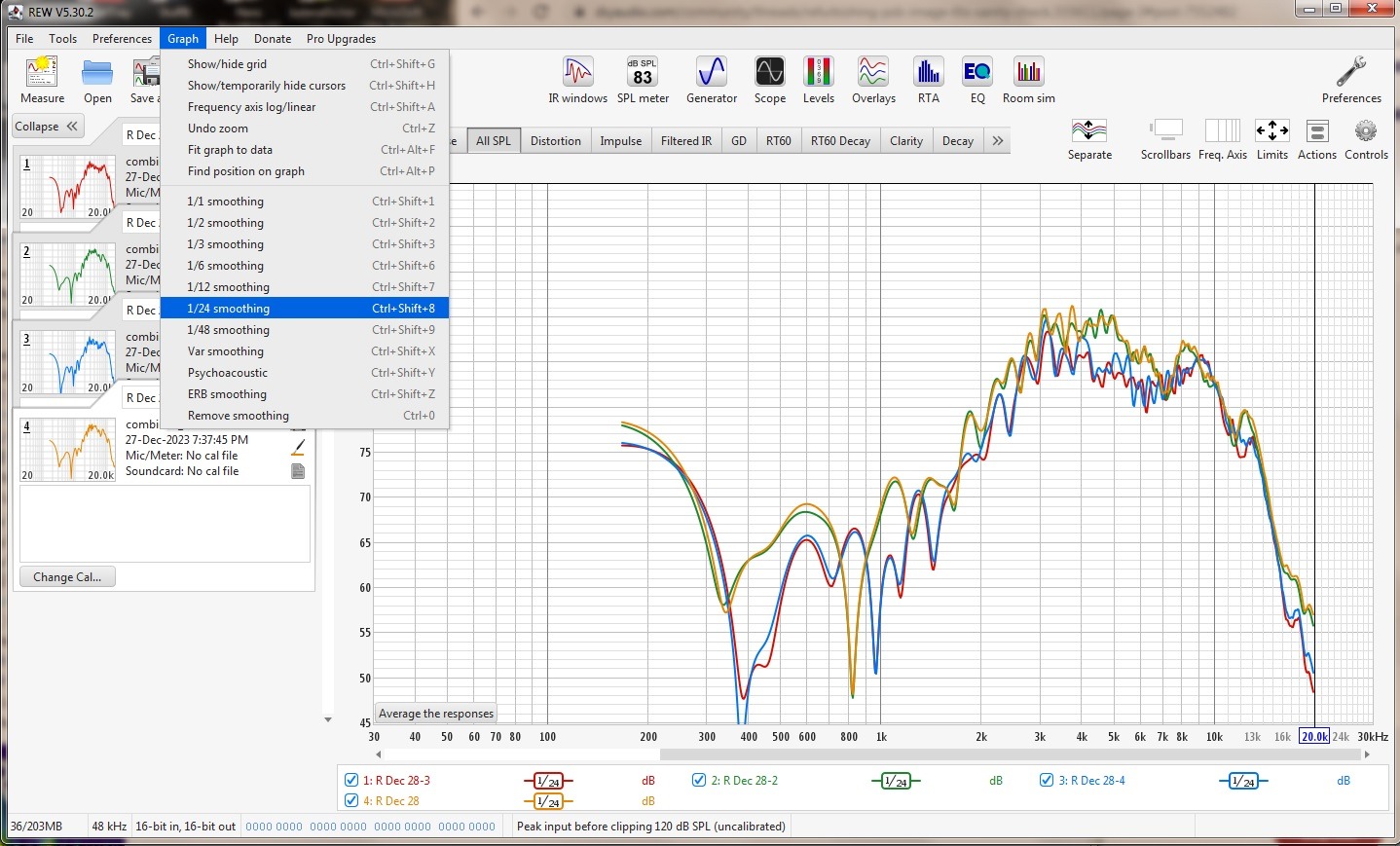

Some interpretation of the data provided (I used REW 5.30.2). All the plots show the same issues. What USB mic? and did it have a cal file?
The REW data needs to be windowed to remove boundary reflections from the measurement. The "IR windowed" plots show the primary event [ t=0 to 0.5ms ] and secondary events at [ t = 2ms, 5.5ms, 9.5ms ] caused by reflections. Setting the IR window to 6ms will remove most of these reflections from the measurement. Not obvious here, but the longer the window, the lower the measured freq. There is a practical window limit of course, based on the room size and furniture. Lower freqs can also be measured using nearfield if needed. Sound travels approx 1m in 3ms so you can ballpark where those reflections are coming from and adjust placement or window them out.
The data always contains some noise and that can be reduced using windowing, then smoothing to help see the fundamental issues a bit more clearly. The "SPL windowed and smoothed" graph shows the mid bass sag and the high output from the horn tweeter.
The midbass sag problem is also evident in the "THD and Noise" plot. There could be a number of issues causing this, like, XO wiring problem, reversed midrange driver, unintended HT amp processing, unintended PC soundcard processing, etc. The tweeter section looks like its working OK but the sensitivity will need to be attenuated to the level of the woofers+midrange when they're fixed.

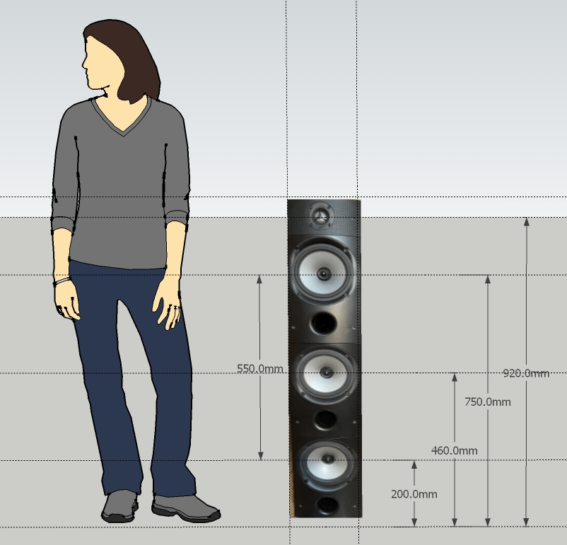

Can only get rough estimate.
But visually Center to Center for top and bottom 6.5"
close to 550mm
So depending on crossover wouldn't expect
it to do much else than
cancel upper response of the 6.5"
So lower woofer needs to crossed very low.
Would very much be connected to the largest
inductor on that low frequency board.
Otherwise it would cancel all the upper range
of the midrange 6.5" mounted a zillion miles
away.
Or from the response looks like a phase cancellation
so polarity might be wrong on the second woofer
up or the high mounted midrange.
