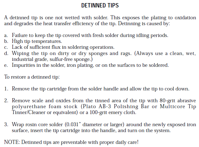

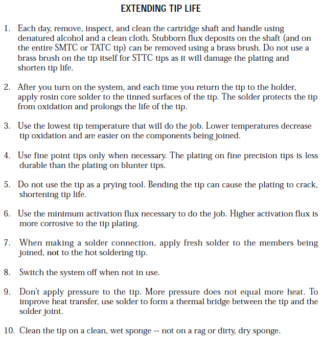

Hi
I find the main reason solder iron tips go off either by gaining a coating or by lose their original coating is because solder is applied to the soldeing iron instead of to the part to be soldered.
If the tip becomes dirty I use a solder bath. This is easily formed. Initially use a few turns of solder in a small tin lid and then add any waste bits of solder to the tin to help build up a larger amount.
I find it best not to use a wet spong or sand the tip as I find that both do cause some damage. Cleaning in a solder bath or cleaning the soldering iron tip in brass wire does not seem to cause any damage.
