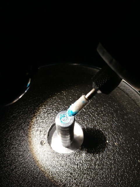

I noticed my turntable was starting to experience some speed issues - notably wow that could be heard on piano note decay and other long drawn out tones. I opened up the bearing and noted that mine had the dimple on the thrust plate and also my ball had several spots of corrosion or rust of some kind, so I figured it was time for a change.
I reached out to Max Townshend and he provided me with the document I mentioned above, so I proceeded to acquire all the components for the three step process. There ended up being a slight problem with his advised methodology: it didn't work at all. For one, the thrust plate (about 1/4 inch in diameter) on my turntable was sunken into the tip of the bearing about one millimeter deep, so running a file over the top to remove the dimple was impossible. Secondly, the plate is made of tungsten carbide, so the 1200 grit sandpaper and the Autosol polish simply dodn't work on it because the material is too hard. I noticed that the thrust pad just looked worse after I attempted to run the sandpaper over it because the aluminum rod I was using was scoring the material through the sandpaper. I asked a machinist and he said tungsten material moves around easier than the material being removed, so scratches show up but the sandpaper does nothing. Hours spent using the Autosol yielded no results.
Frustrated that the manufacturer instructions had failed me, I started to research how to polish tungsten carbide. There is so little information online I was afraid it was impossible, but what did keep popping up was diamond lapping pastes. I ordered a 7 piece set of mirror finish diamond lapping pastes from Amazon that began at 5 micron and went all the way up to .25 micron. Since Max's document recommended 1200 grit sandpaper for smoothing, I checked a comparison chart and decided to order an additional container of lapping paste that was 14 micron - the equivalent of 1500 grit sandpaper. I hoped this would work for the initial material removal since it was closer to the 5 micron starting point of the other pastes. I also ordered a set of 100 felt polishing tips for my Dremel tool.
This combination worked. Using the 14 micron paste on the dremel polishing tip I was able to remove the dimple in the thrust plate, and also all of the scoring damage that I had caused trying to use the sandpaper. After I finished with each grade of paste I would clean the thrust plate and surrounding area with white mineral spirits. I would then start with a new dremel tip and work on the plate with the next grade of lapping paste, going all the way up to .25 micron. At 1 micron the mirror finish was already evident. At the end, I had a thrust plate that looked as good as new.
I had ordered a tungsten carbide ball to replace the rusted steel one, Max Townshend told me it would work fine, although I'm not sure if I should trust that because now I have a super hard material rubbing against itself in the bearing. Regardless, once this process was done, I recharged the bearing fluid, dropped the subplatter on top, and hooked it up. What a marked improvement in sound - so much cleaner. The long tones don't wobble any more, and everything sounds so much better. It was hard work, but I'm glad I did it!
I hope that is helpful - I'm not sure if other turntables run into this issue, but I'm happy to answer any questions!
The attached picture is of one of the stages of lapping paste being applied with the dremel tip.
Here are the pictures I mention in the previous post - one of the inverted bearing where you can see the thrust plate sunken at the top, and the other with the thrust plate covered in diamond lapping paste.

Thrust plate
If I understand this the thrust plate you are lapping is at the top of the tower in the picture over which the platter and ball bearing fit?
