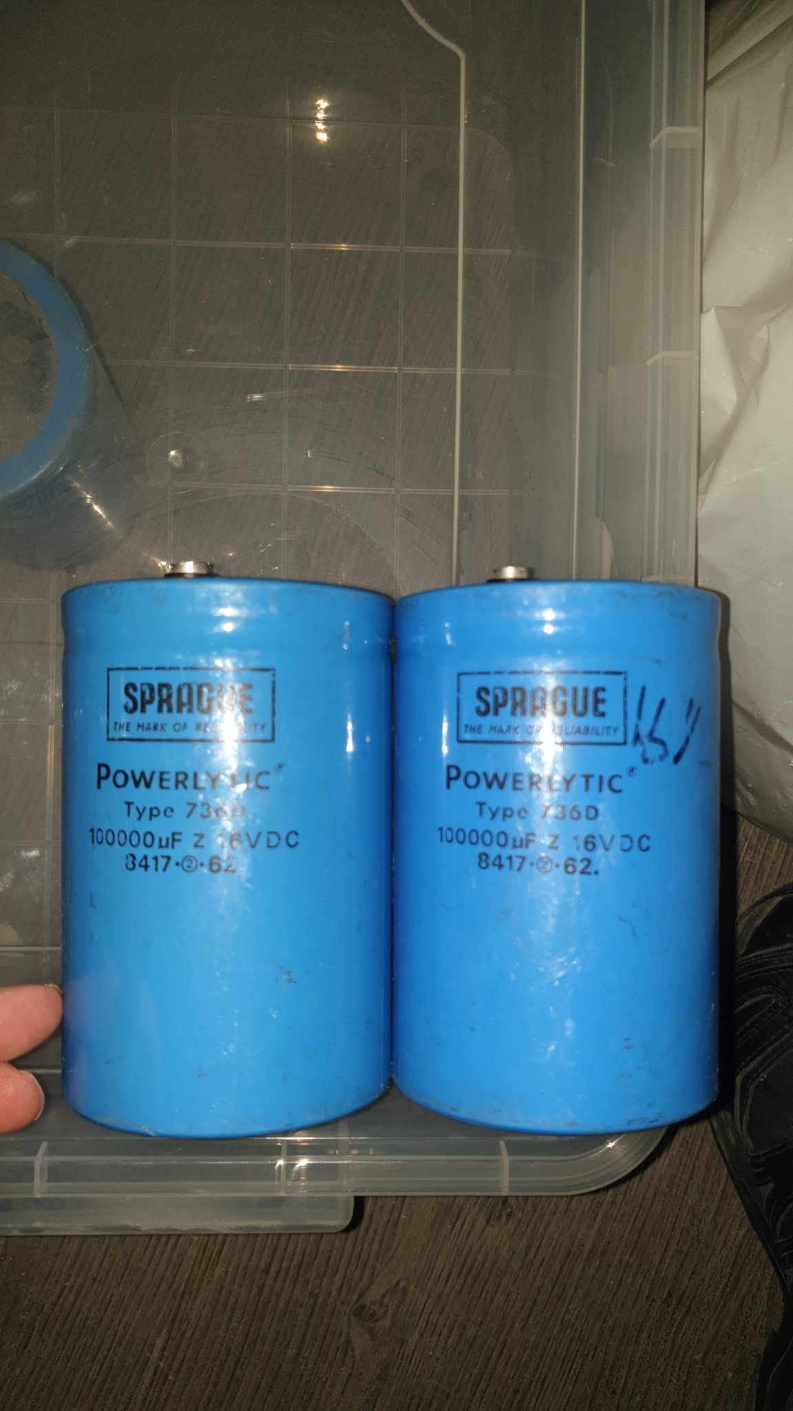

Hi. I found a pair of 1984 model Sprague capacitors in my storehouse. They show about 0.05-0.08ohms esr and 99k-101k capacity.It seems good but what about performance? I want to use them for an amplifier. Can I drill a little hole on top plastic cover, fill some boric acid and maybe it improve performance ? I watched this video .

Actually, yes. And it won't work. Nothing against experiments - that's how best to learn after all - but I would find something different to try.
And, for what it's worth, those capacitors are probably perfectly fine. The ESR and value are great - the only issue would be with leakage and those Sprague 736Ds won't be used anywhere that would matter. They are low frequency bulk filters and, used as such, would probably last another 20 or 30 years.

Thanks for the answer. When i shake them one of them make sound (i think wrapped roll hits somewhere ) Is it because of being dry?
If it's doing that than just ignore everything that I just said. You are correct, it has dried out - I'm just very surprised that the capacitance value hasn't changed as that would be expected. Those would have been used as filters for probably a 5V rail which would have had high ripple currents - which would explain them drying out. Still, very unusual for the value and ESR not to have gone out of spec, though.
Reactions: umut1001
No, it is not because it is dry. It may be some loose debris from manufacturing, rattling in the void between the seal and the bulk of the armature. As you can guess by the abnormally big size compared to the capacitance value, those Sprague capacitors aren't built like today mainstream electrolytic capacitors. They were very expensive long-life parts. I have some of them built in the '60 that still works perfectly fine, like yours. They don't like high temperatures, this is another major limitation beside the size and price compared to modern high quality capacitors. They are vintage parts afterall, I use them for restorations only.
