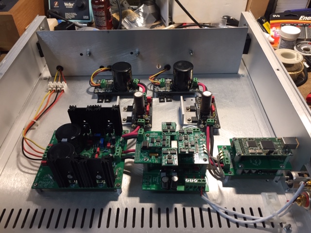

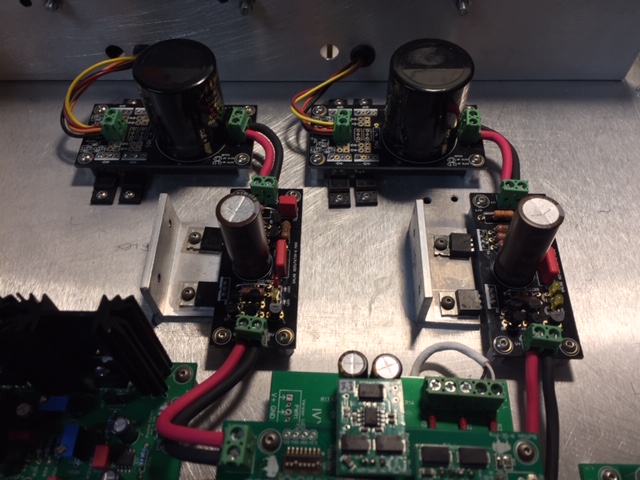

I have a couple of 'generic digital' power supply bases with 9 rails on each. 4 of these rails are the DAC and digital processing (isolators, reclockers, etc) supplies. On this base, those supplies are based on 2 Hammond 220D16 transformers, with one secondary used per supply. The secondary feeds a diode bridge of DSEP30-06A diodes (overkill, but in my experience good sounding) and the output C of each supply is a Jensen 47000/25V 4-pole capacitor. I also include a John Swenson transformer-ringing suppression snubber on each secondary (more info on that here: Good linear PSU(s) for CAPS music player that won't break the bank - Page 12 - Music Servers - Audiophile Style ).
All of these come together at a 16-pin Hirose connector which allows me to plug and play various digital sources.
Each 'base' also has a supply with a 5V and a 3.3V rail for a source (RaspberryPi, SDCard player, or similar), a lightly-filtered quick-drop-out supply for an on-off mute relay, and an output stage supply with a +-21V output where needed.
For the Allo.com Katana, I use just 2 of the DAC/digital processing rails. Sonics are slightly better if I use one rail from each transformer.

Thanks, I used 14 AWG stranded. Any bigger and it was going to be tough getting them in placeNice arrangement and thick cables
