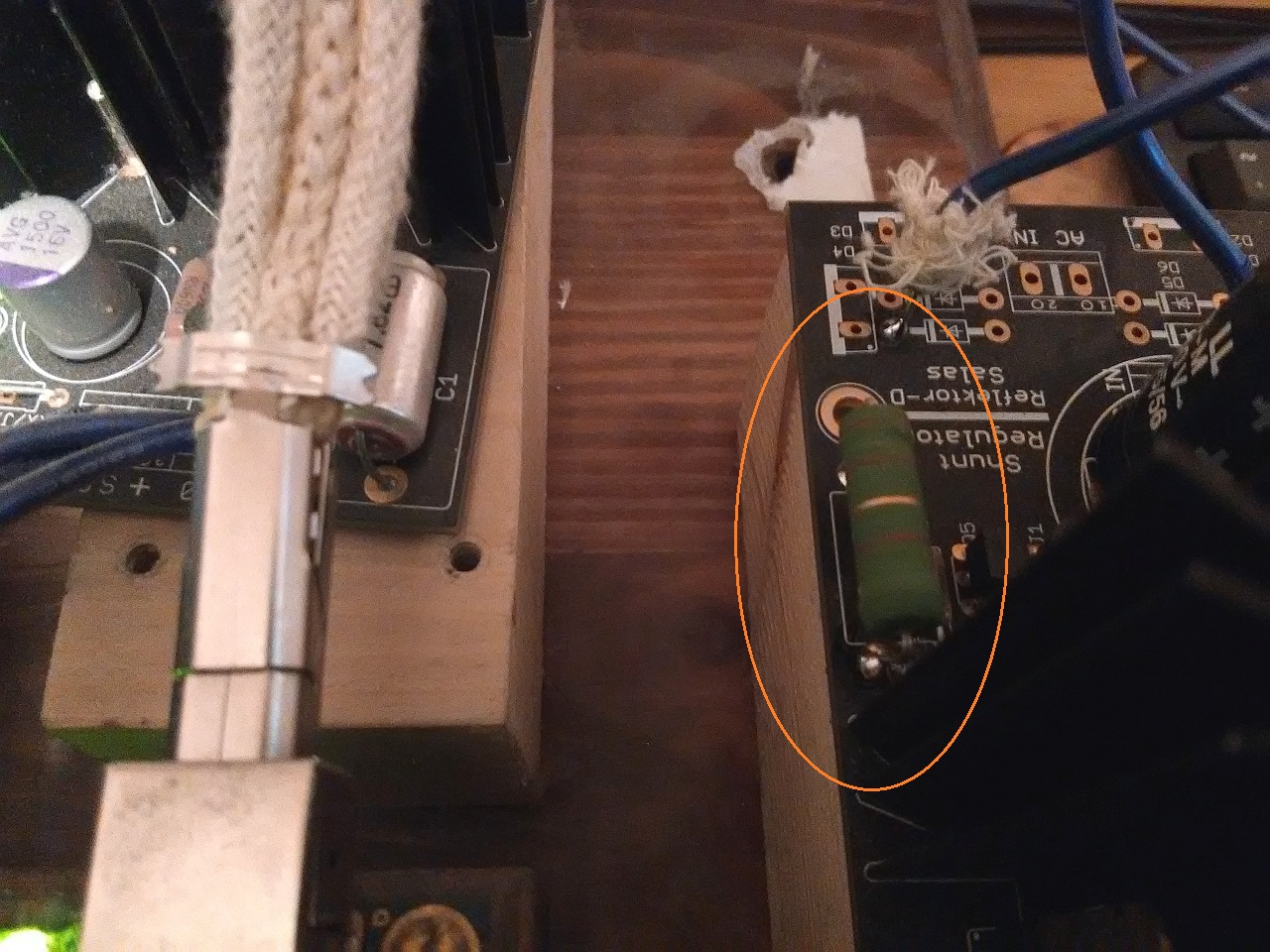

Two reflector-D's shoe-horned into my DAC case. They're fed 9v ac from an r-core transformer in another box. One is set to 5v which powers my digital buffer board. The other one is set to 7v and powers my DAC main board only - there's a separate supply going to the DAC board. In the pic they're being tested but I've now got them powered up and connected to my kit.
Next time I'll make a note of the PCB dimensions and order the mini versions 🙂.
Thanks for a very easy build Salas - even for my inexperienced hands these were easy to assemble.
IMG_6717 by James Lines, on Flickr
The minis won't work from AC though. A thing to remember in the next floor plan. Anyway after closing the lid on your build all systems will work the same no matter if at an angle or not. Nice to know they did not give you trouble and I hope they give you nice sonics 🙂
