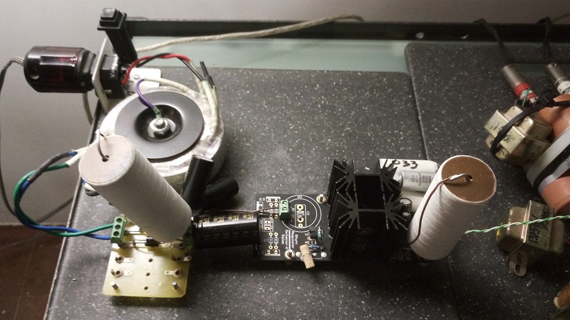

I will try paste a picture how it looks the result, but only link to open next page available.
Power transformer is 15v.
I use a zener to output 8v./50mA. Still waiting to receive the LM329.
Temperature on radiators is 50ºC
Resistor R1 is 3R2 handwound isotan wire.
