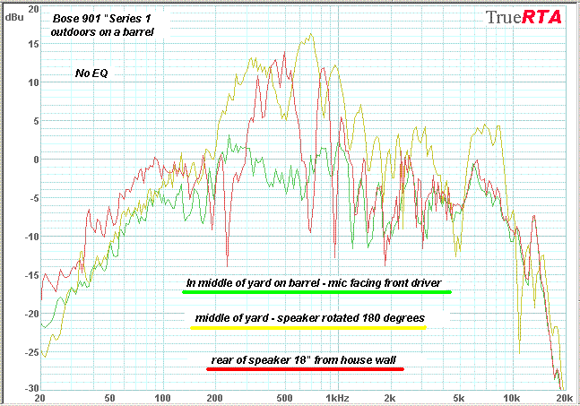

Here's my 901-1 outdoors - one driver - 8 driver - 8 near wall- no
Eq. IIRC Bose referenced Karlson's "Aural Optics" patent.
Interesting, but that’s not how they are supposed to be used. Which brings up the question of how does one go about measuring such a loudspeaker? Omni mic in an upper-middle class living room I guess? Simply blasting midrange everywhere doesn’t work as well as blasting it off the 1980’s paneling?
