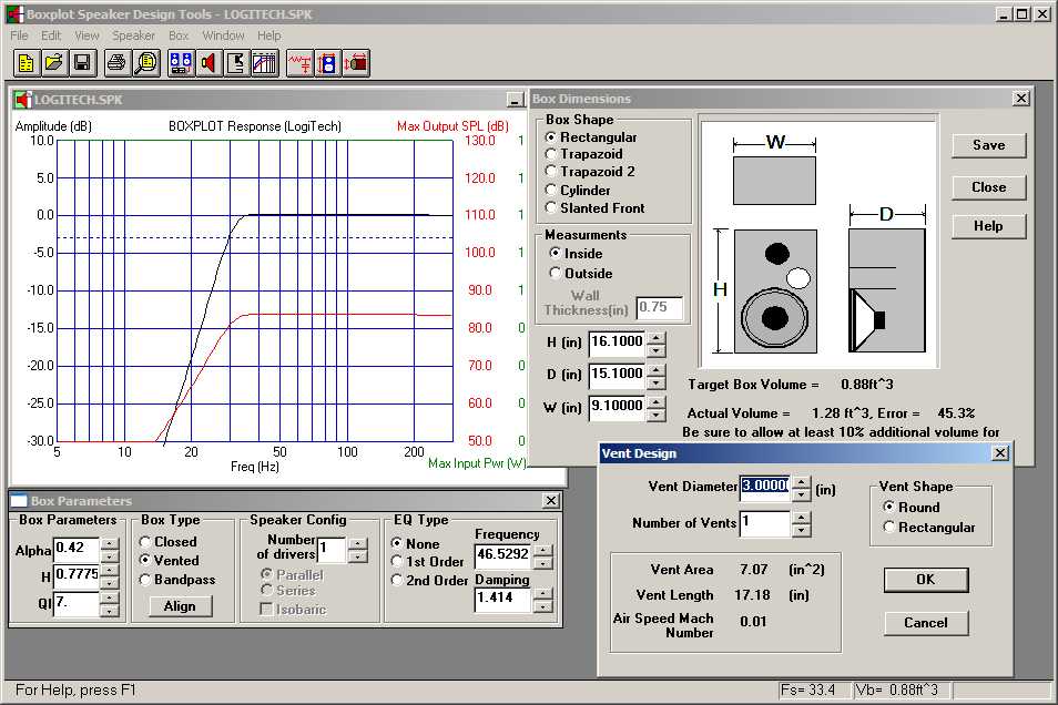

Hi erik1971,
Here is the Boxplot output for your speaker in a box with your dimensions, vented w/ 3"Dia. Port.
wow... that looks pretty impressive... but I have no clue what that means. It is bedtime in Europe, so Iam gonna take a good night sleep and study it in the morning. If Iam not able to figure out what it means I will get back 🙂 Thanks a lot for the effort!
Erik

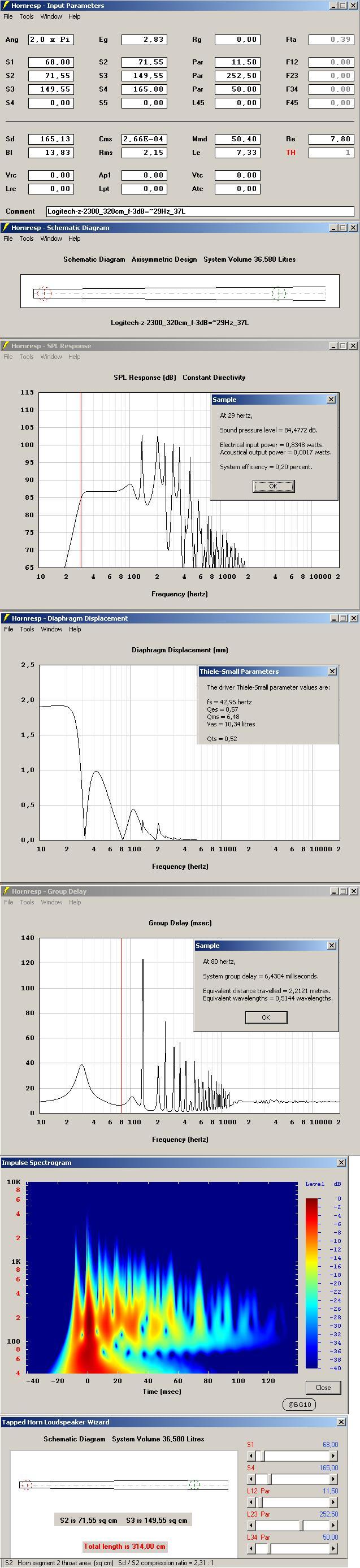

Hi Eric,
Why not build a multi-folded TH using 0.5" Ply (using the driver specs here-above):
b🙂
