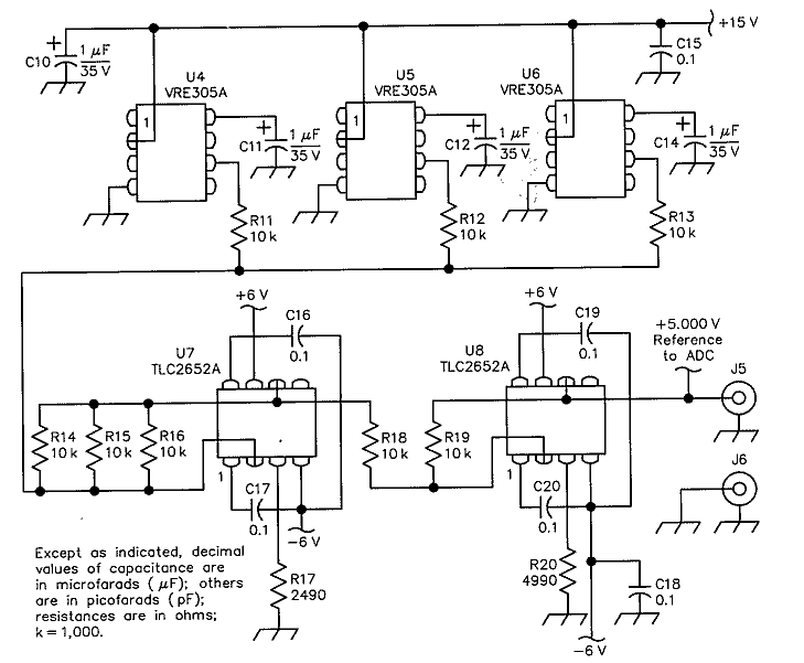

if you need really, really low noise you can put 4 references in parallel --there was an application of this in Sep/Oct 2001 QEX in which 3 Thaler VRE305A references and chopper amplifiers were used to create an ultra low noise ref for a DVM --
Maxim has an application note where they use 4 voltage references in series, sum the outputs and divide.
