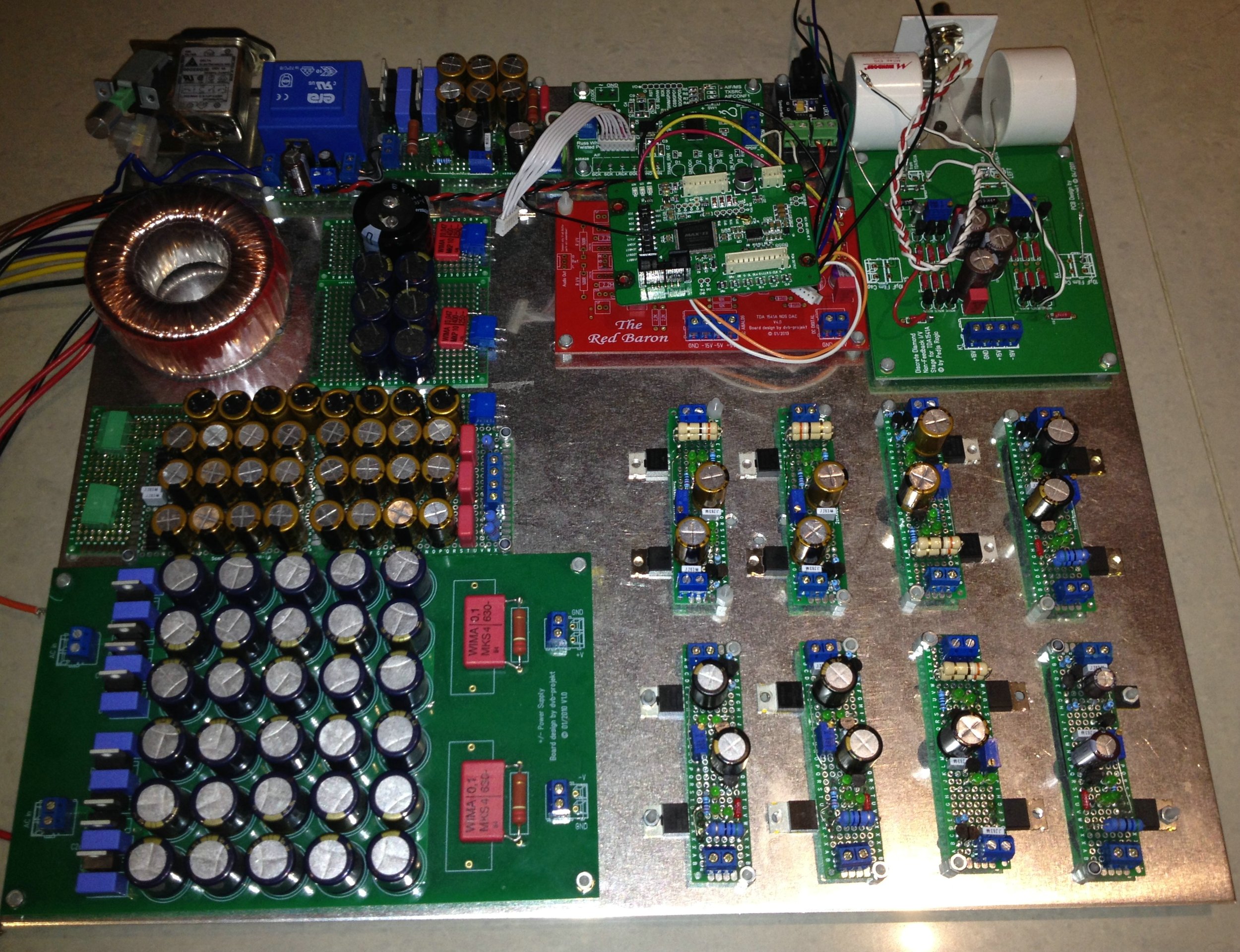

Sure, here are few pics.
DTSES
We never heard if you felt better about it after it settled in a bit. I would think 50 hrs might open it up quite a bit.
Your work is nice and neat. A lot of work has gone into it. As an arm chair quaterback, I wonder if your physical layout is contributing to lack luster sound.
You end up with pretty long runs from shunts to consumers. I have heard people say if you can't get down to a couple inches, really not much value in the shunt.
Also, the I2S runs are pretty long. I wonder if you just re arranged a bit. By rotating the board that feeds the red baron and sliding it into the place of the red baron you could achieve short I2S signals and short power cables from your shunts. Just a thought.
Thanks for advice!
Currently I' working on layout and 4 additional Salas shunts for Ians board and output stage. Also customized toroid with 8 separated windings will be installed. Each line outputs 200mA of current, so I'll set the shunts at 100-120mA each for proper operating conditions. Didn't know about the short wiring here, thanks!
Anyway, the dac is not bad for sure, perhaps just my expectations were quite high due to amount of work and time I spent with it. I think that new additions will bring it to another level. I'll post some pics later.

could you please comment on the layout below?
- There are 9 Salas shunts in total, some of them will still have a bit long connection from both sides.
- Ian's PCM board will be placed on top of DAC board
- Will use ipx mini coax cables to connect spdif module to PCM board
- PCM and DAC boards will be hard soldered, 2-3cm cables will go directly to TDA chip.

Hi dtses,
You must have ground returns as close as possible to all your I2S lines to the dac or you will have a high impedance on the signal resulting in trigger uncertainty which will give you high amounts of jitter.
I wouldn't be surprised that if you fix this alone the sound quality will improve significantly. Although it must be executed correctly for the best results. Even if you just try twisting a separate ground around each I2S line, it would be better than nothing.

Looks much better. Most suggest that the 15V PS to TDA is most critical, so perhaps ensure that this salas shunt has the premium position for short cable.
