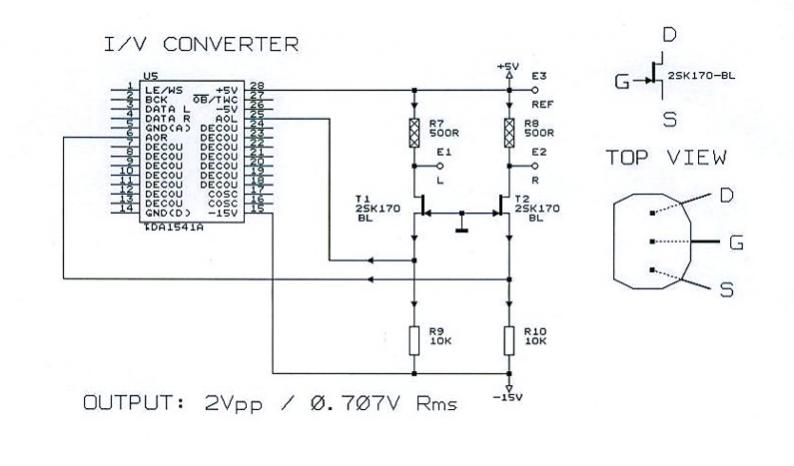

Will my DC coupled B1 buffer powered by a Salas shunt reg work as an output stage? It is a unity gain, impedance correcting buffer based on 2SK170s. It would be positioned in the pre-amp, the next box down from the DAC in my system.
If so, what do I really need to build a DAC with USB and optical inputs?
1. A teralink converter,
2. A Power supply board,
3. Main Shunt reg board
4. DAC module board
Is that it, discounting box, components etc.?
Many thanks
Lucas
Hi Lucas,
i am building the DCB1 blue version at the moment :)
Additional you need an I/V output stage e.g. like my Tube-I-zator module or the new I/V stage from ecdesigns (see attached picture). The DCB1 comes after this stage.
So you need:
2x +/- Power Supply Modules (+5V, -5V, -15V)
1x TDA1541A shunt module
1x I/V output stage
1x Teralink X2 module (only USB input)
1x SPDIF to I2S module e.g. from Twisted Pear Audio with additional Toslink module
Best regards,
Oliver

Do you mean that I need 2 of your power supply boards, or does one board contain both?
I'm assembling parts for this design pending arrival of the PCBs but can't readily source the Kiwame 220K, 5W resistors. I can get 200R and 240R. Would either be an acceptable substitute?
Neither can I find and 270uF 16VW Sanyo OsCon caps. Can anyone recommend a UK distributor without the usual min. order penalties?
Apologies for any trouble and thanks in advance . . .
Joined 2009
You could use any 5W resistor with a value around 220K for the bleeder resistor.
If you use a smaller value, the caps discharge a bit quicker if you power off.
Hificollective have the 200K and 240K in stock.
