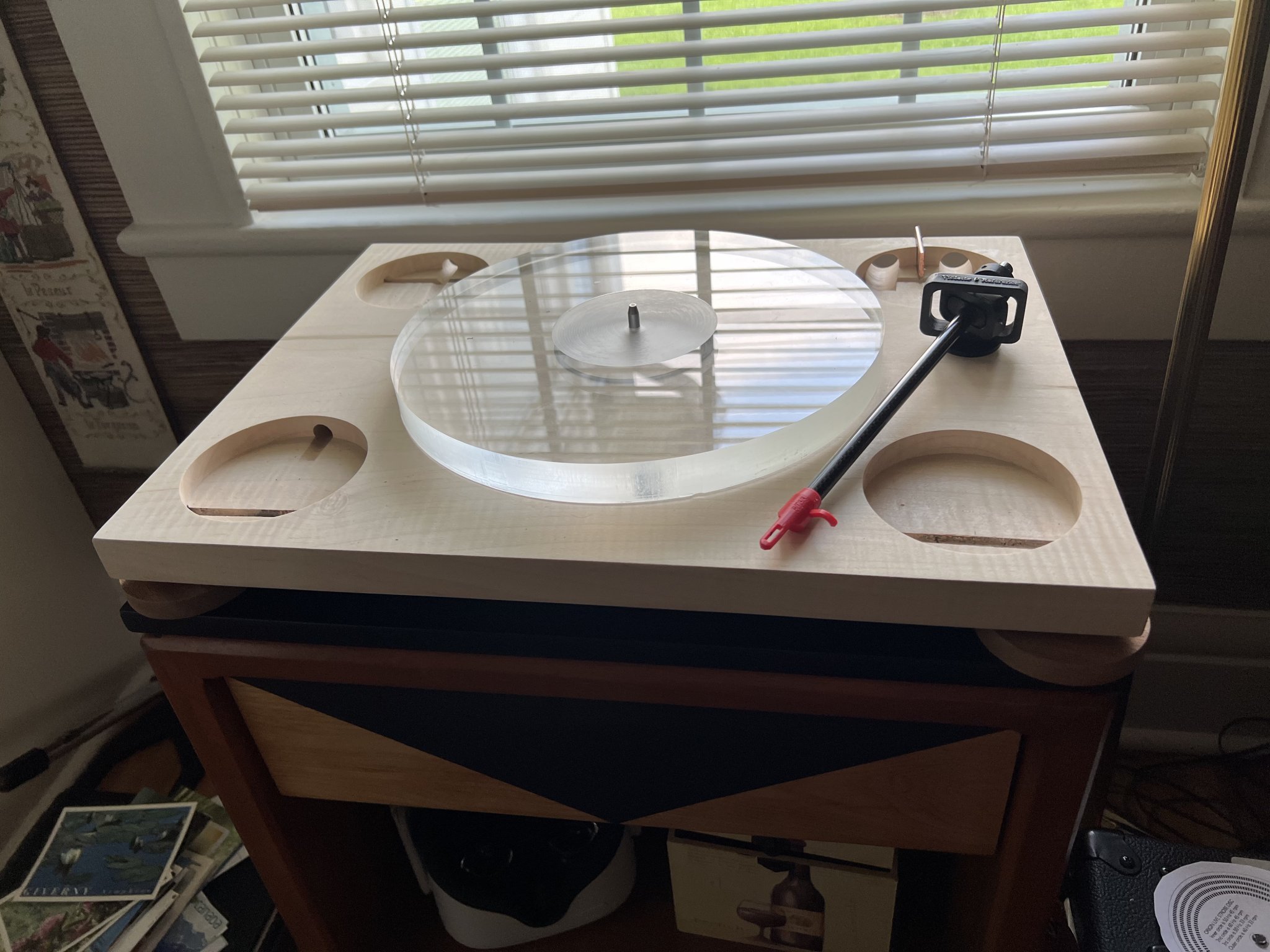

I am a woodworker, guitar builder (@violette.guitars) and all around electronics and music geek. I have started this build of a turntable for my vinyl collection I have had since I was a teenager (and some new ones).

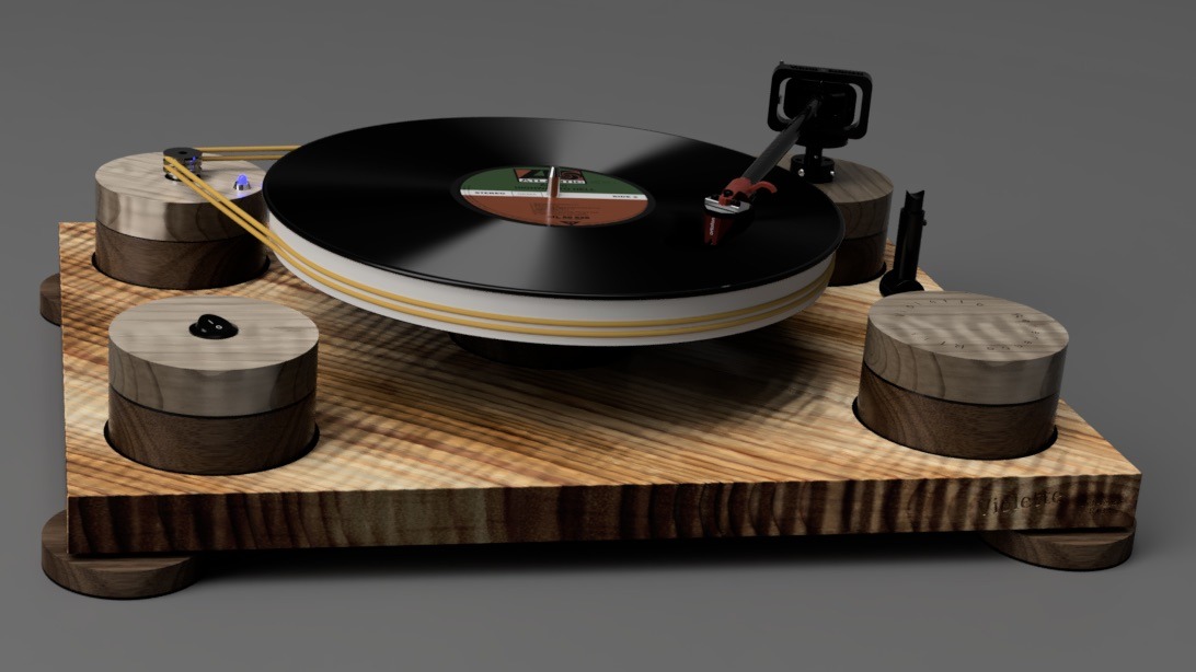

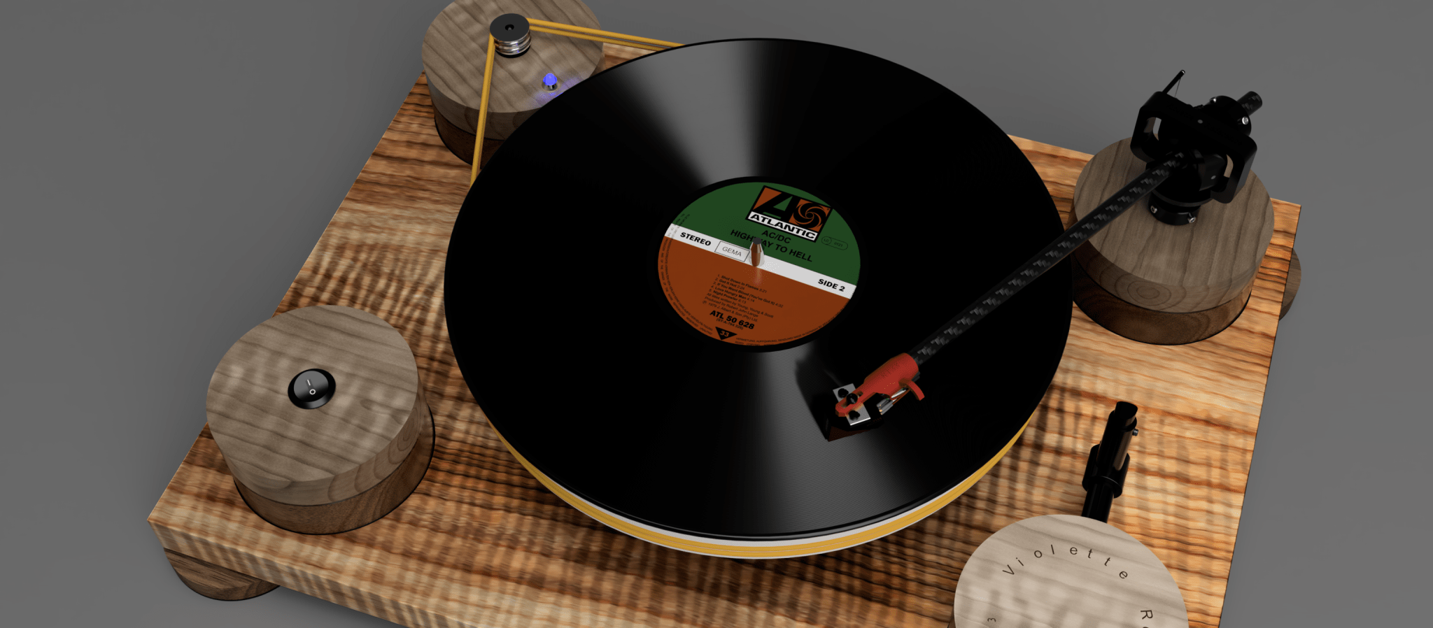

I started to design a turntable project in fusion. Basically building everything (plinth, platter, motor, tonearm, electronics) from scratch - all except the cartridge. Here is the design I made in Fusion360. And a shot of my current status (plinth, most tonearm parts, platter).
Let me know if this interests people and I will post build shots as I go along. Note I am slow as I have other full time work. It's taken me since spring to design and get to this point. The inspiration was the marriage of fine woodworking and tone woods (mahogany and maple) with an organic look and feel, although marriage with hifi technologies and techniques to isolate the resonant wood from the mechanics of a vinyl turntable player.

- dual belt drive
- 33.3 rpm only
- wood plinth and "pods" and isolation with neoprene
- acrylic platter ~ 5lbs
- regulated circuit for motor
- carbon fibre tonearm tube
- neutrik RCA output jacks
- copper bus ground bar
- all parts custom designed

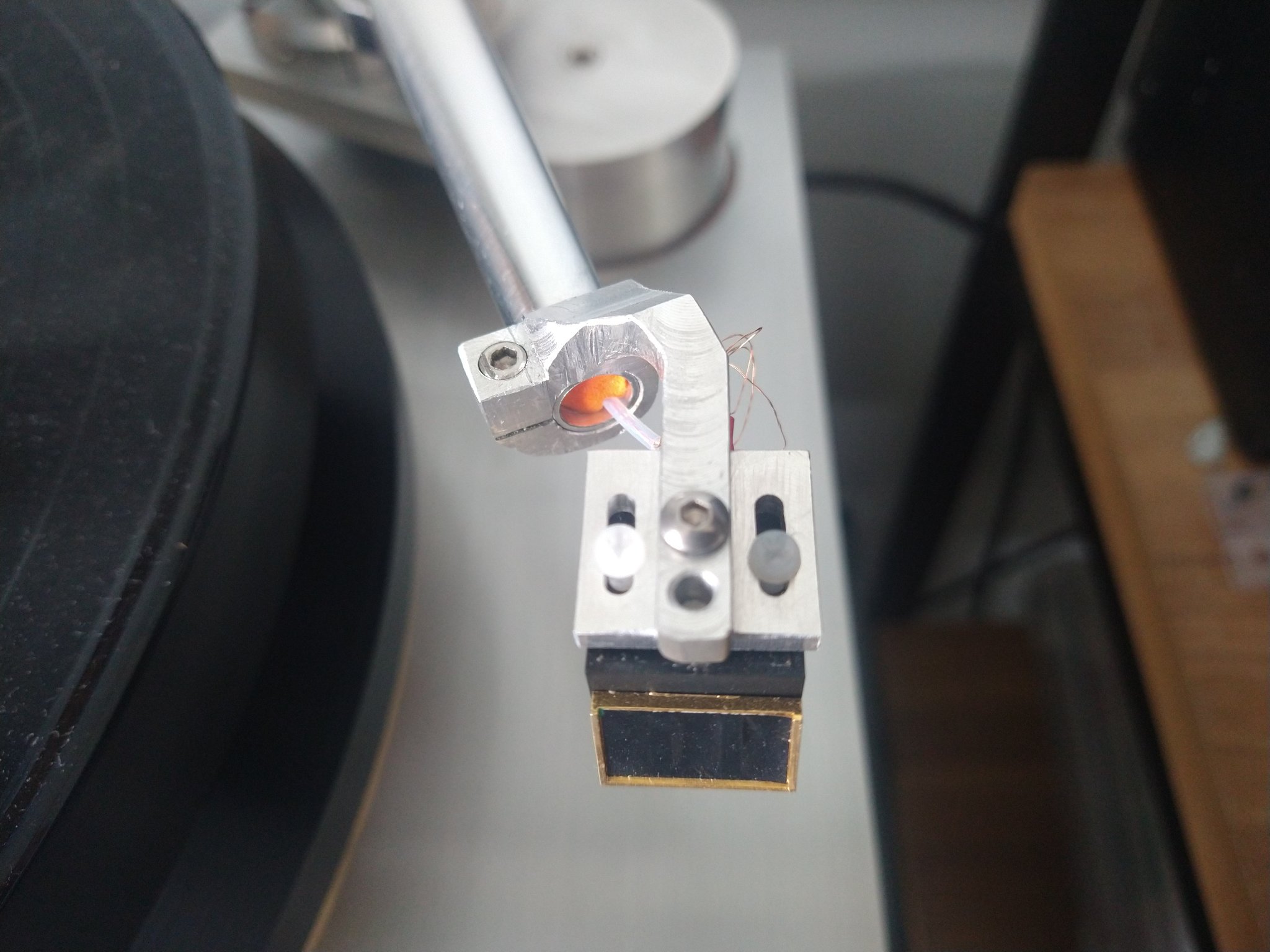

An offset angle head shell with two mounting bolts would be better than having just one bolt.
The headshell mounts to an alumninum plate with two machine screws. Then the aluminum plate mounts to the headshell with one machine screw.
@rayma good point.
My DIY arm used a similar HS arrangement to Audiomods but I slotted the HS plate and had a single bolt hole in the HS carrier, this allowed different cartridges to be setup in plates and swapped without the need to re-align each time.
Yes, but this is the area that should have the highest rigidity.
Between tube and collar, and between shell and cartridge.
Good one. I borrowed heavily from I forget which manufacturer with very similar design but I see your point. V2 here we come !
Frank Schroder was the guy who came up with this style of HS and it's used on a number of Schroder TA's. Remember that the HS/TA will act as a rigid beam only under its resonant frequency, once fr is reached the whole assembly will bend like a wet noodle.
