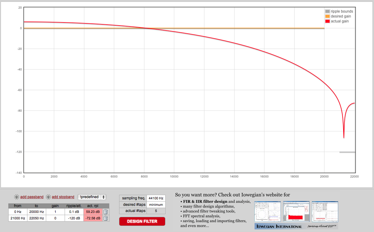

Try to design (e.g. with T-filter) a low pass filter with 0-20kHz passband, with at most 0.1dB pass-band-ripple, and stop band -120dB beginning at 21kHz.
Try to do that with a sample rate of 44kHz and one with 8x44kHz. You will see the usefulness of oversampling 🙂

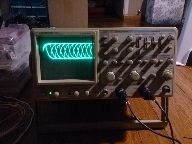

Sorry to go backwards a tad but I'm having trouble getting a lock with my Amanero to the DAM1021.
The amanero is a second hand from someone on this forum and I had difficulty pulling out the pins that was used. I checked and realized the trace for bclk at the pins was broken while removing the old pins - I have since been able to tap it straight from the chip.
Right now, the Data and Bclk lines are at 3.26V... but my fsclk (or LRCK) is only reading 1.63V (even straight out of the chip)... is this normal? I'm asking because this value is the same straight out from the CMOS, but I'm suspecting that this is the cause of my problems getting a lock...

So it's virtually impossible to design something satisfactory at 44.1, but trivial at 44.1x8.
It seems the fact that the stop band is 155400Hz at 44.1x8 rather than 1050Hz at 44.1 allows for a more optimal solution to the filter design.

are you reading with a multimeter or scope?
1.6ish can be a signal
are the other i2s been measured juring playback or not,?
cause I think they read 3.3ish while not playing

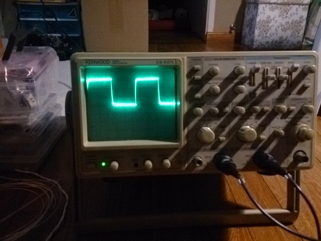

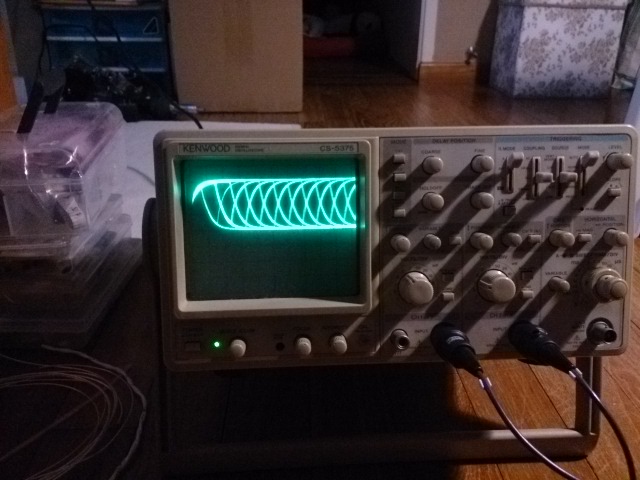

The earlier readings were done with a multimeter. I haven't used a scope in ages but did manage to get some waveforms after fiddling around. Not sure if they help... for some reason (with the exception of FSCLK), I can only get something to show with audio playing.
First image - BCLK
Second image - FSCLK
Third image - DATA
I should probably state how I connected it
Amanero ---> DAM1021
BCLK -> BCLK
FSCLK -> LRCK
DATA -> DAT
3.3V -> ISO 3.3V
Because I was using twisted pairs each of the connections have a connection with ISO GND (don't think this will cause a problem?)

Hi Nige,
You helped me to spot the error. I tapped the wrong pin from the CMOS! Going to try to fix it now and try again.
