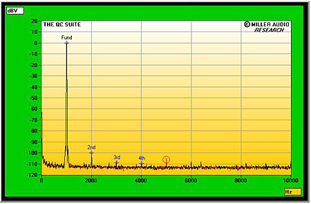

To me your 0dBfs FFT looks anything but clean. It'd be okay if the result was dominated by 2nd and 3rd order, but the presence of the higher orders do bother me. Granted the -60dBfs looks a lot better, but they always tends to. How does the DAC perform at -1dBfs, -3dBfs, -5dBfs and -10dBfs? Also how does the distortion change with frequency?
OK, typically the absolute accuracy of the last few LSB's in an R2R DAC are not very important. Did you think of doing a basic analysis, maybe by Monte Carlo, and have a gradation of resistor tolerances with only a few at .01%. There must be a sweet spot in terms of cost performance. Number 2 have you thought of using some lower bits in an auto cal sequence to smooth some of the higher LSB major carries? The fact that your THD spectrum has a fairly flat amplitude would indicate impulsive errors as the boundaries are crossed.
You're correct on that, and I have actually done some thinking about it, ended up having the resistors for the 14 MSB bits be the best precision ones, with the 13 LSB bits be one grade less precise, like the 0.02% version have 0.05% resistors on the 13 LSB bits, to keep cost down but still having great performance when using the digital volume control. Could in principle use less and less precise parts going down on the bits, but it's again a question about not having too many different almost alike parts. Give an EMS provider an opportunity to mess up and they will take it....
The prototypes have 0.05% ones on the 14 MSB bits, with 0.1% ones on the 13 LSB bits.
And I really should do some Monte Carlo analysis, but as I'm not a serious math guy I'm just using gut feeling as guide for now 🙂

I'm perfectly happy with each harmonic being around -100 db down on the prototype with 0.05% resistors.... And most DAC's actually look worse at -60 db than at -1 db.
The DAC is FAST, I have 200 nS rise/fall time when doing 10 Khz square waves with output filter removed. So the linearity over frequency I expect to be great, although I haven't measured it yet, mostly because of measuring equipment limitations....
But that's actually the principle itself, the R-2R dac is only monotonic to the precision of the R-2R network, the tiny errors show up as what you could call "higher harmonic noise". The advantage of the sign magnitude DAC is then that the harmonics does down with the signal level, unlike a regular R-2R DAC.
I'd be happy with the 2nd and 3rd harmonic lying at -100dB, and then for the level to decline with rising order, but not with you're getting. This is why I was asking what -1dB, -3dB etc look like. Clearly the harmonics go by the time you get to -60, but how far down to you have to go for them to go? All harmonics lying at -100dB isn't a problem imo at 0dBfs, if most of them fall off the chart when the input level falls a little.
Most good DACs tend to show nothing but noise with a -60dB signal.
That's how it works with sign magnitude R-2R DAC, the errors due to the DAC being not monotonic at some level shows up as random harmonics and follow the level down. With the 0.05% resistors I was expecting higher levels harmonics, so I'm very happy with what I see on the FFT's, even as I don't trust my EMU-0404 much.
If you want it better, get the one with more precise resistors.
If you still don't like it, get a delta sigma DAC, we all agree that they measure much better.
In the end it all comes down to listening tests, not measurements, but I'm not there yet.

Here's an FFT from a CD player with the PCM1704K, it appears to measure superbly. No doubt it's internal resistors are trimmed to very tight tolerances, but is this the kind of performance gain that you would expect to see by using 0.01% resistors?
If you do not know the extent of how your sound card performs then you can run a loop back test, at the very least, to get an idea. Lots of ADCs in sound cards actually perform better if you feed them a signal that's a couple of dBs below their maximum amplitude.
I have done loopback, with varying results depending on settings, and my EMU-0404 have that spike at 30 Khz some claim is due to it's switching power supply.
It looks like the pcm1704 have the same kind of harmonics, just 110 db down and covered by noise.... My DAC has way less noise so it looks worse.
If theory, going from 0.05% to 0.01% should improve by 14 db, but I have no clue how much better the resistors are in practice until I have a board with 0.01% parts. Which I have decided make a few of in the first batch so I can get more data, just purchased 2 x 1000 pcs 0.01% parts from Digikey....
