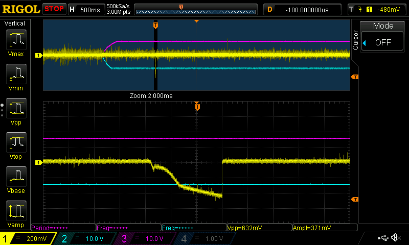

2) There are loud noises at power on and especially at power off. Since this device contains volume adjustment, it is expected to be useable by connecting it directly to power amps. It is probably going to result in some damaged speakers.
During power on there is quite a loud pop. The magenta and cyan channels in the screenshot below show positive and negative power input rails. There is approximately 500mV spike about 1 second after power is turned on.
attachment.php

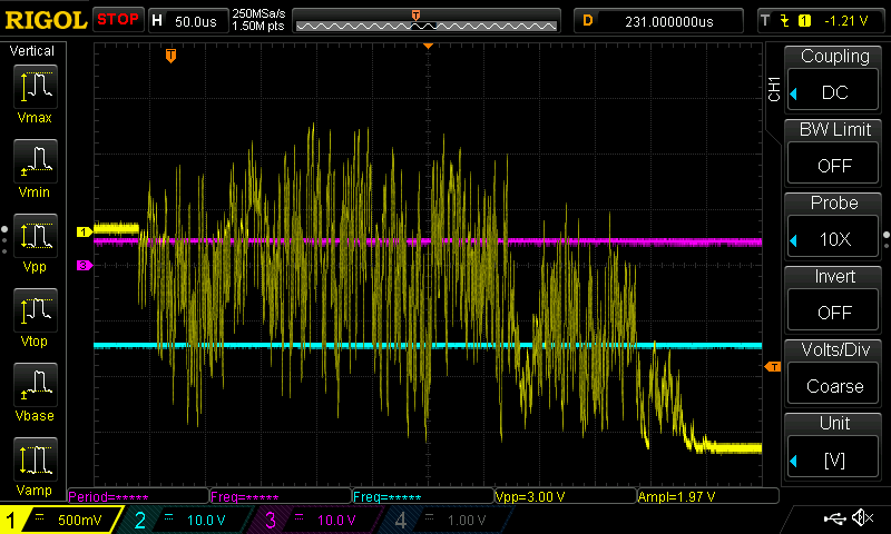

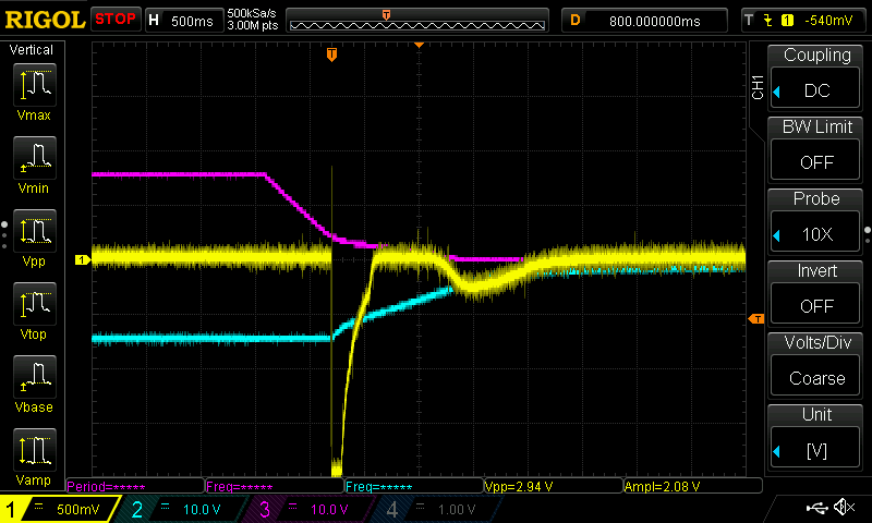

At power off the noise is not just a pop, it is a huge KABOOM! Because the current draw on positive and negative rails is different, the positive rail drops much quicker than the negative one. At some point the device is practically powered only by negative rail voltage. There is a sharp spike at the output, after which it goes to -2V for awhile. This is potentially a speaker killer. 🙁
attachment.php
Zooming in on that spike shows some nasty noise.
attachment.php
The power off noise may be made worse by my use of regulated power supply. It has additional capacitors and probably the voltage drop is slower and therefore the spike is longer.

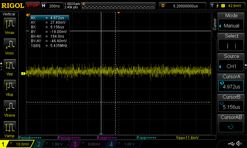

And lastly an observation on noise coupling through the isolated I2S connections. I was checking the DAC outputs with a scope to see if there is any high frequency noise present. There is no noise from the DAC itself, but there is some high requency noise at the outputs of the DAC when USB is powered on.
Here is output noise with USB hub powered off. It is pretty much the noise of the scope itself.
attachment.php

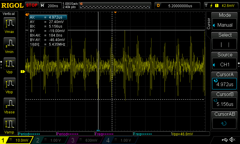

And here is output noise when USB is powered on:
attachment.php
This noise is present regardless of whether the dac itself is powered on or off. It shows that even though the isolators do break ground loops, some HF noise will get through. Don't know if it has a noticeable effect on sound quality, just something to think about.

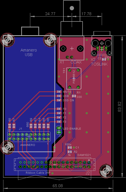

I have drawn up a version of an input board for Amanero, BNC Coax and TOSLINK inputs, but am now rethinking that TOSLINK should be powered from a separate supply. Maybe I will also add provisions for putting small inductors or ferrite beads on I2S lines from Amanero - just to see if that HF noise can be reduced without completely destroying the signal shape. On a non-reclocking DAC it would be a no-no, but FIFO reclocker should be fairly tolerant of such a thing.
The input board uses a 34 pin ribbon connector, of which 26 pins would be connected to J3 , two pins for tapping into 1.2V, and 6 wires going to front panel for input selection and volume control.
attachment.php

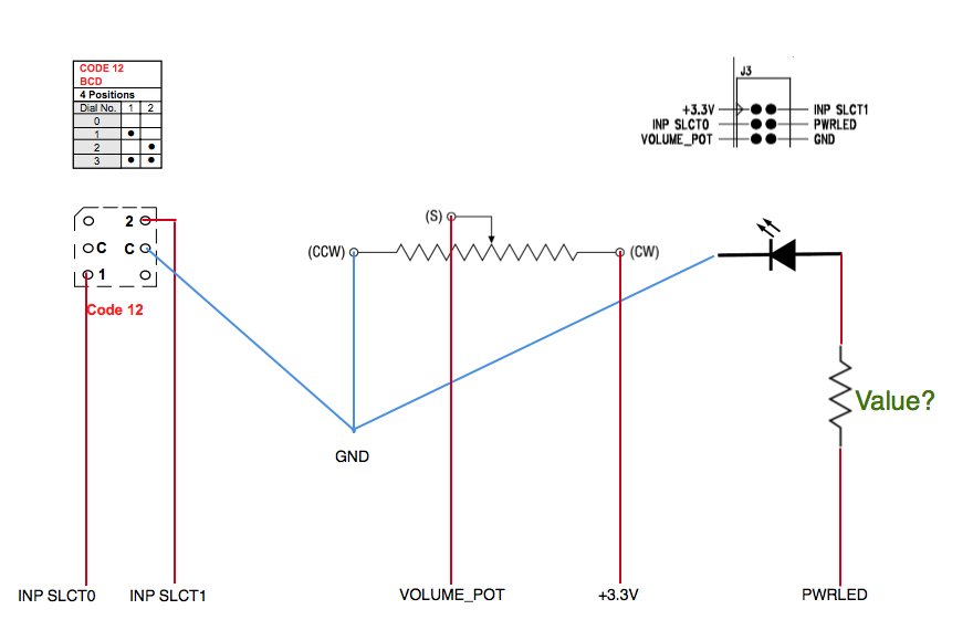

There are mechanical 2^n-pos switches which code their position binary, see e.g.
http://www.mouser.com/ds/2/26/Apem_PT65 series-372370.pdf
These could be connected to INP_SLCT 0/1 and GND of J3 for mechanical input switching.
It should be Code 12 BCD version then.
We need more ground pins 🙂
Prepared a front panel diagram using common ground connection that could be implemented on a breadboard. Does it look correct? What about the value of LED resistor?
