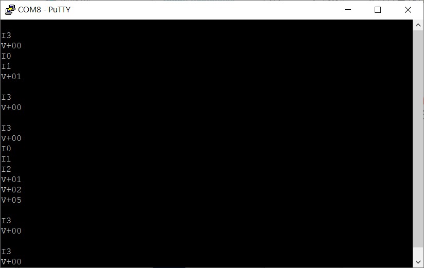

Dear soekris,
I replace the STM32F030K6T6 and upload the firmware of "dam1021_uc_20150118.bin" today. The image shows the message received from RS232 on dam1021. There are no Rx.xx when startup and I can't type "+++" to uManager for update firmware. Whether I need upload other released version or not?

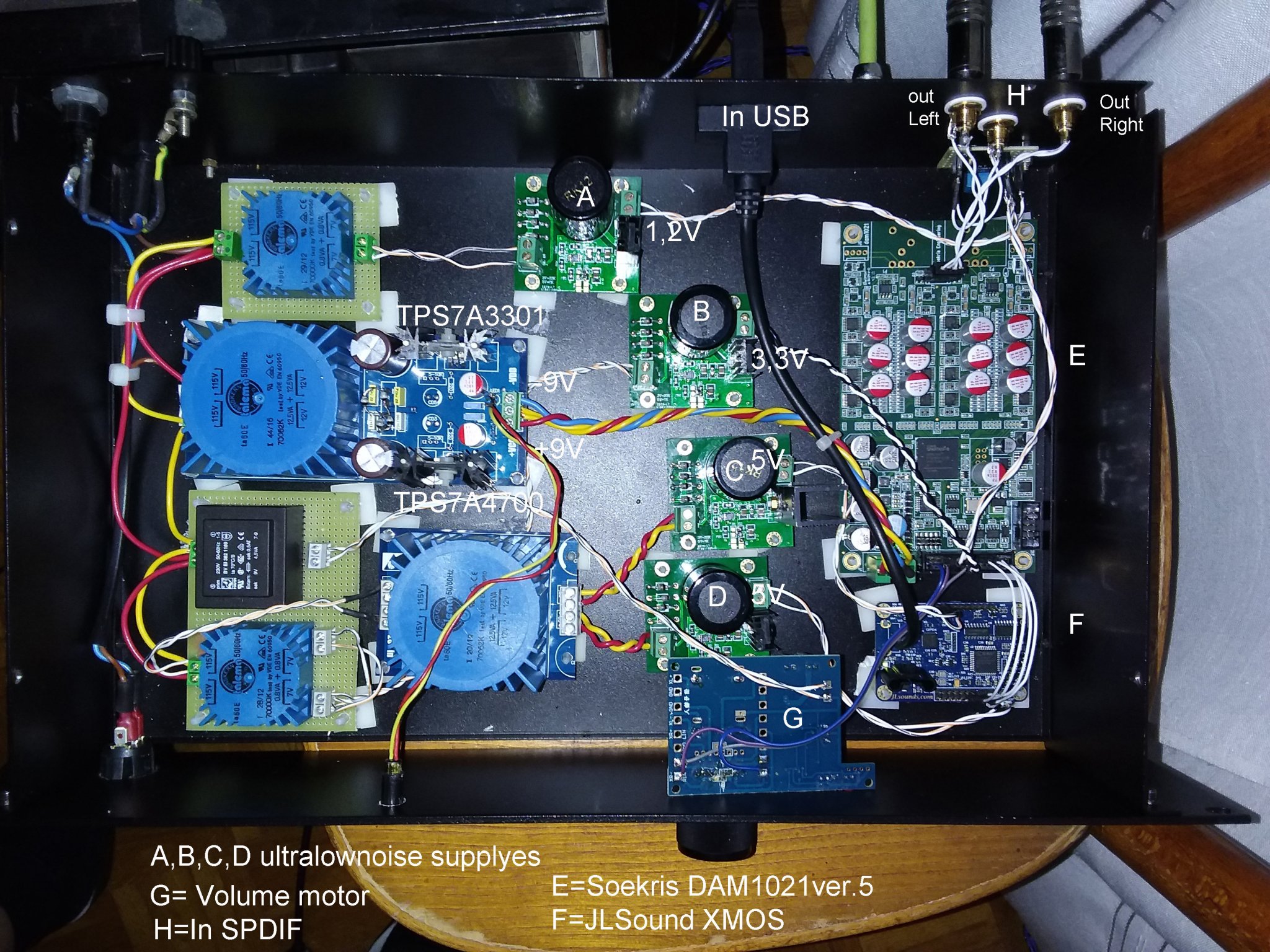

Let's see if anyone can help me. My Dac based on Dam1021 ver.5, connected with a JLSound I2SoverUSB v.III to an android smartphone with USB Player Pro, worked fine for several months, until I decided to buy a Dam1021 ver. 7, replacing it in all respects with ver. 5. Convinced that I had made a contact error, I sent it to Soren for repair, but Soren then wrote me that it worked for him and that he would then return it to me. In the meantime, in order to continue listening to music, I had reassembled Dam1021 ver.5 and, when ver.7 arrived again, I reassembled it, checking step-by-step, together with a friend, that the connections were identical to those of ver. 5. Nothing to do: connected the smartphone (I use USB player pro with Tidal) a loud noise is heard on the two channels, superimposed on a weak musical signal, which is completely silenced by pausing the signal.
What to do?
